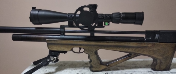

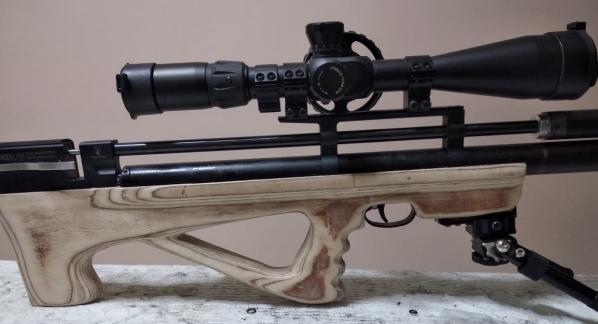

I really like how you moved the trigger forward and reduced the OAL a bit. I didn't notice this until you called it out---I just knew it looked much improved over the original.
This gives me an idea----OAL could be reduced a bit more as well as improving the cheek weld by making the butt more like an Edgun R5.

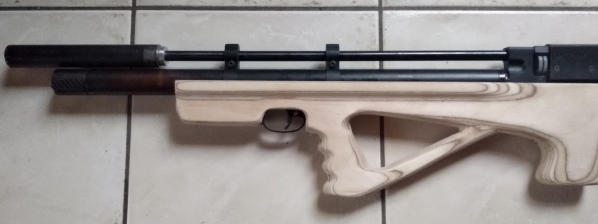

BTW---I am in the process of making P15 trigger linkage by using to RC model airplane servo linkage components. You can get parts to make whatever length and configuration you desire.
It's funny you mentioned that.. I'm BIG into RC and used to build a lot of aerial platforms.. I'm BIG into bulpups too, so, using RC model-parts was a no-brainer..
Nice Thinking!
I've been kicking the idea around of taking things a bit further, and using an electric actuator setup for an electric push-button-trigger.. [For a micro/mini bullpup design that I've been planning of for a while]
