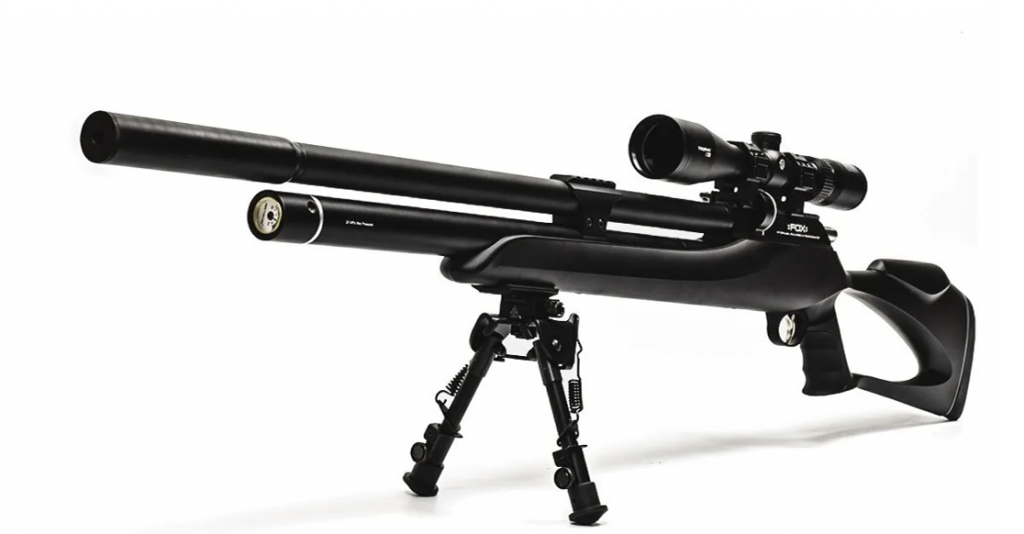

I would actually argue that Snowpeak has spent more time on QC and R&D recently, as they have shown on the PP750 and their new to market semi auto M40 and M50 , as well as a refined and upgraded verson of the M11/ M22 called the M25...See below ....If I was you I would wait a bit for the new P35 (Mid Cocking P15) :)
