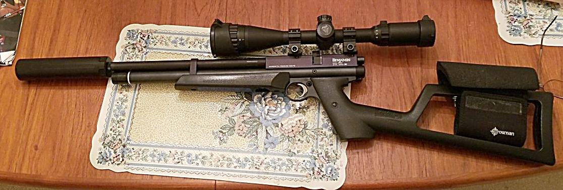

@damienblack ,
My fill pressures go from about 3200 down to 2600 if I recall correctly and I shoot the jsb 18 gr with Krytech bike chain lube. The bell curve peaks out at around 705 FPS.
Use either a Donny FL sumo or Tanto and all I can hear is the action and the pellet impact. One drawback is I have to take the moderator off to fill the reservoir but it spins off and on quickly.
