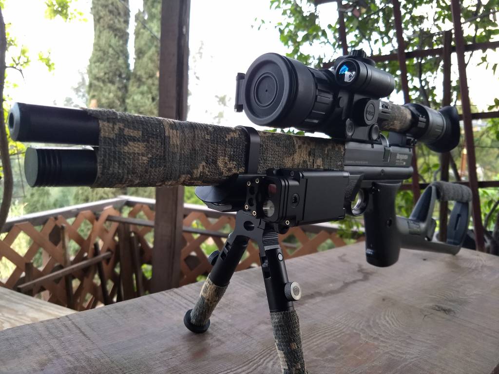

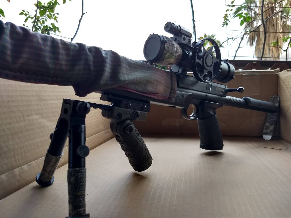

Here is one way to do it.
https://www.airgunnation.com/topic/simple-benjamin-prod-bipod-sling-attachment/
You can also just use these or similar with just machine screws and nuts and washers. Or drill your forearm screw hole larger and drill and tap your barrel band screw hole larger as well. Lots of ways to do these things and most are not too difficult.
