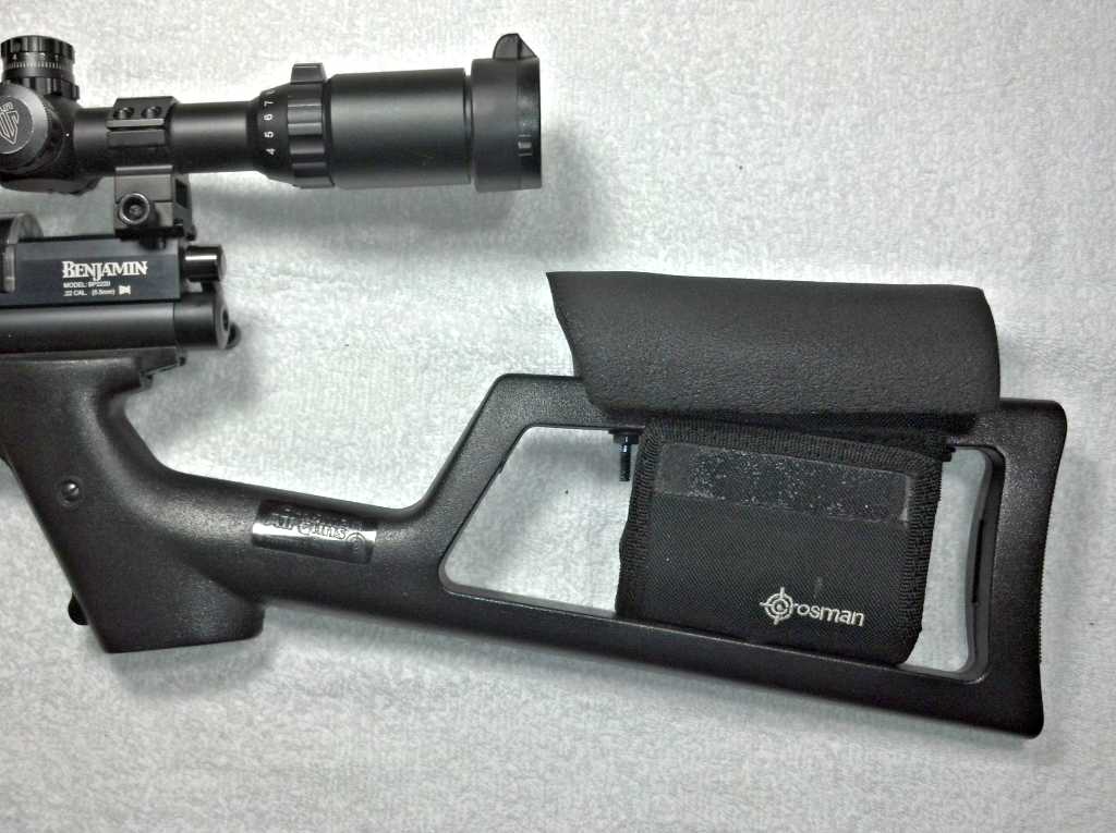

The two most useful mods I did were to add a cheek rest to the stock and polishing the barrel.
For my barrel work, I brushed the bore with a bronze brush and JB bore paste for 20-30 complete passes. I would probably make 100 passes if I were to do it again, then pull patches through with Flitz polishing compound. I noticed some resistance when cycling the bolt and pushing pellets into the breech, si I wanted to ease the pellet entry a bit. I used a tapered cone Dremel stone bit in the cordless drill at slow speed to chamfer the breech a little (with the breech oring temporarily removed!). Then I chucked the muzzle end of the barrel into the drill and pushed the breech end into the corner of a Cratex polishing block to polish it with a couple of drops of oil. This works well - Cratex blocks are kind of like thin rectangular erasers with polishing grit embedded in them. I flipped the barrel around and polished the crown to a mirror finish the same way.

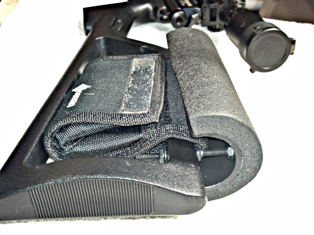

See the attached pics for the cheek rest mod. I sawed a piece of pvc pipe in half, glued on a piece of neoprene pipe insulation, and mounted it using two long #10 machine screws and extra nuts. This allows you to adjust the heigh for best eye position through the scope. This was also a perfect place for a Crosman pellet pouch, which has a velcro belt loop closure. The weight of the pellets geive the pistol very good balance, pretty much centered on the wrist.

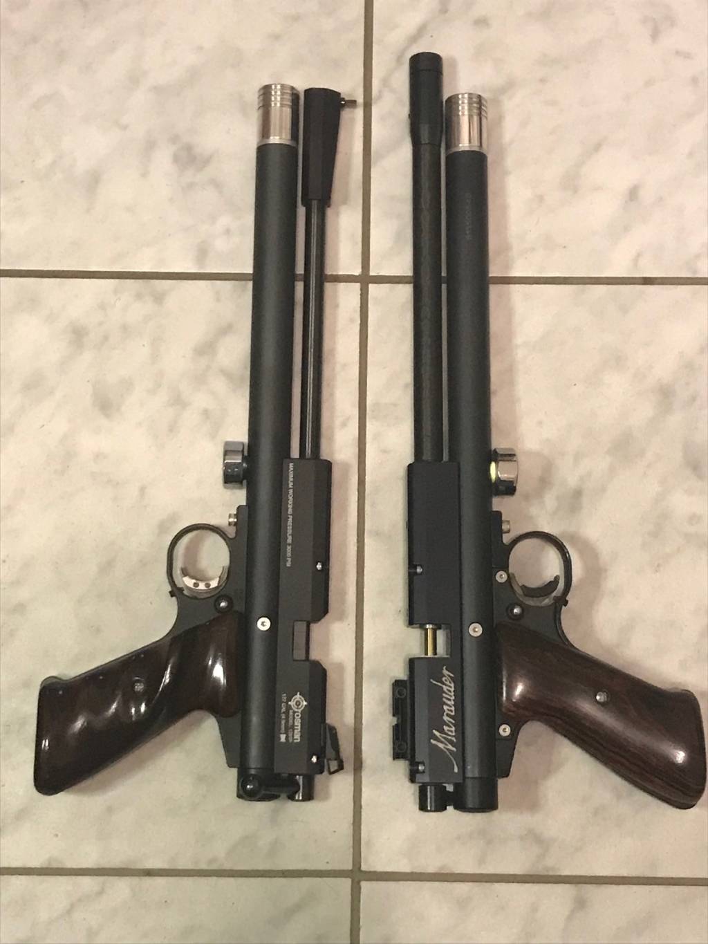

Congrats! First thing i suggest is make good notes of the currrent hammer spring and striker settings. That way you can return the gun to near its original tune, i say near because Hammer adjustments can shift and springs can weaken over time. A chrony is your best friend. I have a few p-rods, some modded to the hilt but the stock one gets the most trigger time ironically and does sit at about a 3 mag tune. They can be tame little plinkers or a beast, depends what you want. For air saving look into the B-Staley o-ring mod, works great, super cheap and saves air but wont be at the top of the power curve. Still need a chrony though to tune. For my pcp journey there was way more value from buying a chrony before a compressor. Some other cheaper mods are a striker change or a shorter hammer spring. Hillairgun.com is my goto for those parts. Buck-rail.com makes a cheap but well made ergonomic forgrip with a pic rail, makes a big difference in grip and supporting off-hand. Trigger can be shoed too, adding a nice feel. Hand pumping did me well for the beginning and will again when shtf. I ended up shooting and tuning alot more and moved to a Nomad style compressor, works great for filling guns directly, still putters along after a few years, but not designed for serviceability or tank fills like others. I now shoot more than the compressor can support, so tanks are in the mix now, but carbon fiber is $$$ and the compressor still tags along on hunts, as does the pump as a backup. If you can get tanks filled, a used recert 3k psi tank from a scuba shop might be a future consideration for a lower cost. You can top off the gun to 2800 and tether when near there. I think it all comes down to your purpose, both gun and air. Hand pump may be just fine for your shooting frequency/volume and just keep filters and orings on hand and add a compressor for convenience when you can. If i were in your boots, would find a chrony first, learn that gun inside and out, as it is, and get the most suitable and efficient tune you can out of it with whatever pellets you are using, then add a compressor or tanks. Fortunately you have a very well documented pistol that has parts galore had all mods and problems virtually exhausted and solved over the years ( precisely why i have so many marauders) so any issues or tips are readily solved or found. Just my 2cents. Happy shooting!

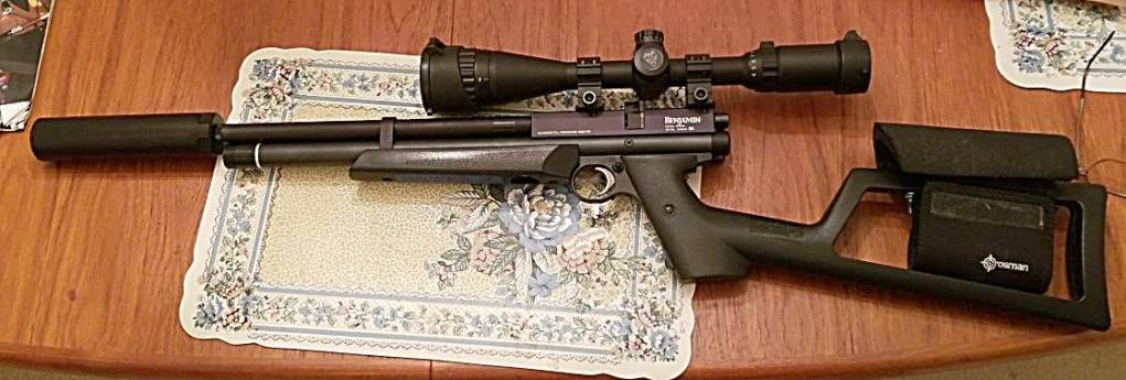

I initially attached a small piece of a 2x4 to raise the comb. But I now have a butt stock made of a piece of aluminum tube with a 5/16 fine thread bolt in one end to screw to the gun and a 1/4 t-nut in the other end to attach a butt plate. I put a piece of PVC tubing over the aluminum tube to raise it slightly and make it more comfortable when cold. It is lighter than the stock my gun came with and works very well.

I have one i keep regulated, but shot count suffers, all depends on your settings how many you will get. Reg’d does make it a different gun, but not necessarily better. I had set out to make a specific p-rod build for FT ( ~20fpe) At the time its all i had to shoot FT with so I wanted it as consistent as possible. It pushes GTO’s 875 for ~7 shots, <1 ES. Ports are bored out, Hill parts kit, prototype hammer ( all i can say is, its blue), #7 valve spring. LW barrel wrapped and bonded w carbon fiber cloth, shimmed PEEK striker. Huma reg is set around 120 i think, have to look at my notes, i know the hs is 1.3 turns in and the gauge was removed for headspace. Its fun, shoots almost lights out all the way to the 50 yd targets but filling up every lane was a pain. I regulated another one for a bit, that was set about 100bar, Hill hammer and springs, stock striker, had a consistent and solid 2 mag tune from it with the gauge block. That one’s the operating table now getting a cf bottle. Besides the FT build, im not regulating any more in tube. I say that, but this is airgunning. For most of my purposes with the other p-rods, some o-rings, springs and tuning worked perfectly enough and with better shot counts.

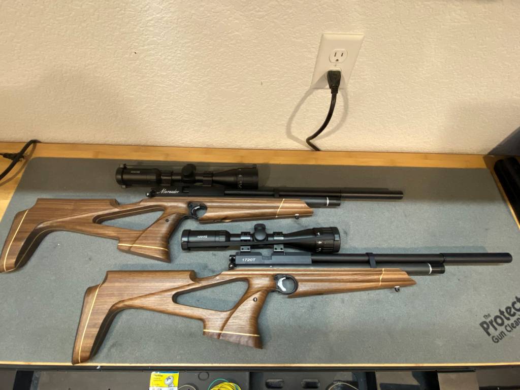

I think I opened a can of worms buying this gun! Originally I wanted a pistol but now having shot it with the stock I'm starting to lean toward the carbine set up. It feels a little front heavy as a pistol, I think the 2240 will be filling that niche from now on. That's a great idea with the pipe and foam Feinwerk. I have those parts laying around in the garage right now. I was shooting last night thinking a little more something to snug up against would be good. That's some beautiful woodwork MileHighAirGunner. I always prefer wood over plastic and have made wood grips for all my airguns. I really appreciate all the information guys, I'm on my own with this little obsession since none of my friends or family are into air gunning. A chronograph will be the next item to buy. I can see the wisdom in knowing how the gun reacts to changes in pellets and tune. I have yet to go into the gun, anyone have an exploded diagram and parts list link?
@LeadandAirFun I could never take any credit for Tom West's work. On a good day I have the woodworking skills of a rabid beaver.

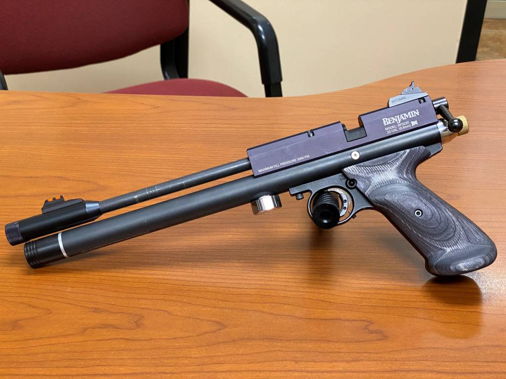

The Prod (and 1720T) are way too big for what I consider to be a proper pistol. I like the Crosman 1701P as a pistol. It's still large by pistol standards but much better balanced. It's not very powerful but does what it's meant to do well. The 1701P isn't as easily modified for more power as the Prod and I wanted a .22 caliber repeater pistol so I married the two together. It's got a SST in it in this picture but the iron sights are usable even with the magazine. She barks like a p!ssed off Rottweiler though and definitely not backyard friendly without the TKO moderator I use with it. The TKO is very light so doesn't weight the muzzle down and doesn't throw the balance off and it's small enough in diameter I can use iron sights ,which is my preferred way to use a pistol.
