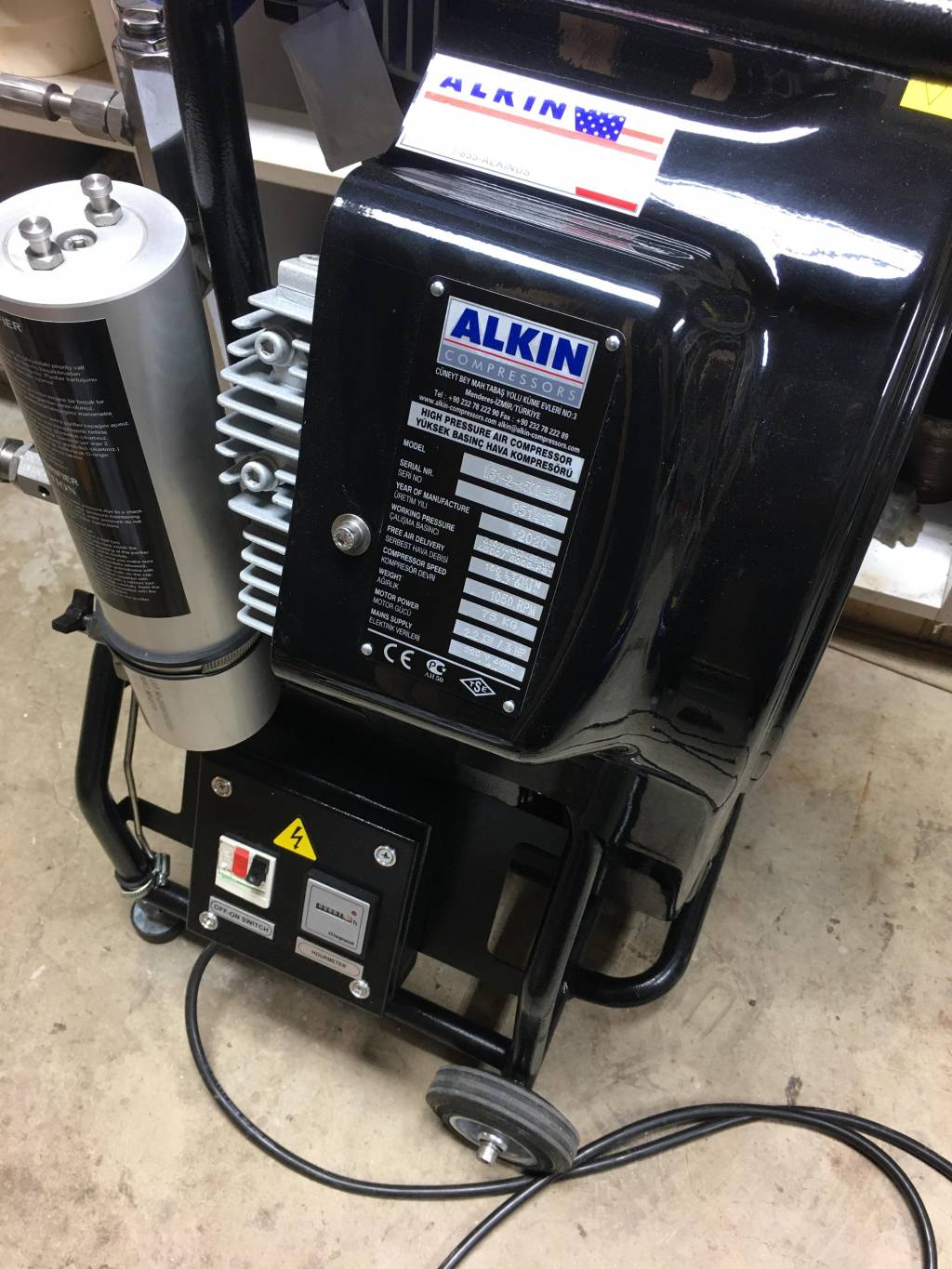

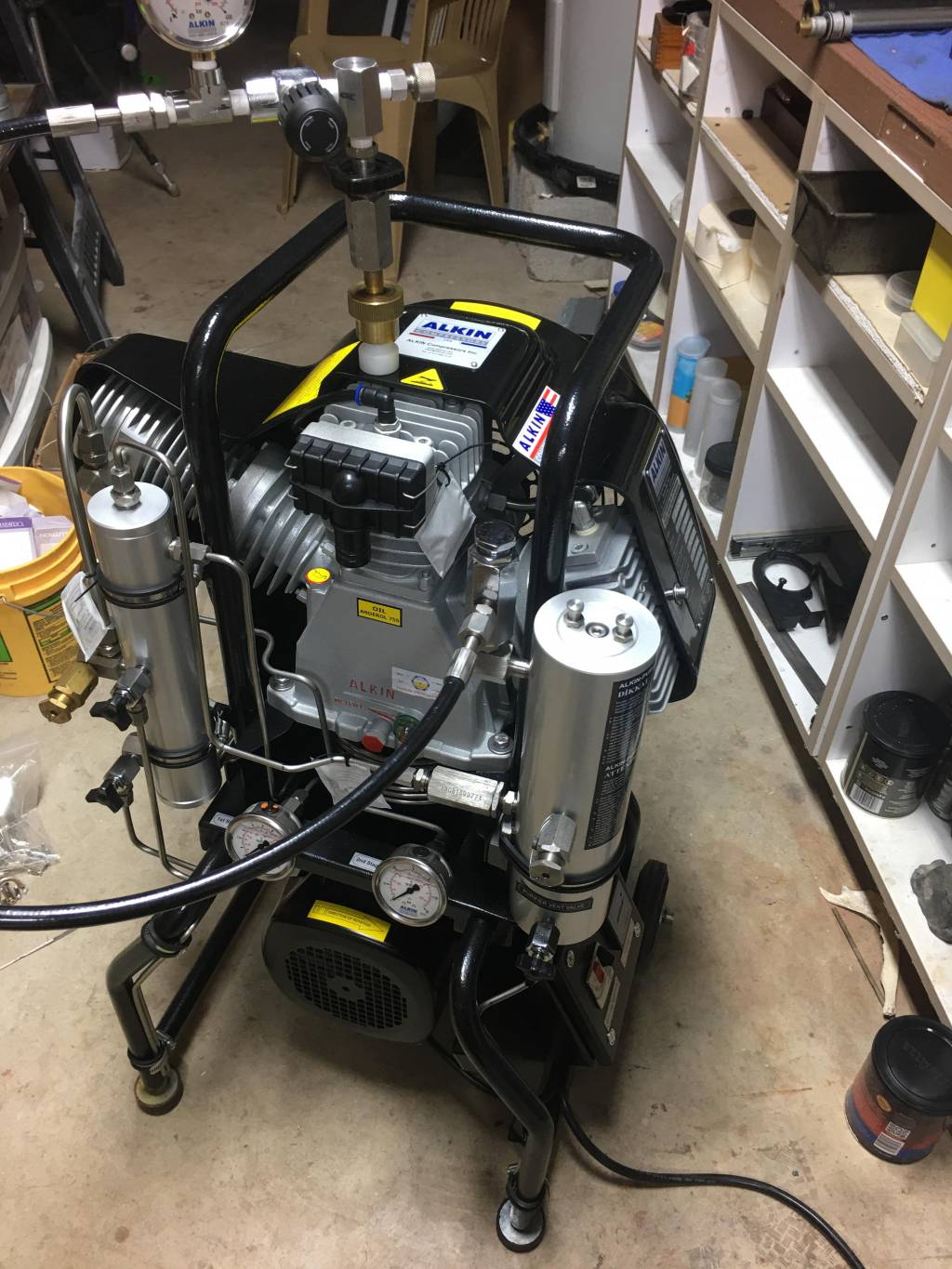

Buy a used Bauer on ebay
Agreed. Buy a top of the line compressor if you plan on staying in AG's or ever shooting slugs long range. 15+ years & I finally got a good compressor. I'll never put anything but E grade breathing air in any PCP. I'll never buy a used PCP that was subjected to hand pumped or inferior air. Not if we're talking $1K+ airguns.
Alkin, Bauer, Eagle, Mako, Sauer, etc.
It doesn't make sense to spend $1800-$3500 or more on a PCP & fill it with anything else.
I'm not with Alkin or selling mine. Just my honest opinion on the subject.

Suggesting the Alkin to someone who states that "$700" is a lot? OK.
LOL. I agree but having done this three or four times and every which way its pretty hard to sugar coat the reality. I had a daystate 110 and a nitrogen set up and finally bought the ALKIN. LOTS of guys use the YH compressors with great success and I am offering no criticism but I question three things about them. 1st how long will they last 2nd is the air produced truly dry and clean 3rd do you really not mind dealing with water cooling and the time required to fill your tank. The used Bauer is fine IF? you can find one and have a source for service. My understanding is the air dryers frequently need service and it’s not cheap. So here is my suggestion buy the Alkin if you can. If not buy the HY and set it up correctly. There is a TON of information on the forum. I know most can not manage the Alkin or even need it but I can tell you it’s REALLY nice. My advice is don’t spend $1000 or $1500 as I did first . If you are going to dive in go to the deep end of the pool .
