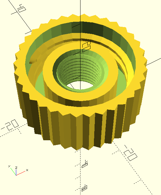

Something like this? 1/2 UNF to Soda Bottle Cap
