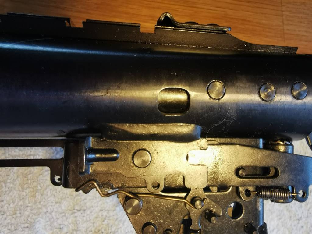

I just got my brand new 130 Vortex QE .22, my first gas ram by the way.
It needed filling so I took my scuba tank, put in the probe, opened the valve slowly slowly, nothing happened at first,
I guess resistance in the non return valve then -bam north of 250 bar, /3600psi probably ~280bar/4000psi as the
scuba tank was recently filled.
The gas piston is in the cylinder, that's probably why it didn't explode.
Any idea to release the air ? I don't have the screw on the other to release the pressure. It would be suicide to
try to take apart.
In retrospect I should have used the compressor instead, to slowly build pressure, what's done is done.

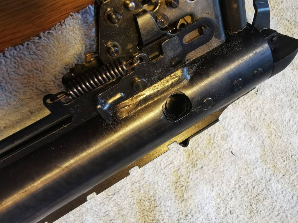

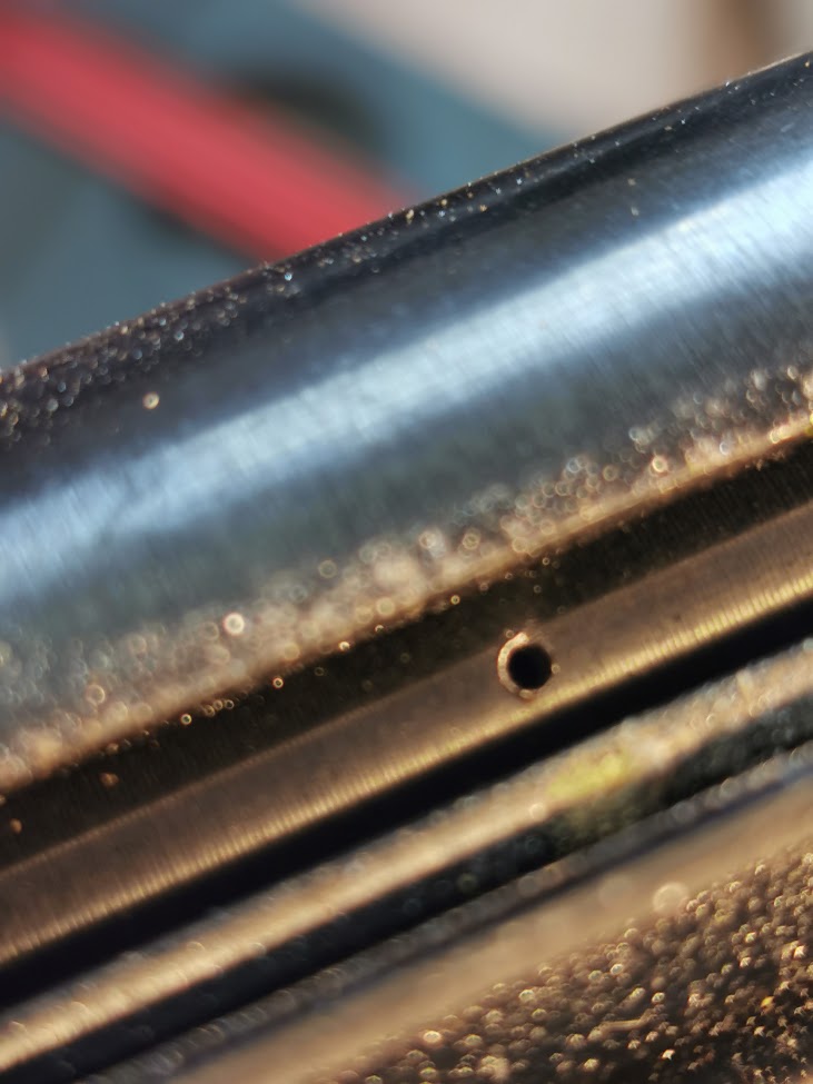

Sorry, no. I tried, with long Hex key and a vice, I even had to dremel the cylinder some to get the fill probe in. Probably even more stuck now with an additional 250 bar in it.

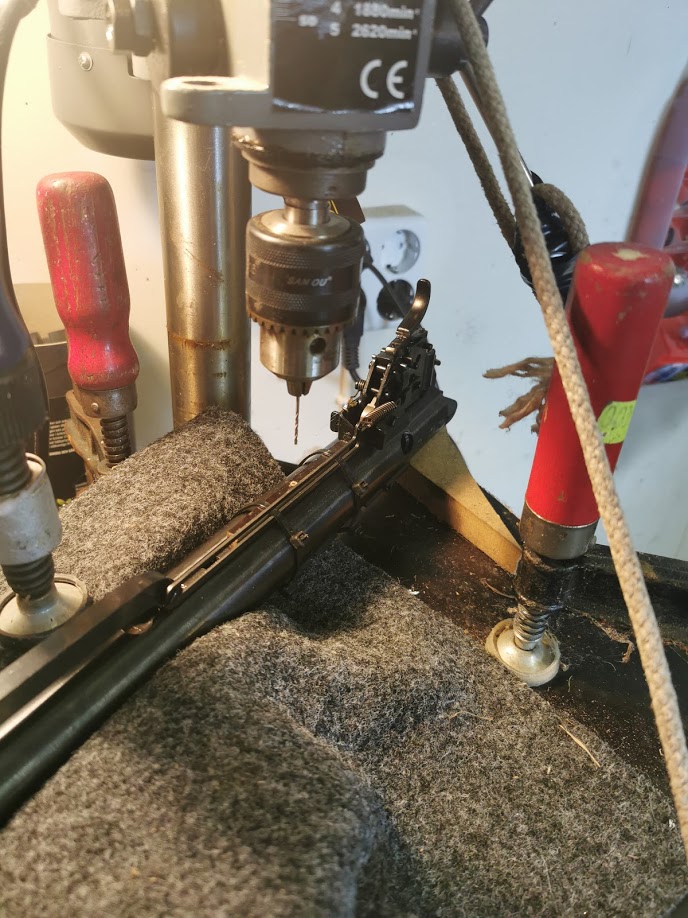

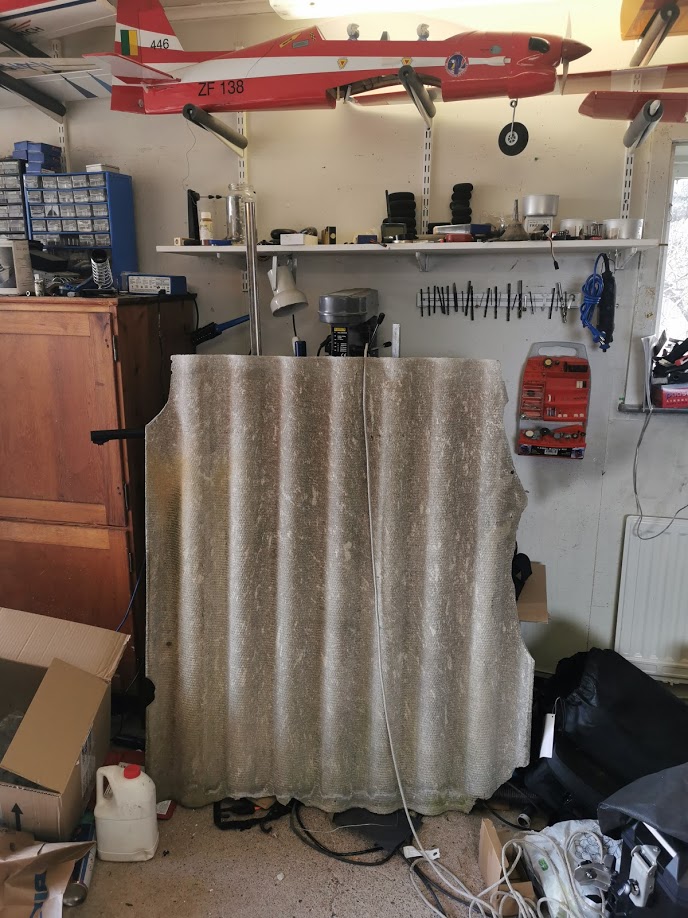

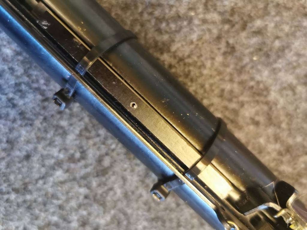

Following the same procedure as "mikeyb".
A drill guide for the drill, an impact resistant screen, 3m rope, and I had my motorcycle helmet on.
I rigged everything up this morning, but kept putting it off, quite a bit nervous.
I finally gave it a go .... As mikeyb said - what an anticlimax, just a slow hiss, hard to tell if it was the air releasing or something rubbing, hard to tell over the motor of the drill press.
Hope this helps if anyone gets into the same situation. But, remember you have to know what you are doing, a common garage compressor tank is 8 bar, this is 280 bar.
