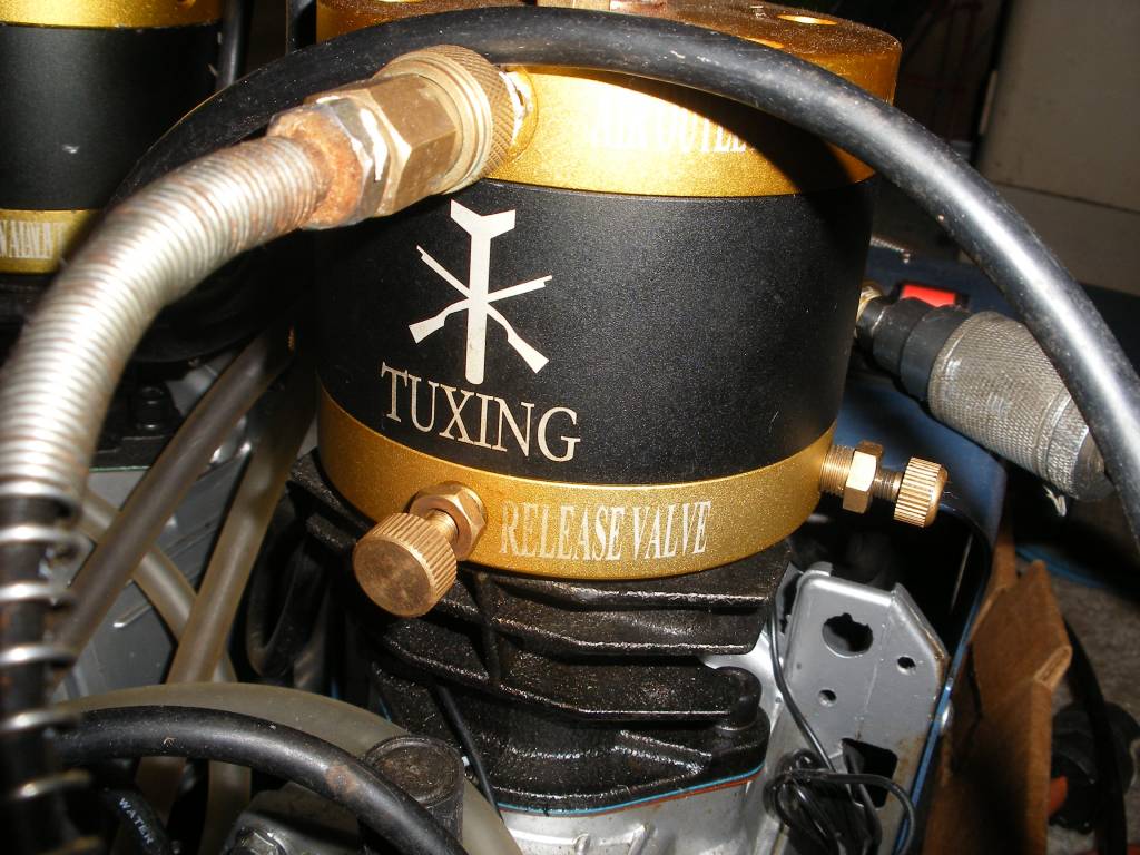

Most of the down fall on the little compressors is auto shut off" when those little guys, are up to 3500psi and are shut off,thats one hell of a blow between the crank and piston rod"i no its cool to have the auto shut off but that's one hell of a strain."when ya bleed both vales as the motor runs no stress.💀
