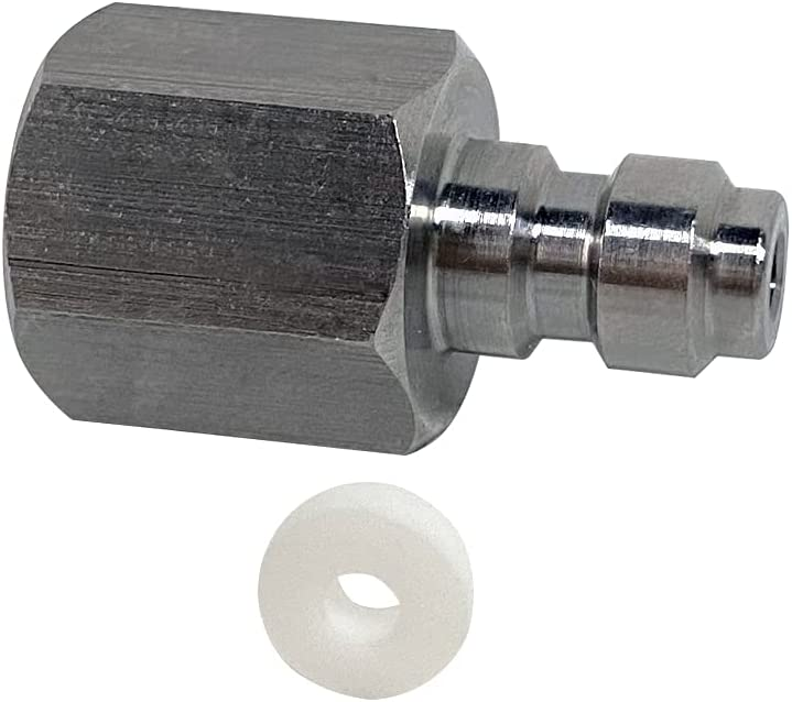

Have you ever experienced an over compressed white (Teflon?) washer that looks like the one in this photo? I purchased a quick connect line that had that type of washer between the quick connect end and the micro bore hose end, that had been over tightened to the point that the tiny hole in the middle was completely closed, effectively blocking any air from going through the line. I didn't have any spares on hand so I drilled it out with a number drill to match the hole found in functioning hoses and it seems to be holding fine at 4500 psi.
Also, I would like to buy several for future use, but my searching skills are coming up empty. What is it called or where I can I find a bag of them for a reasonable price?

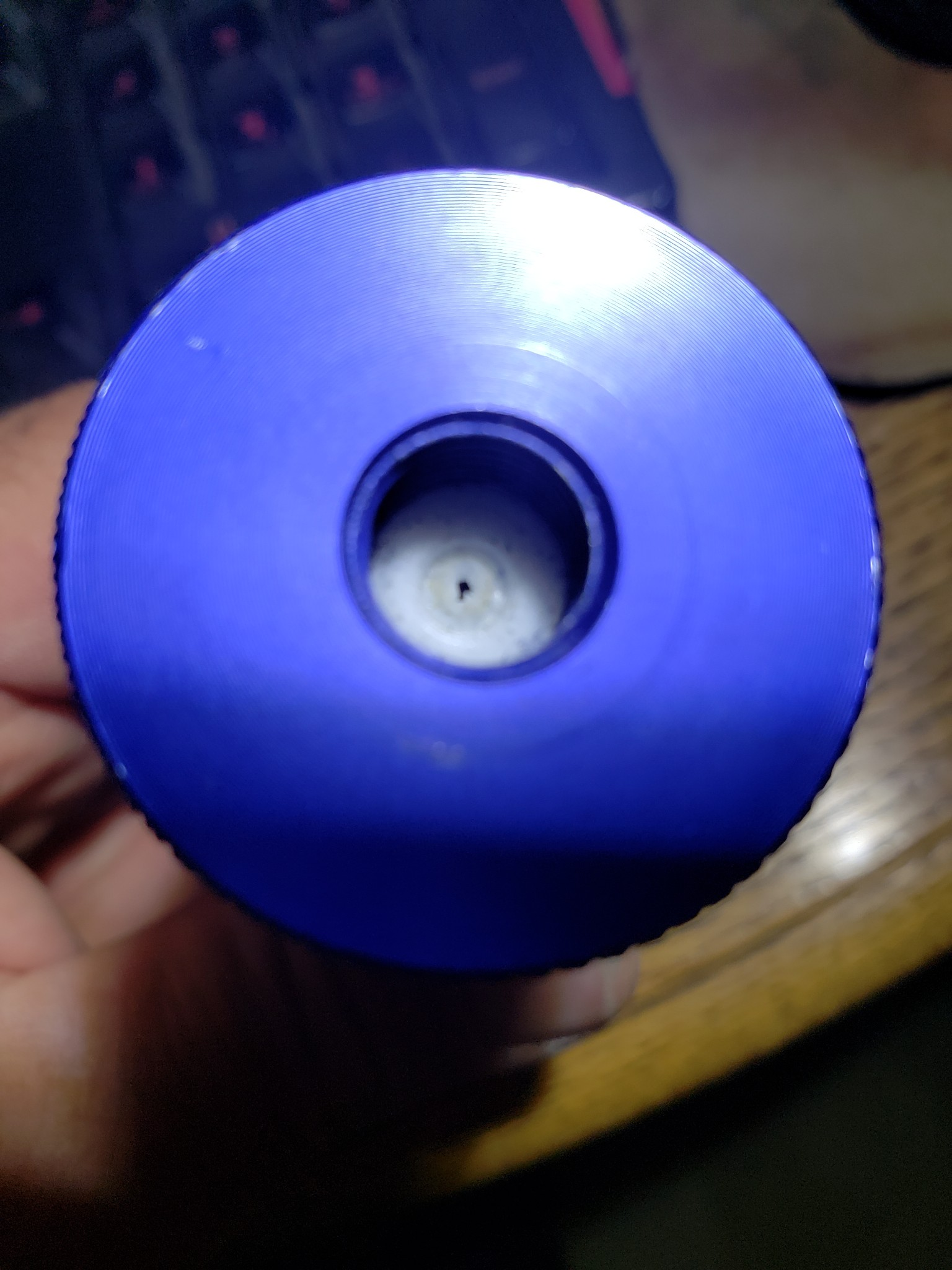

I can say that I was not the Gorilla with the wrench. The hoses with constrictions all came that way from the "factory" with the inner washer crushed. With the worst blocked one that was on the newest hose introduced to the system, the gauge on the tank was increasing extremely slow, but the one on the compressor was increasing fast, which told me something was blocked. So, after fixing that worst one, and seeing air finally flowing into the tank at a reasonable rate, I checked every "factory" hose connection and found that all but 2 of 6 hoses had the washers on both ends crushed to the point of seriously constricting the air flow. The photo at the end looks like most of them. I didn't get a photo of the worst one that started the quest.
With them all drilled out, the fill rate on my 60min Scott SCBA increased about 3x vs the rate of fill with just the worst one fixed.

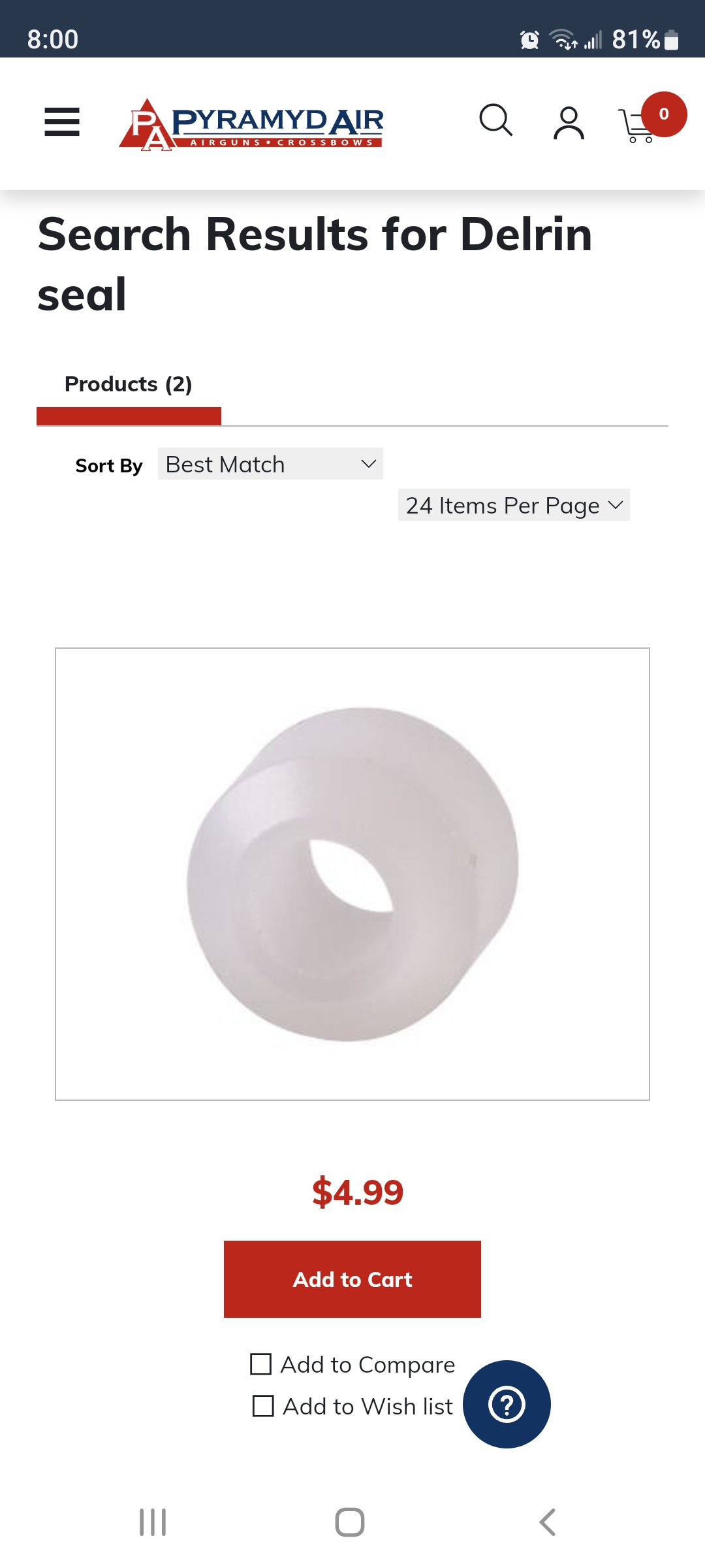

SS, Thanks for that link - great price - sure beats $4 each. I am going to get the PTFE and some nylon washers to try. I have other uses for those PTFE washers. It looks like my original guess was right - they are made of Teflon but the sellers don't use the trademark name, rather the generic one.

Here is a photo showing the average size of the hole in the middle of the PTFE washers. No visible hole could be seen with the worst one. Thanks again to everyone who has helped me on this.
