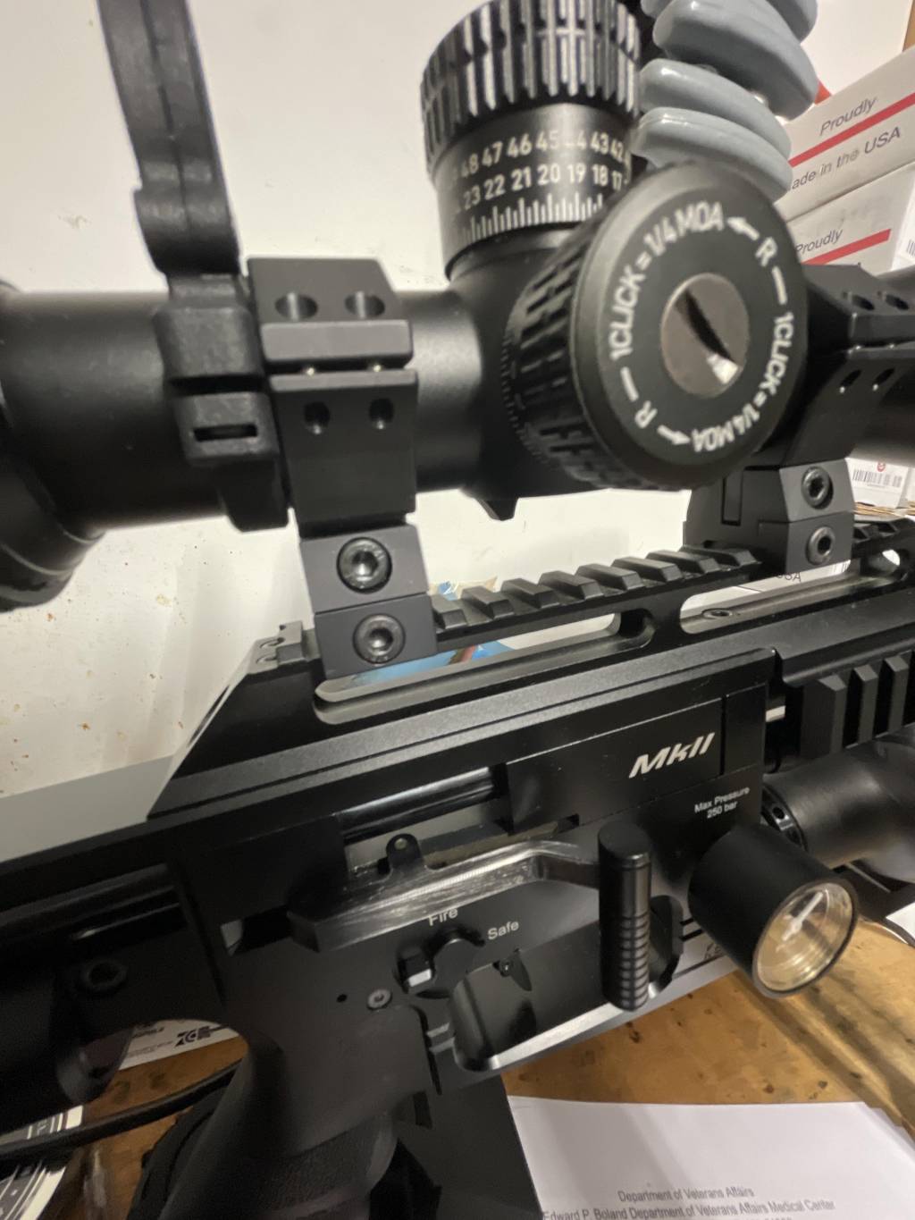

I bought adjustable scope rings that give more control. I dial the turret all the way down and then add about 25 to 30 clicks up. Then I have a solid and stable bench where I fire a shot and instead of using the turrets I adjust the scope by gently moving up or down and then tighten it down when the reticle is just below the poi.
At that point I can dial up just a few to be at zero. This will now give you the majority of elevation adjustment as well.
You can see the difference between the first and second rings. Hope this helps you and there are a few videos on the process as well on youtube as well.

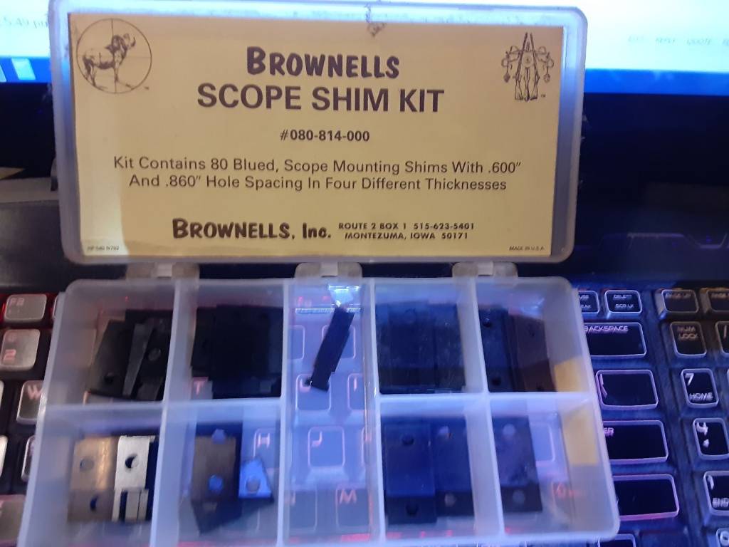

I have had great success shimming scopes. You can even use a layer or two of Scotch tape on the rear scope mount. It doesn’t take much to get the required degree of adjustment. Just make sure, as SteveKralsAround, JimMn and Wahoowad to loosen the front scope mount cap first and then not crank them down too tightly.
There is no question that the ideal way is to get adjustable scope mounts, but its not necessary in my opinion.
I agree with Tom Holland. Buy a set of fully adjustable Sportsmatch rings. I don't shim scopes because I believe it MIGHT damage the tube. Others certainly feel differently. The fully adjustable rings will solve your problem with NO stress on the scope tube.
Amen, been a gunsmith for over 30 yrs, never shim mounts unless your willing to risk crushing the scope tube, which will void your warranty. Use an adjustable mount !! Cant remember how many crushed tubes and other scope damage caused by shimming over the years.
I fail to see how a coke can shim placed under the scope tube will lead to a crushed scope tube. Lets have a little thought experiment here...
Let's assume you torque your ring caps to 15 in-lbs. So WITHOUT a shim your scope tube is sandwiched in contact between the ring cap and scope base at 15 in-lbs. Then assume you install a coke can shim and re-tighten and properly torque down your ring caps. Now your scope tube is once again sandwiched in contact between the ring cap and the coke can shim (which is resting against the scope base). So what's the difference?
I'm sure someone will come up with an extreme example but nobody has recommended an extreme example to OP here.
