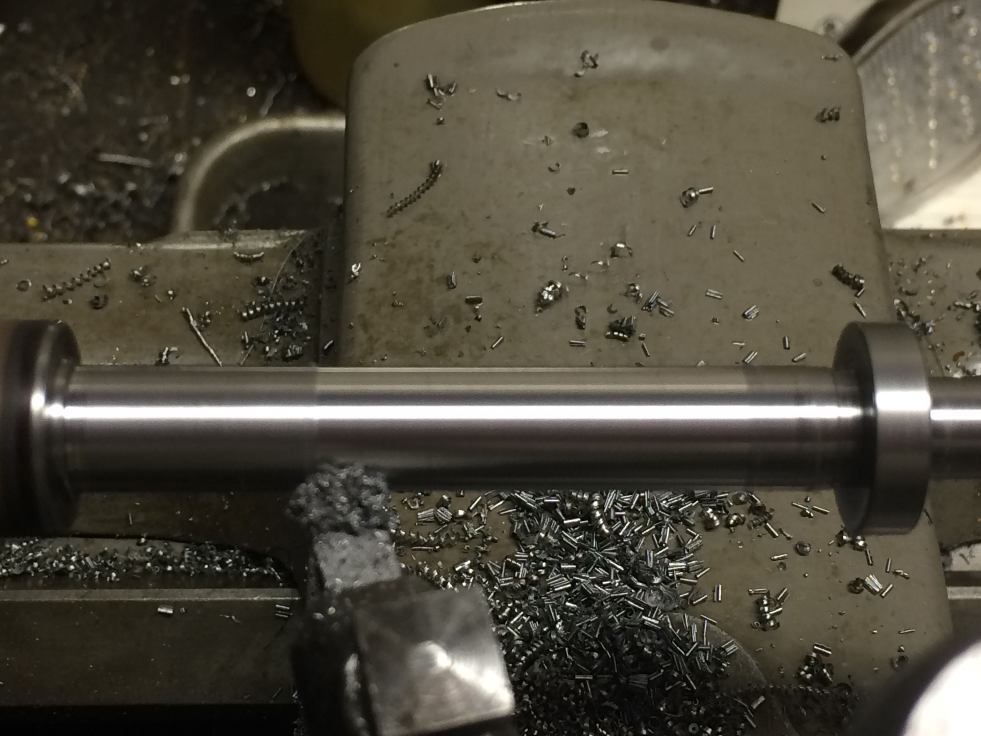

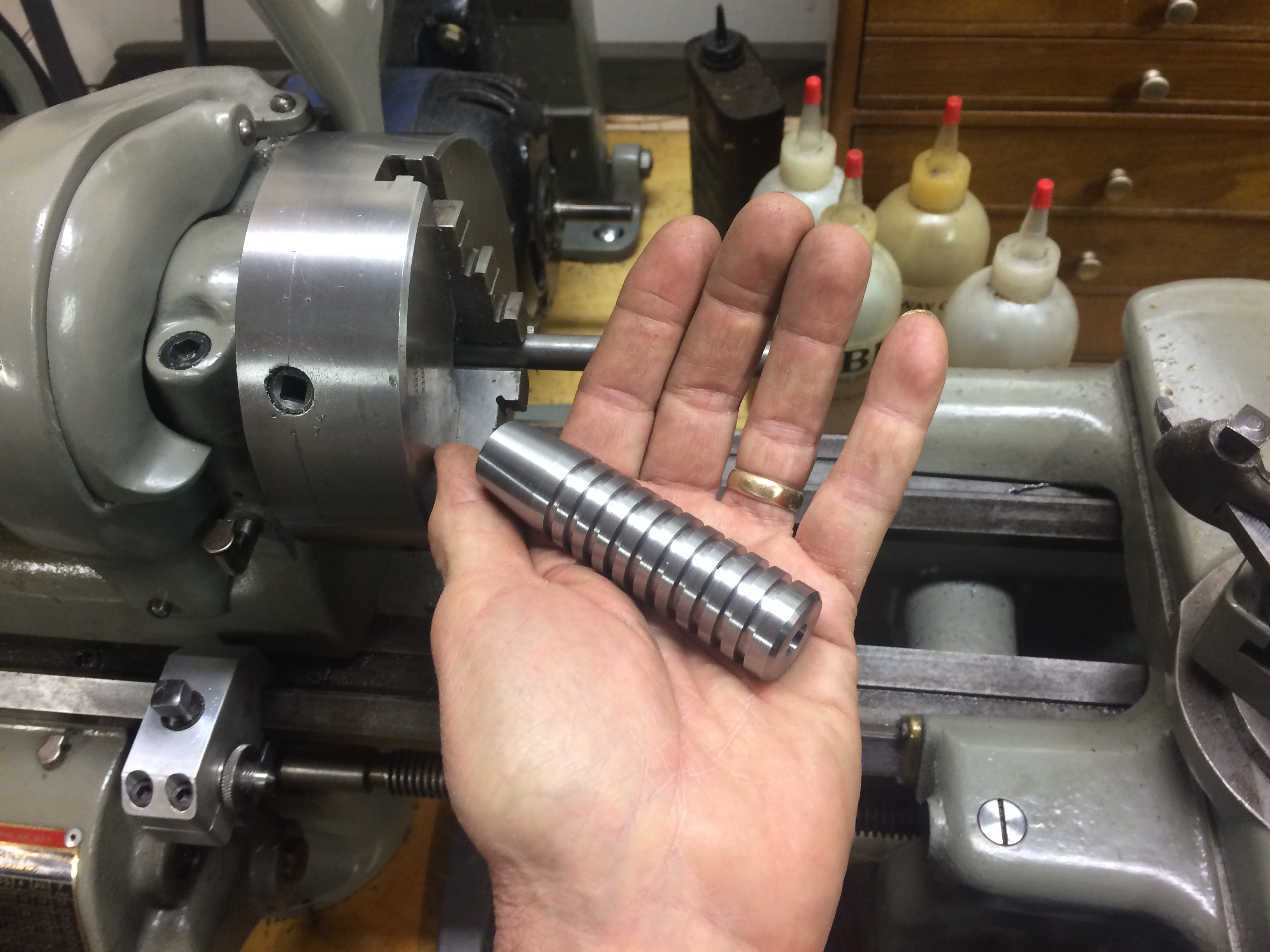

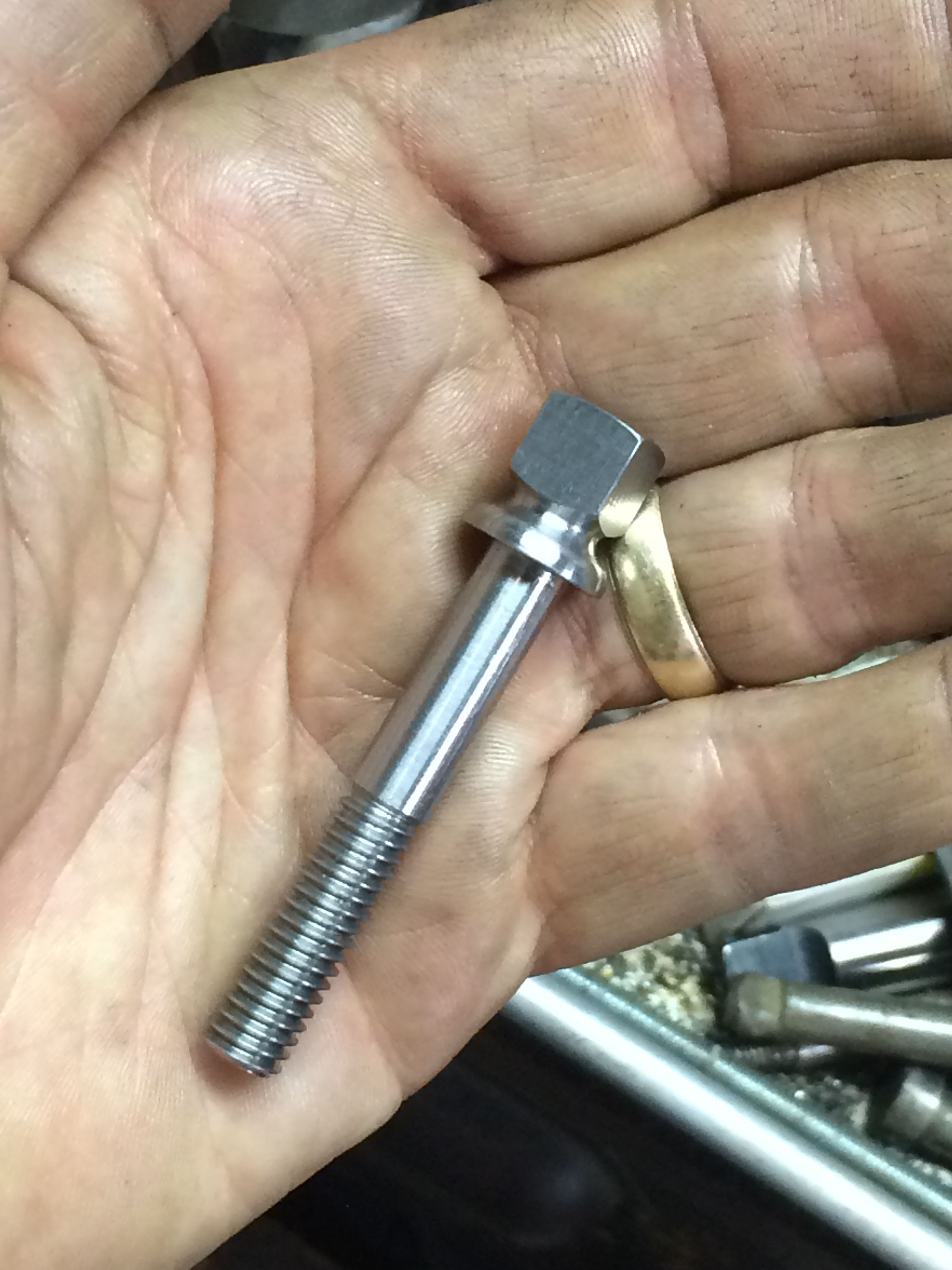

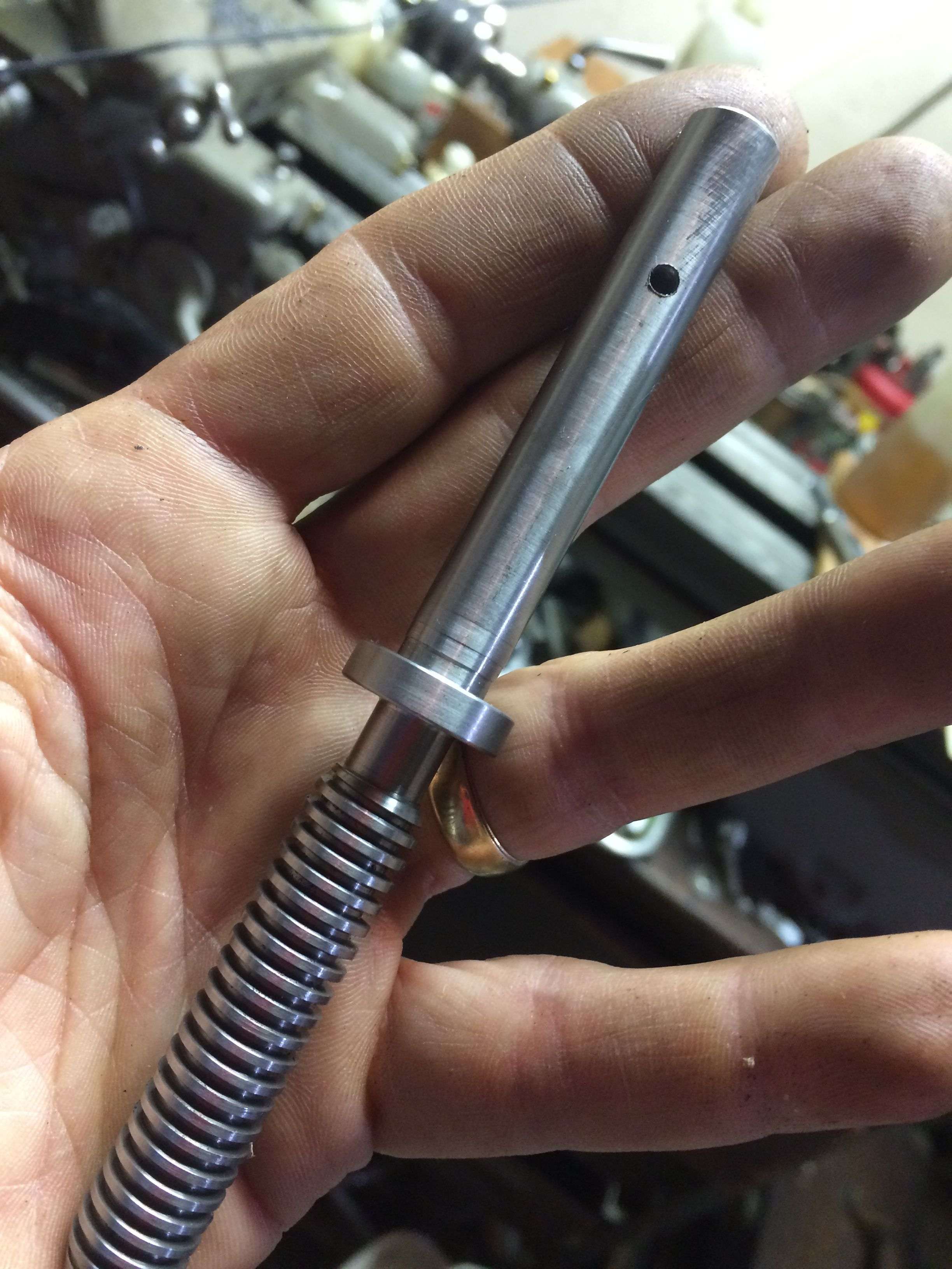

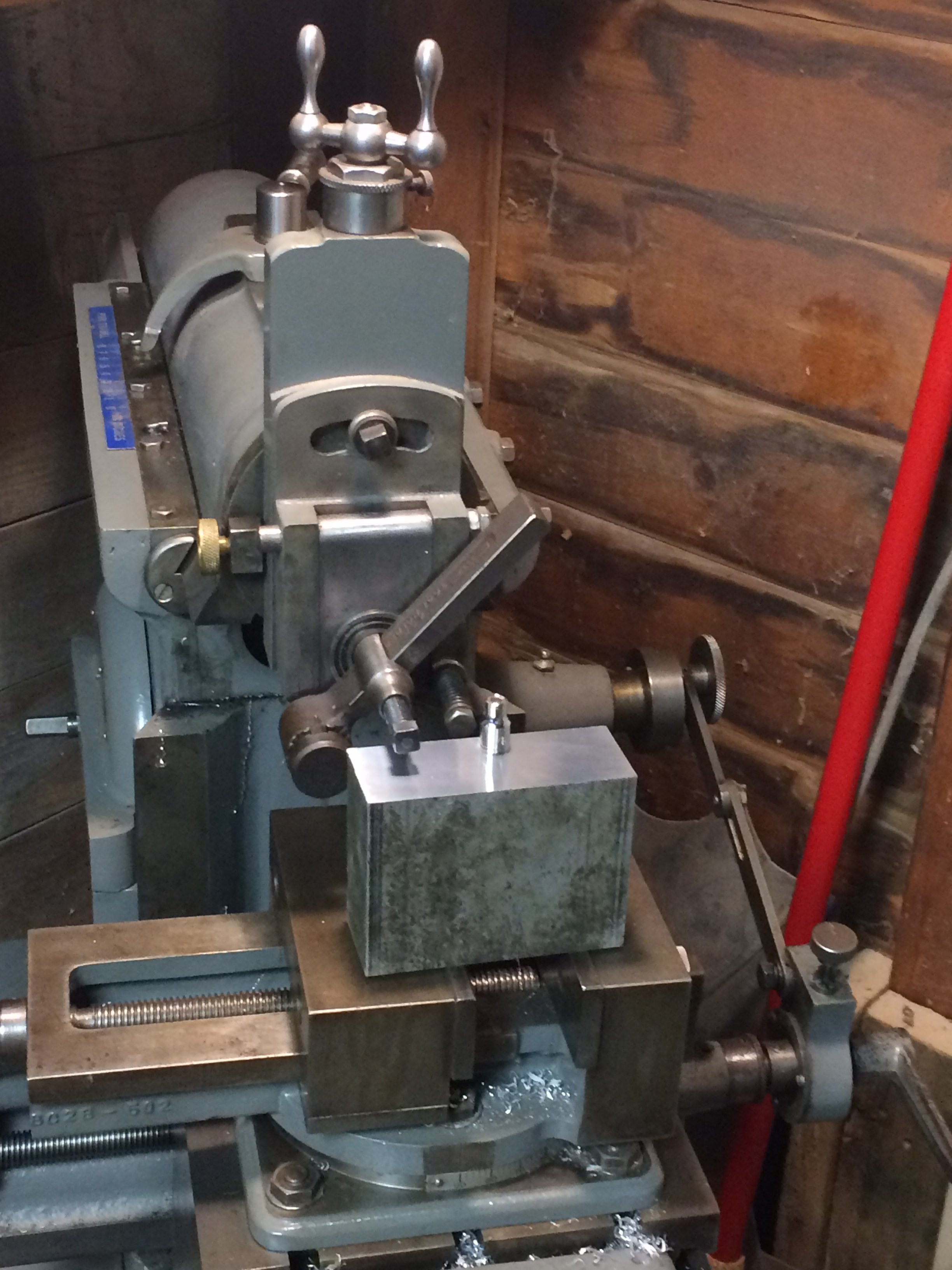

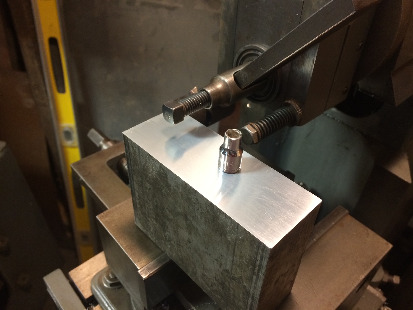

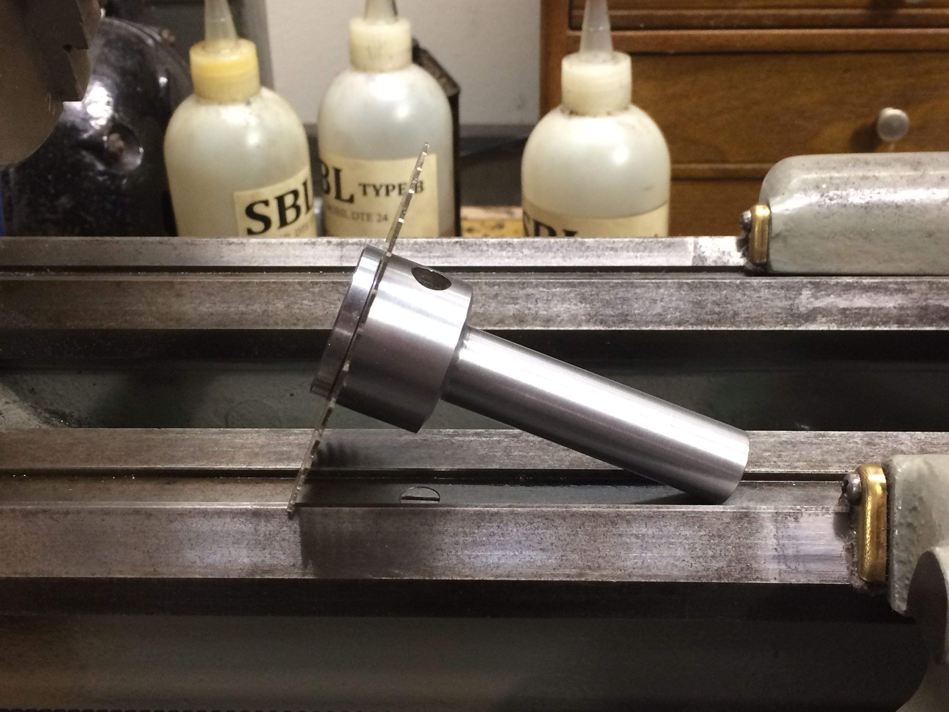

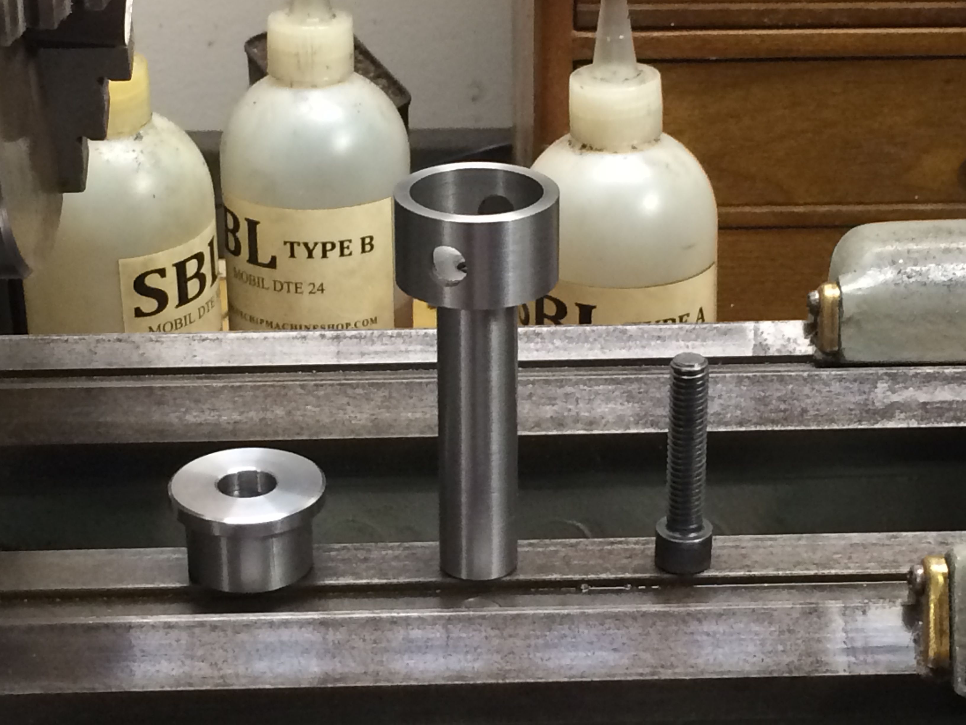

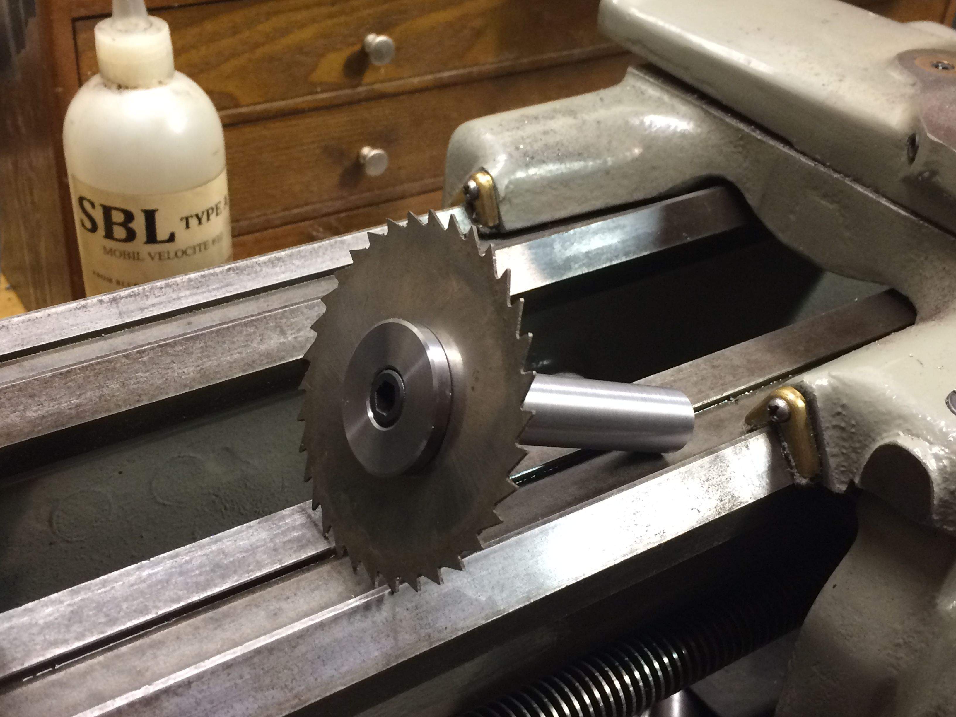

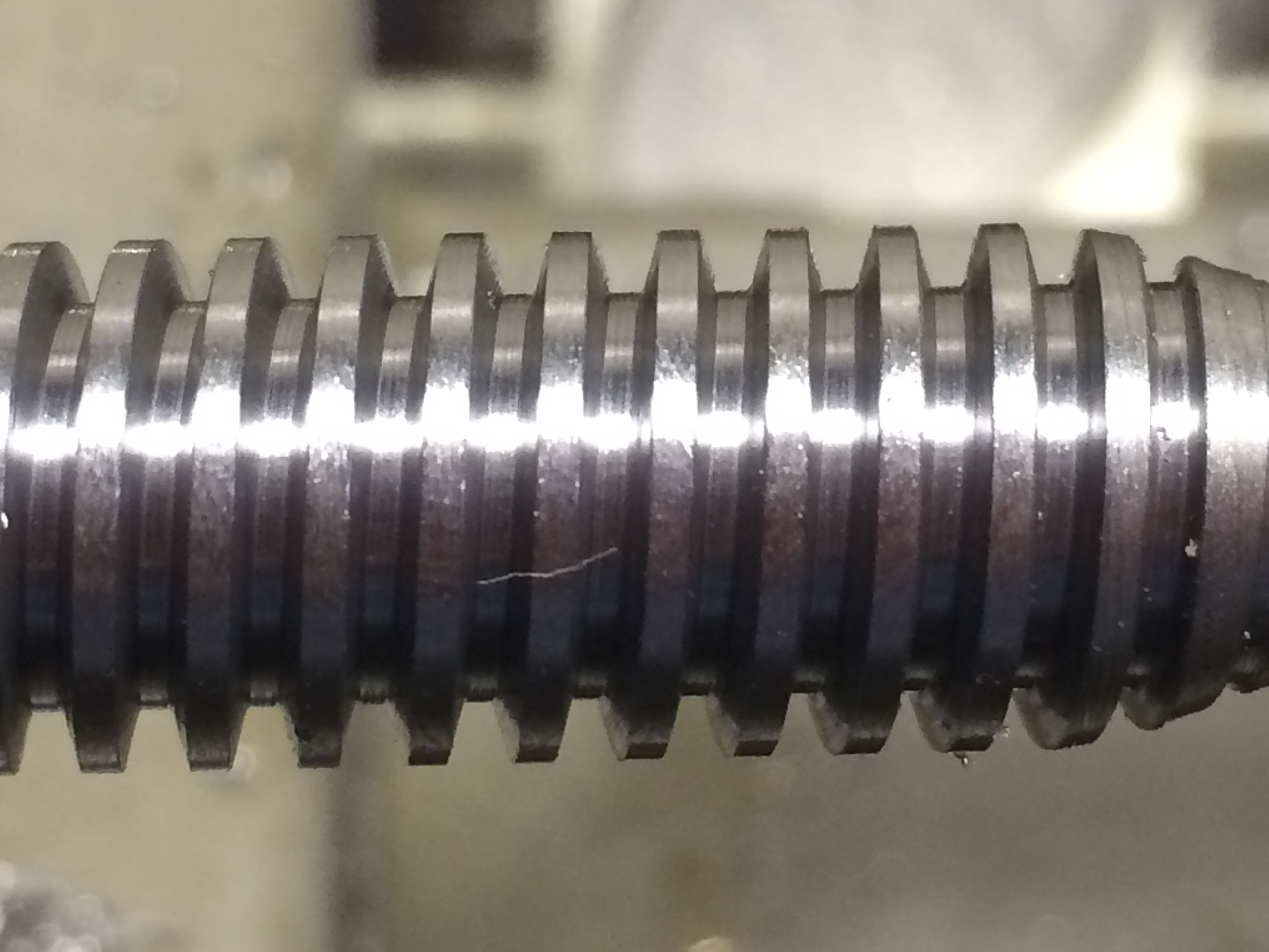

This is the finish I get on mild steel with properly ground HSS. Not even touched by any abrasive. The slitting saw arbor is made from scrap steel. Silky smooth. The two threaded parts are single pointed with hand ground bits. Last picture is a close up of the Acme thread I cut with a hand ground form bit. I only used a piece of 400 grit to debur the edges. It's an Acme feed screw when assembled has only .002 backlash.
One HSS tool bit blank has 1000 edges. HSS can finish Stainless almost like a mirror. No need to polish. Aluminum and brass are child's play.

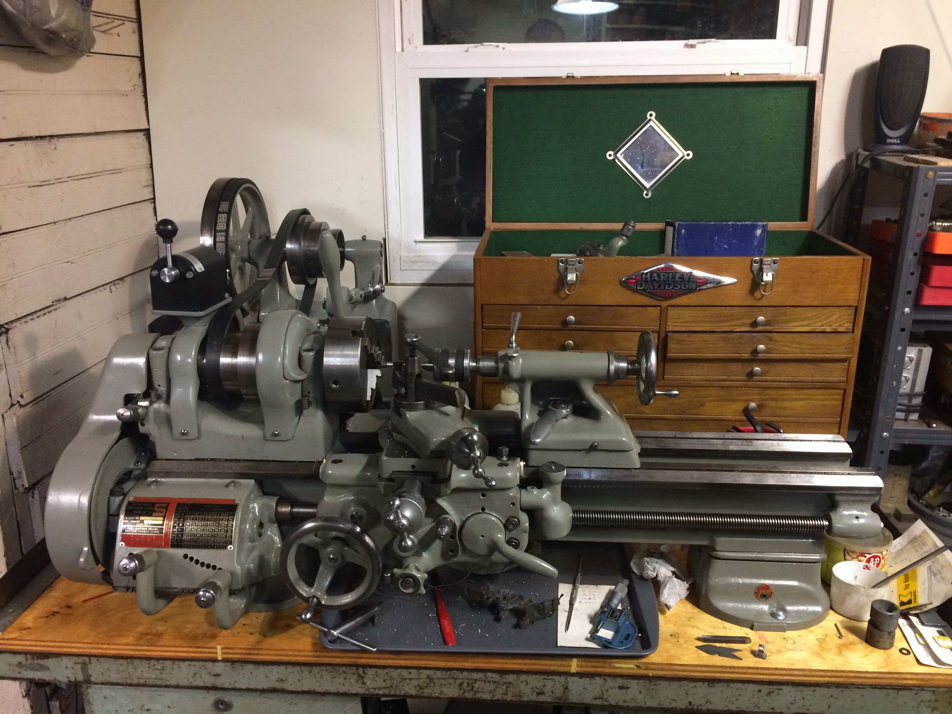

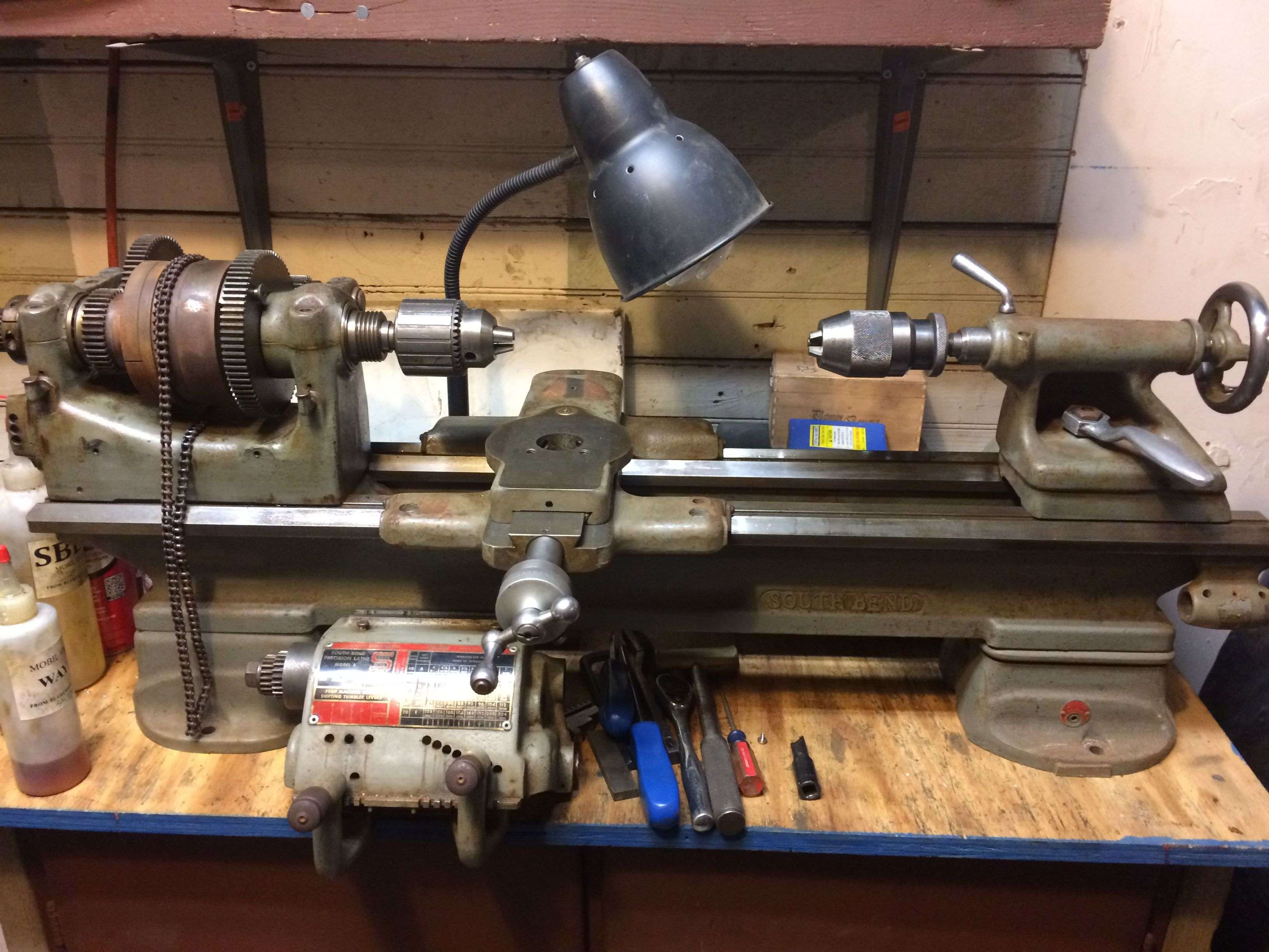

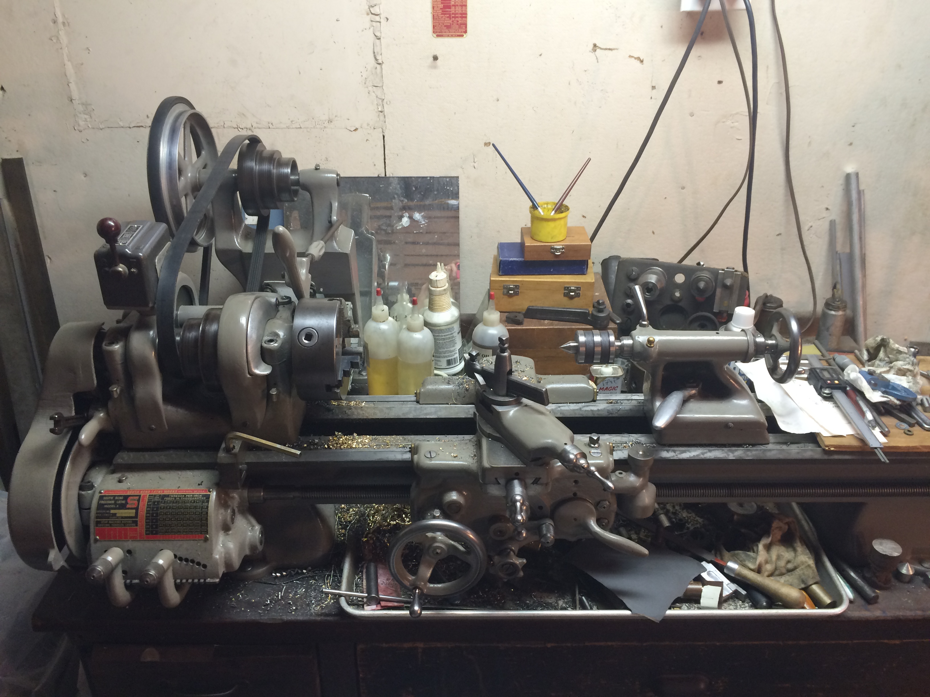

Took me years to find a lathe this good. Was modified for a factory use then put on a shelf and stored for many years unused. I saw a diamond in the rough and bought it at auction for about $200. All of the ways were barely touched. Has very rare for a South Bend 9a hardened 3 ft. bed. Took some work, parts, and custom matched original color paint. The original tailstock was missing but I found it and bought it separately at the auction. I almost missed it.
Last picture is my 4ft South Bend 9a made in 1947

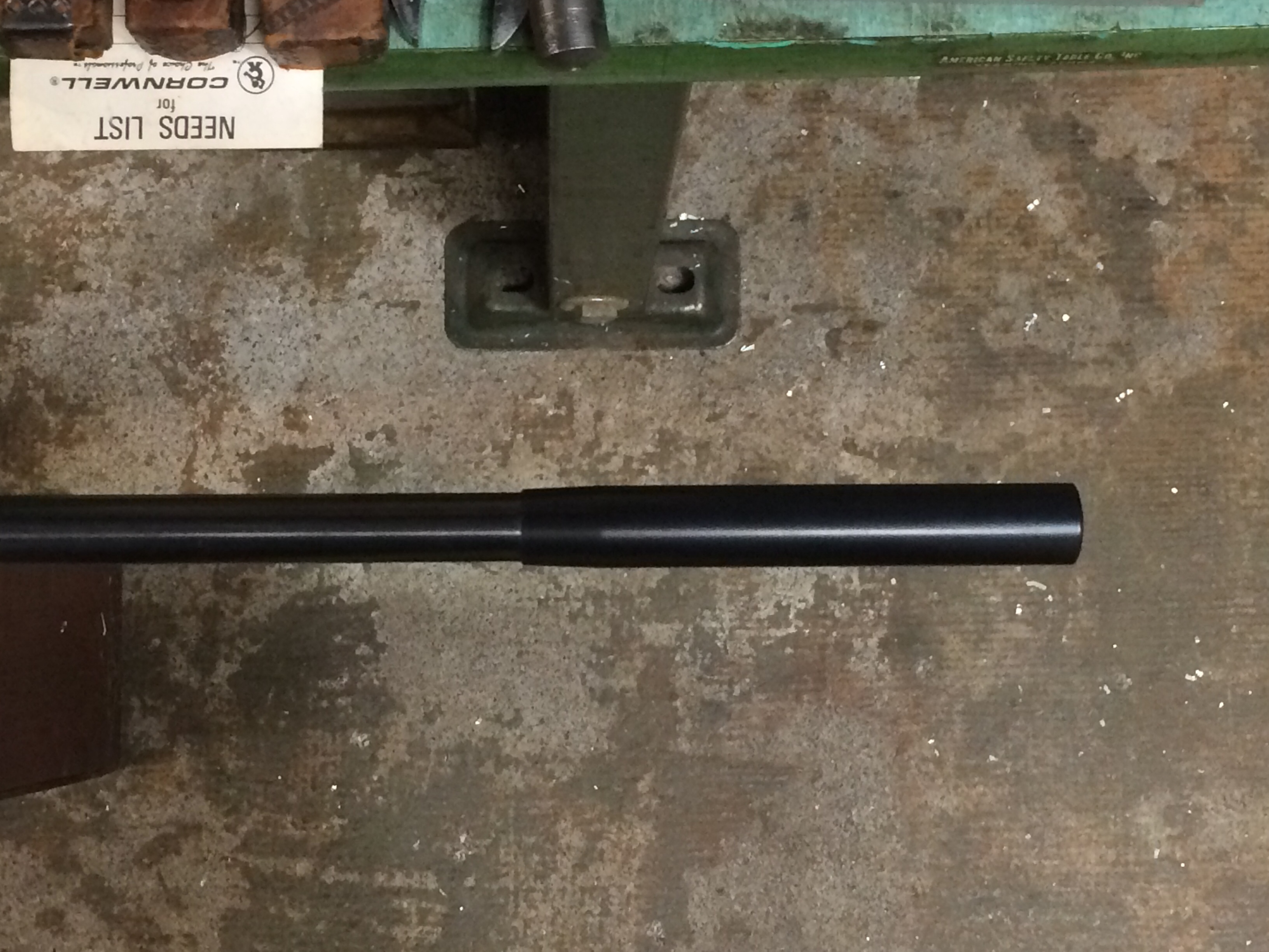

It’s amazing how much can be done with traditional equipment. That said, I am disappointed that more isn’t being done today in the Airgun space given how much more affordable self manufacturing has become. We have 3D modeling, CNC mills and 3D printers now but much of the design skill that was prevalent in the USA years past is disappearing and most of what I see is people making phone holders/stands or figurines. I’m sure there are some folks out there pushing the envelope but not as many as I would expect…
Edit - I’m thinking of springers not necessarily PCPs.

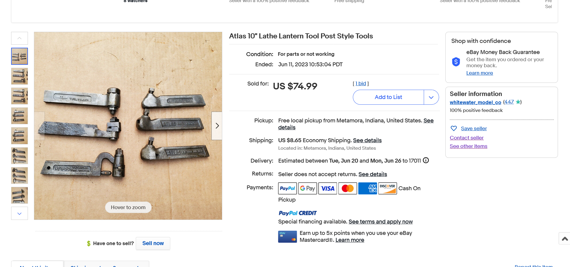

I just scored these for my lathes and metal shapers. Most won't know what they're for or what they're worth. The Armstrong 39 shaper planer tool holder often sells for $200. The Armstrong S 50 spring tool holder is worth about 70-80$. I'll resell the other 4.

nice work.. but it doesn't seem to matter to me if it's scrap or new.. you always machine off any imperfections anyway.. only time scrap steel makes a difference is if you are trying to Tig weld.. that has to be perfectly clean.

There are lathes, then there is South Bend.
