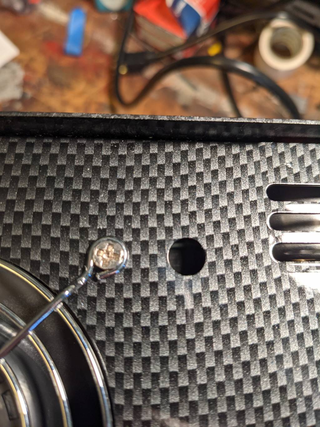

The inlet screen really should be on the side where there is already a hole in the cabinet.

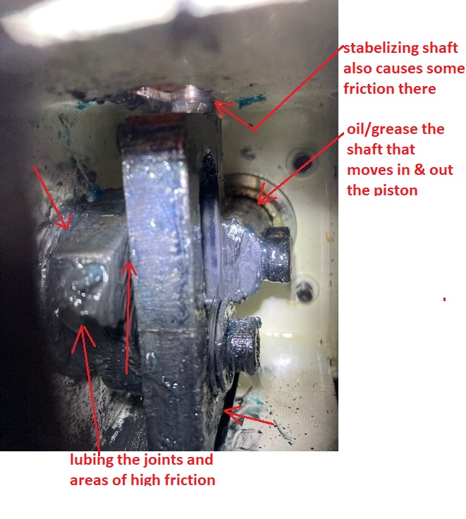

I'll take a picture of it later but when I opened the hood, first you see the motor, then a train like drive system which is all greased up. That doesn't have to be regreased for a while. The drive system is then hooked up to a shaft and the shaft is hooked up to the piston. The center of the piston is what needs to be oiled from time to time for best longevity I suspect.

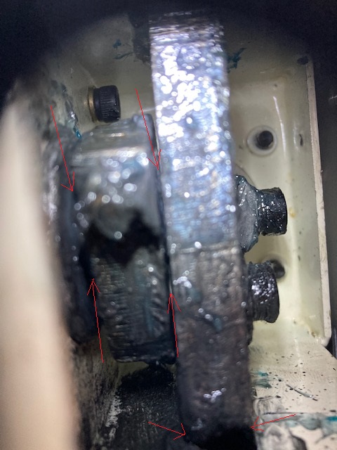

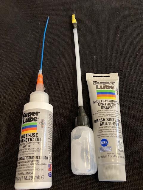

I took the easy route and didn't have to disassemble anything actually. To get to those hard to reach areas (marked with red arrows) through the slots in the back side of the case cover, I put a long extra and thin straw (like the one that comes with a WD40) and taped it on the silicone oil tube, did the same with the silicone grease tube just with a wider straw. I try to not drench the joints and apply just enough to ease up the friction.
