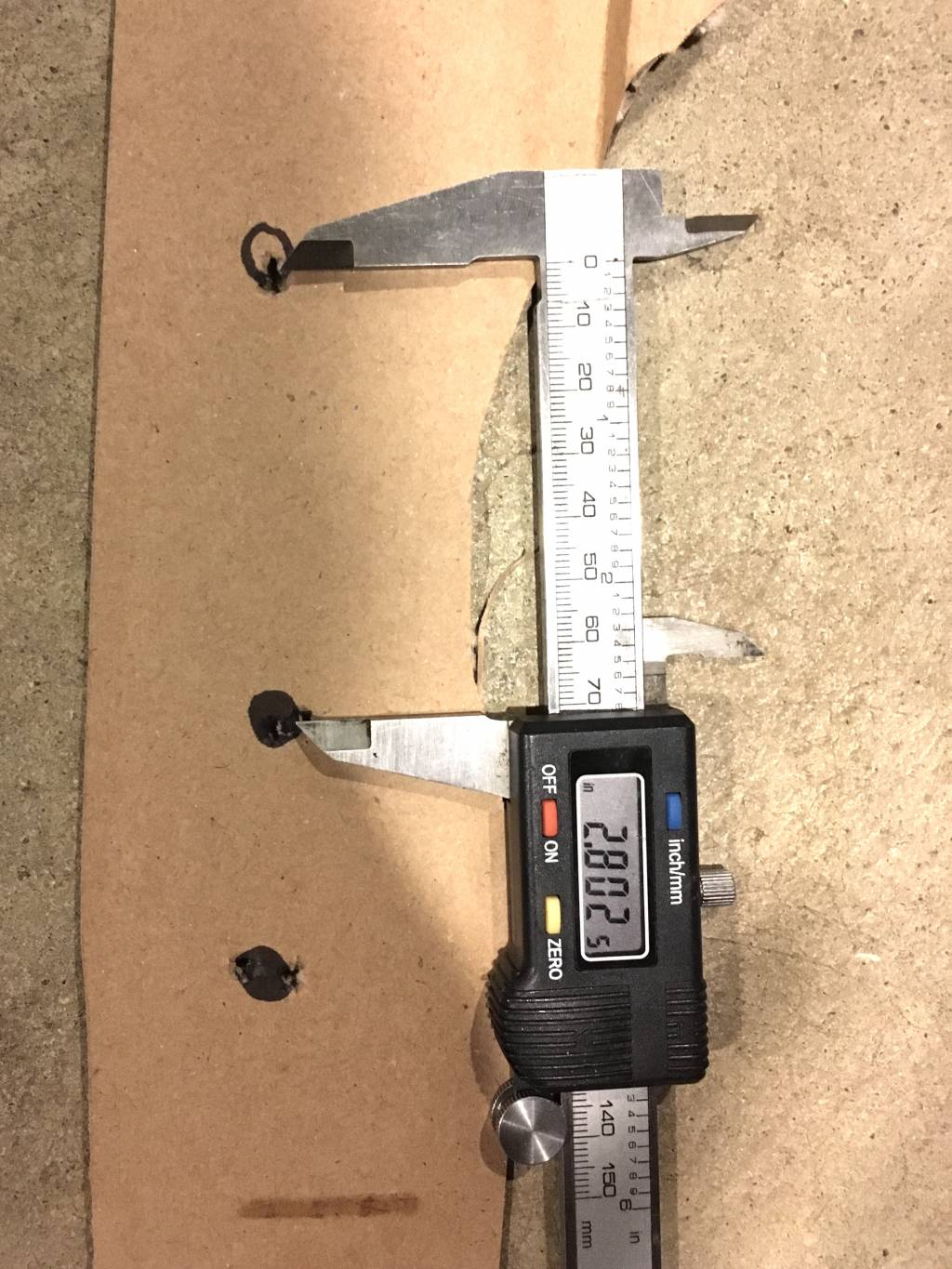

Decided to do a turret tracking test on my new Optisan HX tonight. The results are ridiculously good for a $100 scope that's not really designed to dial. First 2 shots were at middle dot, followed by 2 with the same hold but 11 MOA dialed. At 25 yards 11 MOA is 2.88", which is where the hollow dot is. As you can see 11 MOA on the turret moved the POI 2.80". Keep in mind that this type of test isn't nearly as precise as having the scope locked into a fixture. Next I worked the elevation turret up and down within that 11 MOA range several times and returned it to zero. The bottom dot is two shots after this process. As you can see the scope returned to zero perfectly!
