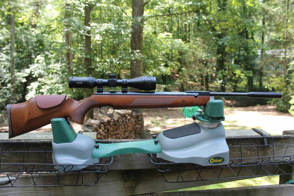

I believe that you will be able to move the scope back where both 2 piece rings will fit behind the port. Reference this compact Hawke scope on my HW95L using 2 piece Hawke tactical 30 mm medium rings.
FYI SportsMatch T035C 30 mm 2 piece medium rings are 7/8" in width/length while the Hawke tactical are 1" in width/length. Width is length front to rear on the dovetail.
Same rifle with a Hawke 3-9 x 40 mm scope using SportSmatch T04C 2 piece 1" medium rings.

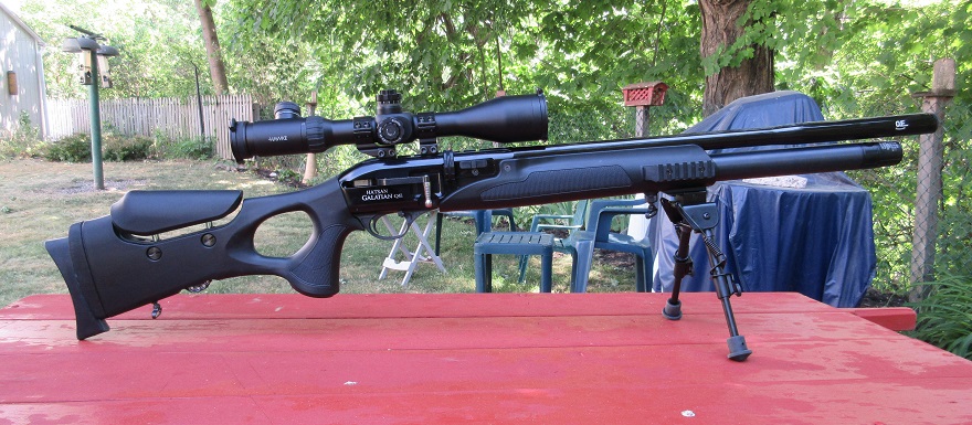

Doubt very much the picture helps...
Have no doubt. Sitting here rolling the scroll up and down between your photo and my photo, can visualize, and kinda liking. Galatian, never seen one. That's a handsome gun.

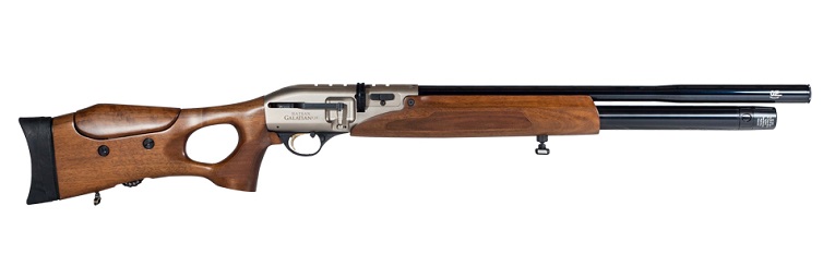

Thank you, sir. It was Hatsan's top of the line PCP back in 2016 when I bought it and would appear pretty much forgotten once they jumped on the PCP wagon and started cranking out a new model every 6 months...lol. They also make a Turkish Walnut stocked version of it. Some people liked the silver plate on the action, I didn't and bought the black synthetic instead. Would also appear they prouder of it for some reason considering the $150 price jump since I got mine and the walnut has jumped $200. Then again, prices have jumped on pretty much everything the last year or so. Just for chuckles, the Walnut stocked version:

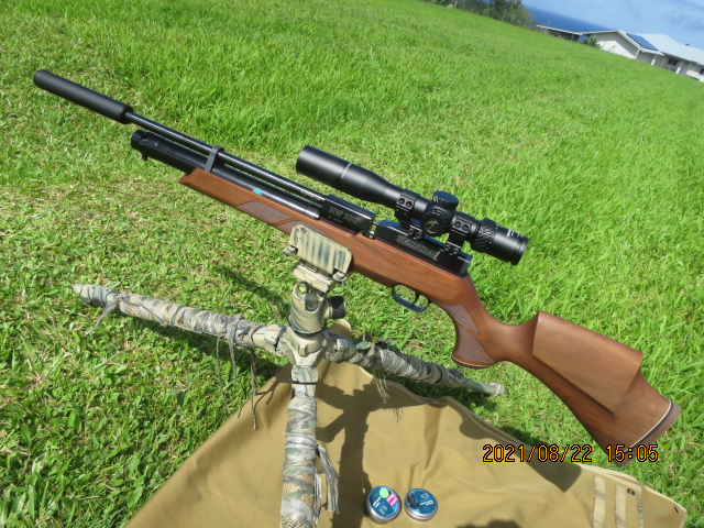

Thank you all for your input. Ordered up the Hawke 30mm HIGH 1" extended mounts, as recommended by @SteveP-52 . Priced affordably (similar Sportsmatch are twice the price). Went high mounts as a hedge for cheek weld, liking @Deerstalker 's cheek pad if need to fine tune. Now just waiting for the mailman. Will bump this with a photo of finished rifle in a week or two.

Very nice looking rig and hopefully those mounts are working out on the rifle like you wanted them too.
Am maybe tin-and-a-half in to the HW100, and pleasantly dispelling the poor accuracy .22 bbl story of yore. Will give me under inch-ish groups at 50YD if I give the effort...chicken-winging it off a tripod. Still fiddling with the eye relief, reversed the mounts for better set back last night. Re-sight this morning.
Bit of problem with the mounts. Flipped the plate over for 11mm and found a bit of the plate riding low, holding the mount at a slight cant. Bores of scope over bbl not plumb. So going fix that today, just file off the offending tit. If the block wasn't machined so flat that tit would prolly ride off in the air like on a receiver that has rounded top.
Really like this scope. Set parallax at 25YD, zoom to 10X, and trust those holds, been drilling spinners from 15YD tp 40YD. So this scope IS totally designed for the HFT guys.
