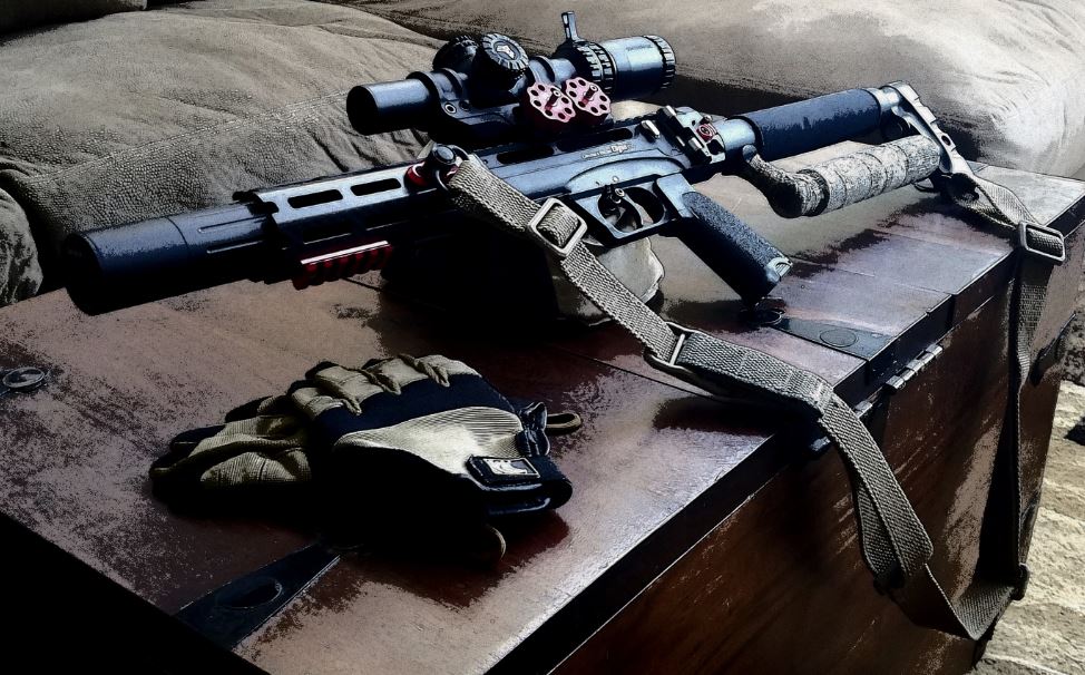

I did see a demo version at Optics Planet... but still not near $600 - only a couple hundred off. I have the March on my Leshiy and I LOVE it - it is light and amazing. Also think about the ScalarWorks Leap/02 for the mount - heard about the mount from Brian at EdGun West and decided to give it a try - it has been awesome and very light. Perfect compliment for the light March scope. I usually like lots of magnification but took my Leshiy to the range and the March was great at 50 yards

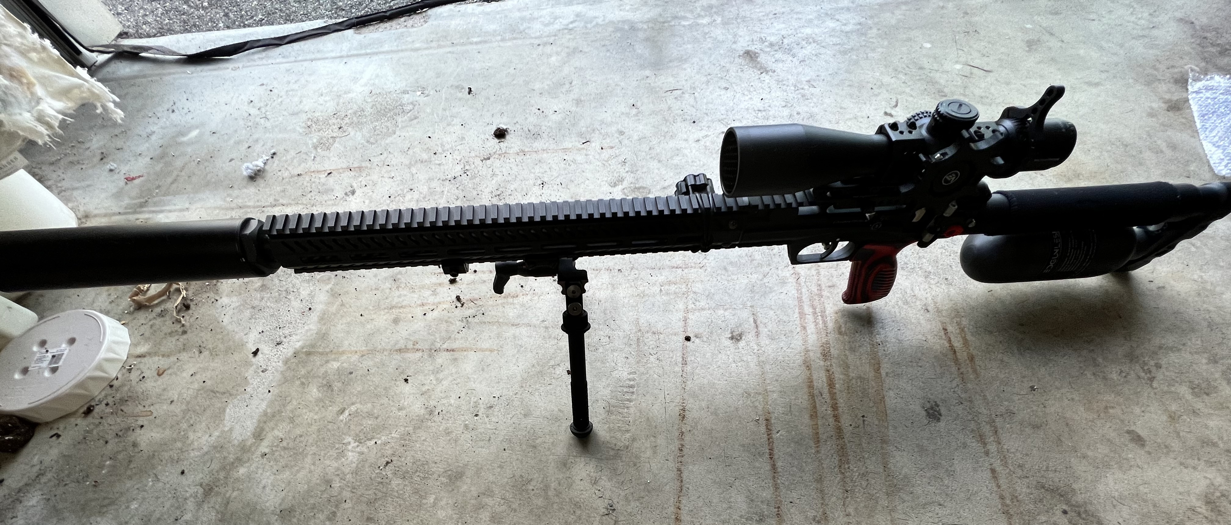

I tried the Vector Optics Veryon 4-16x44ffp.

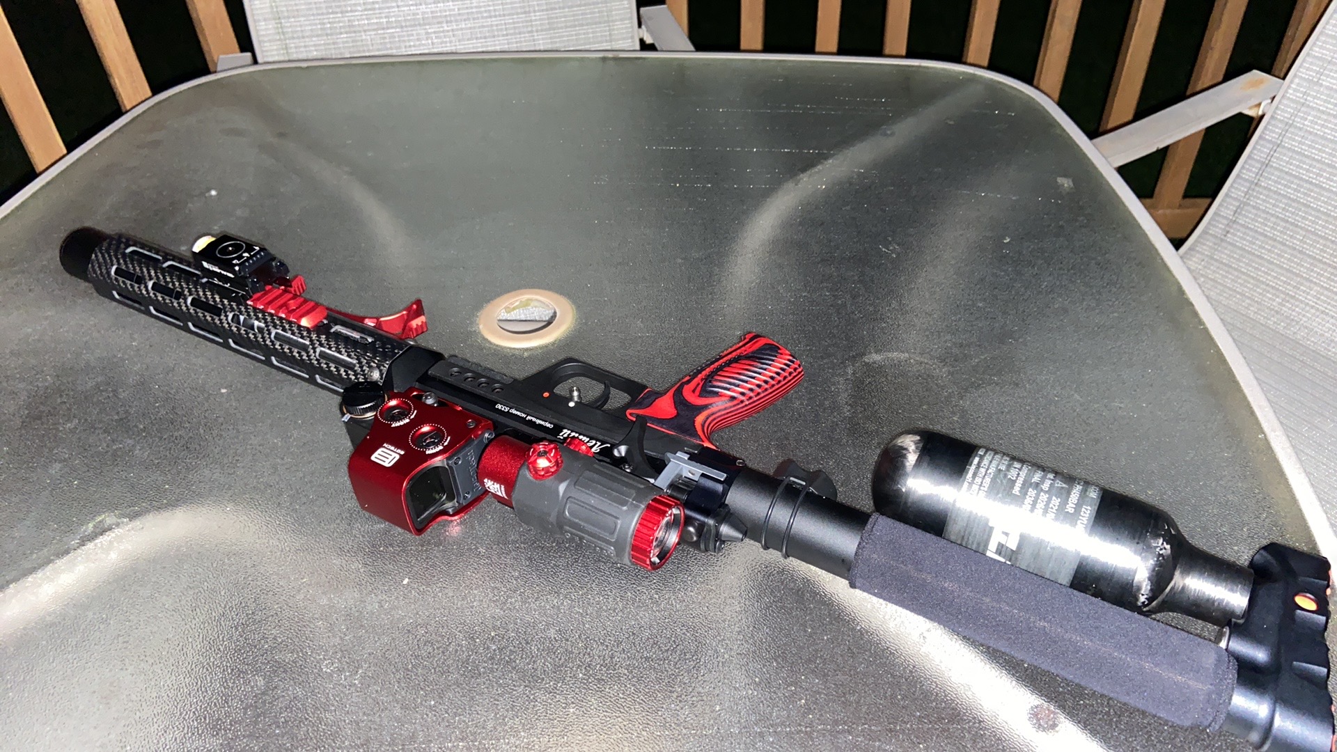

I currently run 2 different optics on my L2. I run a Nightforce NX8 2.5-20X50 for longer distances and an Aimpoint T1 Micro red dot for up close shots which is the majority of where I do my shooting with the L2. Both are mounted with LaRue QD mounts for return to zero when I switch off between the 2. Ideally, I might get an offset mount to run both at the same time but I'm okay for now.

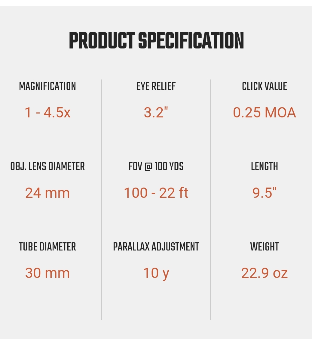

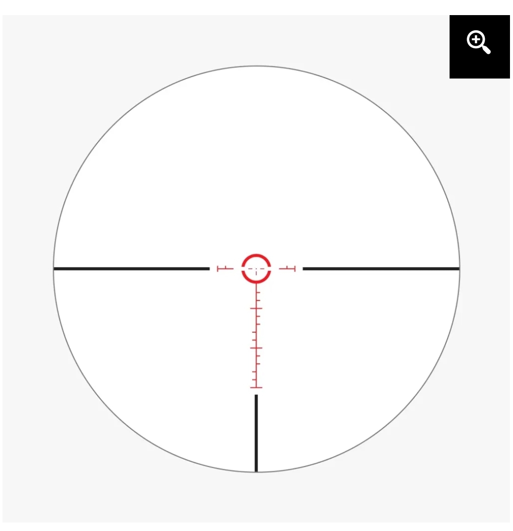

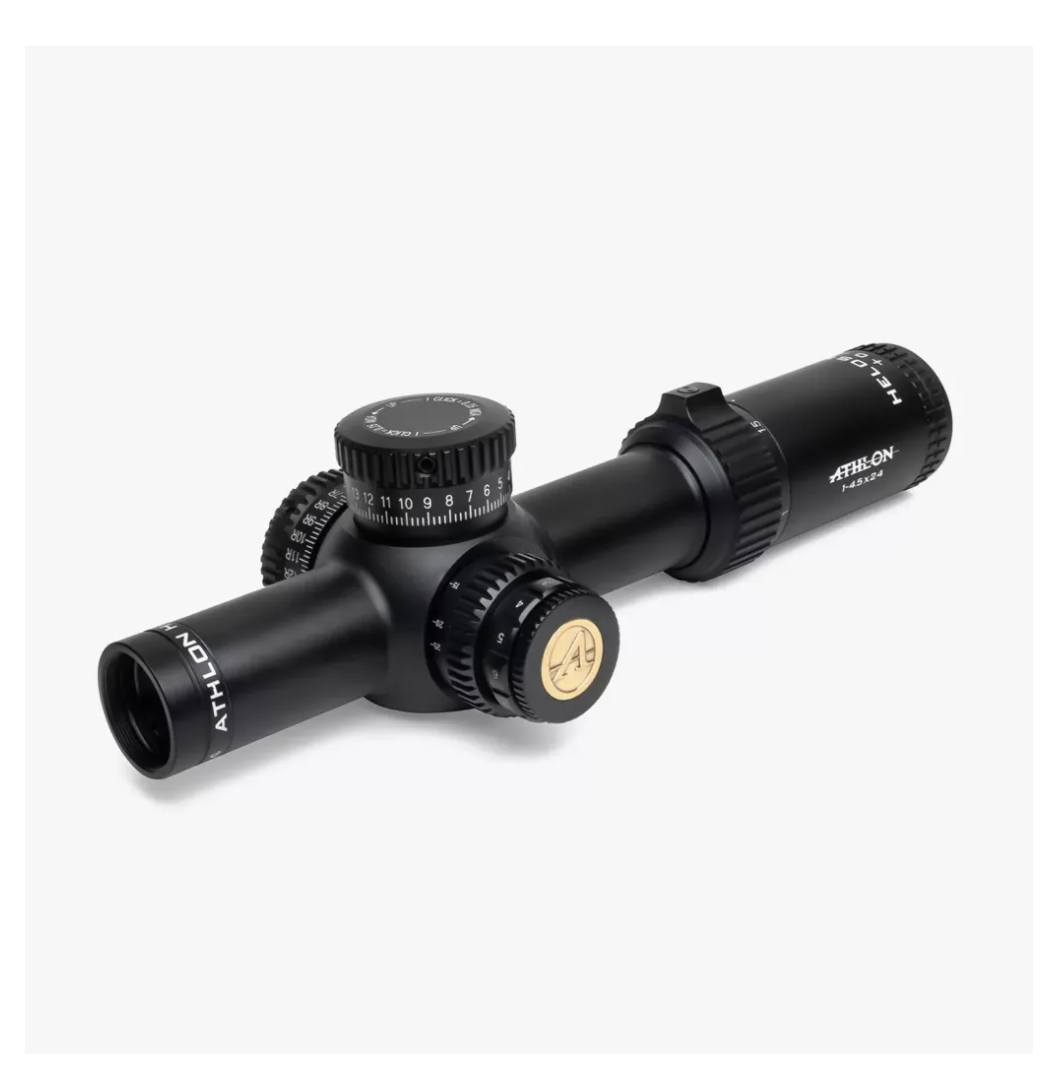

The March 1-10X would be ideal due to the 10 yard adjustable parallax if you have the coin. Most LPVOs' (except for March) don't have adjustable side focus/parallax and are fixed. The only other LPVO that I know of that has adjustable side focus from 10 yards to infinity is the Athlon Helos BTR 1-4.5×24 which is a SFP with MOA reticle and donut of death.
Just checked Cameraland NY and it runs for around $430. It might be worth a look. I don't have any experience with it and I'm not sure if the illumination is daylight bright. A little negative is that the weight is a little on the heavy side compared to other LVPOs' in its class or with higher magnification. It's hard to have it all sometimes. I do have the Helos BTR Gen2 2-12×42 which is a pretty good optic and I would say that the illumination is usable during the day time.
Here's some pics of the Athlon Helos BTR 1-4.5×24...
White Oak Armament, March and of course the Athlon you posted all make a 1-4.5x service rifle scope with side focus. Then of course March makes a 1-8x24 and two 1-10x24s with side focus.
There is also the discontinued Styrka 1-6x24 with side focus. I picked up a couple of them when they were on sale. Last I checked the remaining stock was priced a bit higher. Maybe around $300 for the illuminated model. Do note that these only have a duplex reticle so they are not ideal for close fast target acquisition nor are they good for holdovers. And the turrets are capped and not great for dialing range regardless.
I'm strongly considering an L2 and I don't think the Styrka scopes will end up on it. I just would not like the duplex for close up plinking. Would much prefer a horseshoe or donut reticle for how I imagine myself using an L2.
