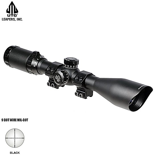

Are UTG scopes generaly considered to be more resistant to shocks ? For example I saw
https://milidonis.gr/utg-3-9x32-1-bugbuster-scope-ao-36color-mil-dot-rings
What does droop comp mount mean? Is it possible to sent me a photo or a link for that? Is it a ststem that absorb recoil?
Thank you anyway for your time !
I can tell you my Gamo Mag 33mm Piston has trashed a handful of scopes, including a couple popular name brand scopes. I would only recommend a fixed power SWFA SS for a heavy hitting break barrel. This came to me at the recommendation of a couple fellow forum members who had experienced similar trouble breaking scopes. Literally every scope made today that is "springer rated" is limited to the normal 12fpe. Of the very few manufacturers that will claim to be "springer rated", they well also tell you a magnum springer will void your warranty. Other than that I would make sure to get a scope with an excellent warranty history (Athlon, Vortex, Etc.) and one that has an etched reticle instead of the more fragile wire.

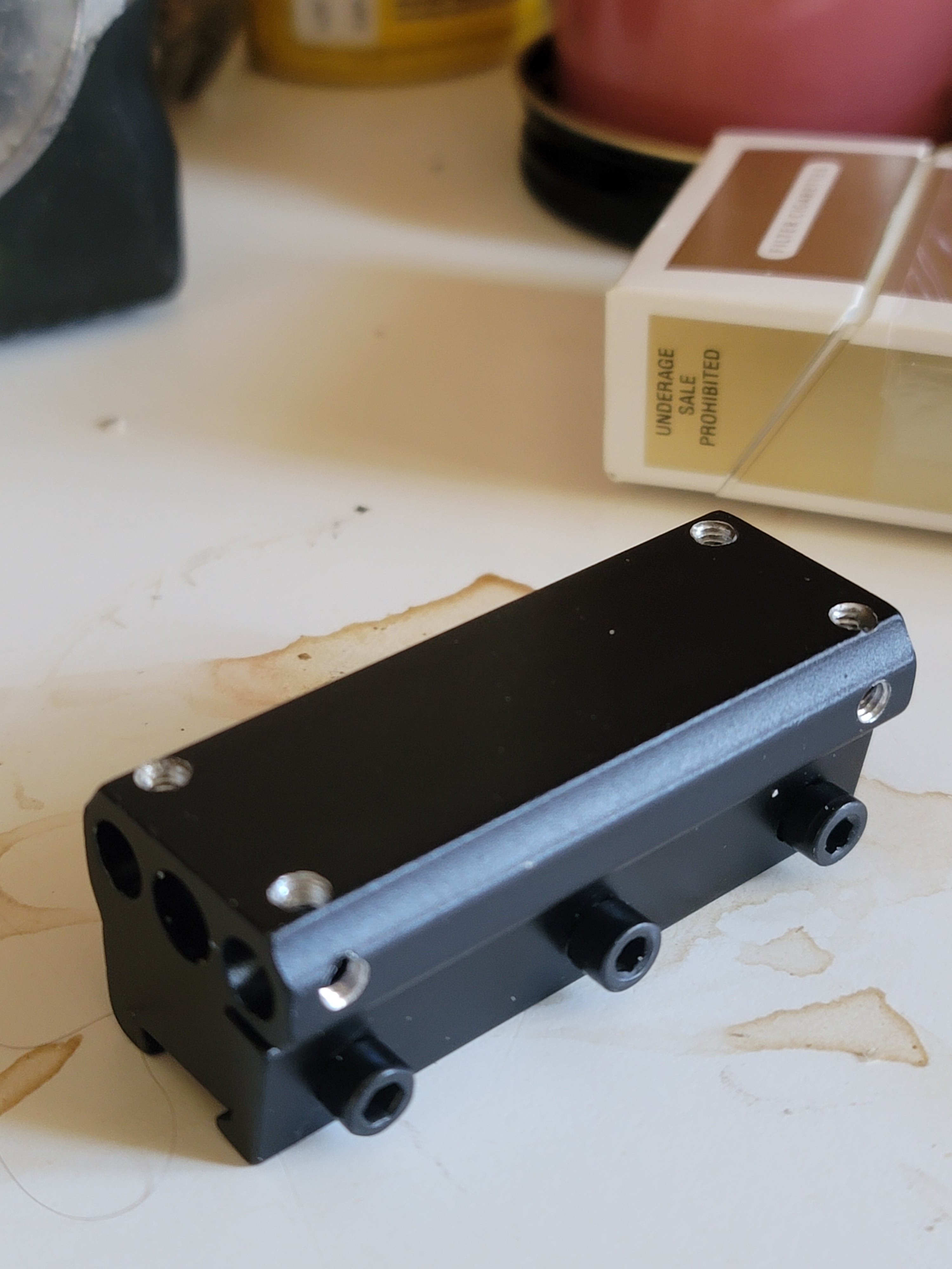

Does zero recoil mount causing trouble keeping zero?
I dont have any complaints. I did take the slop out of it by pre-loading the slides w/nylon screws... There was a video on Youtube by Walnut & Steel that compared loose vs tightened-up mounts & if I remember correctly, there was little or no difference. I was plinking targets @50yds earlier today W/Hawke scope on a Chinese Zero Recoil mount from Amazon.
