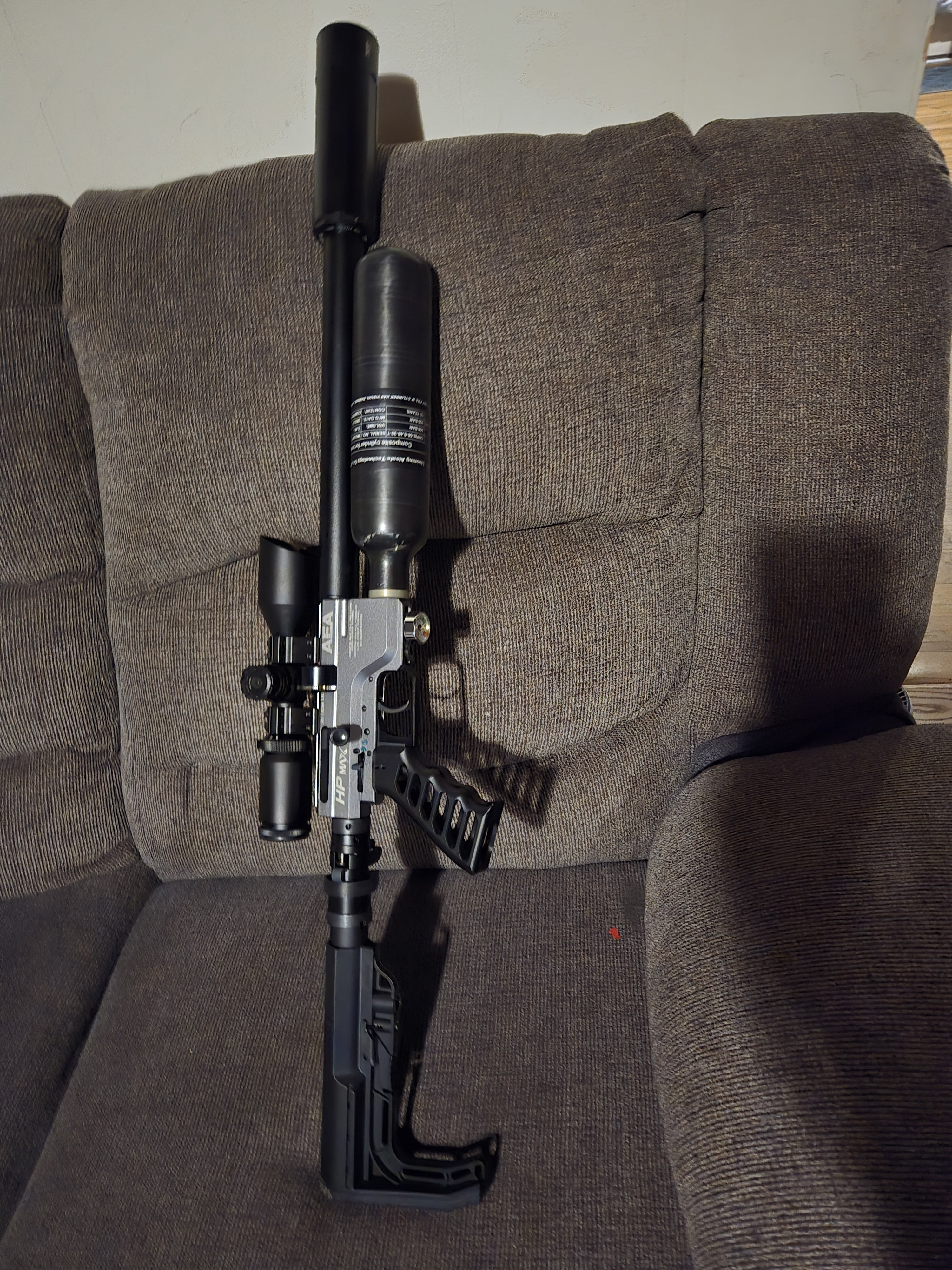

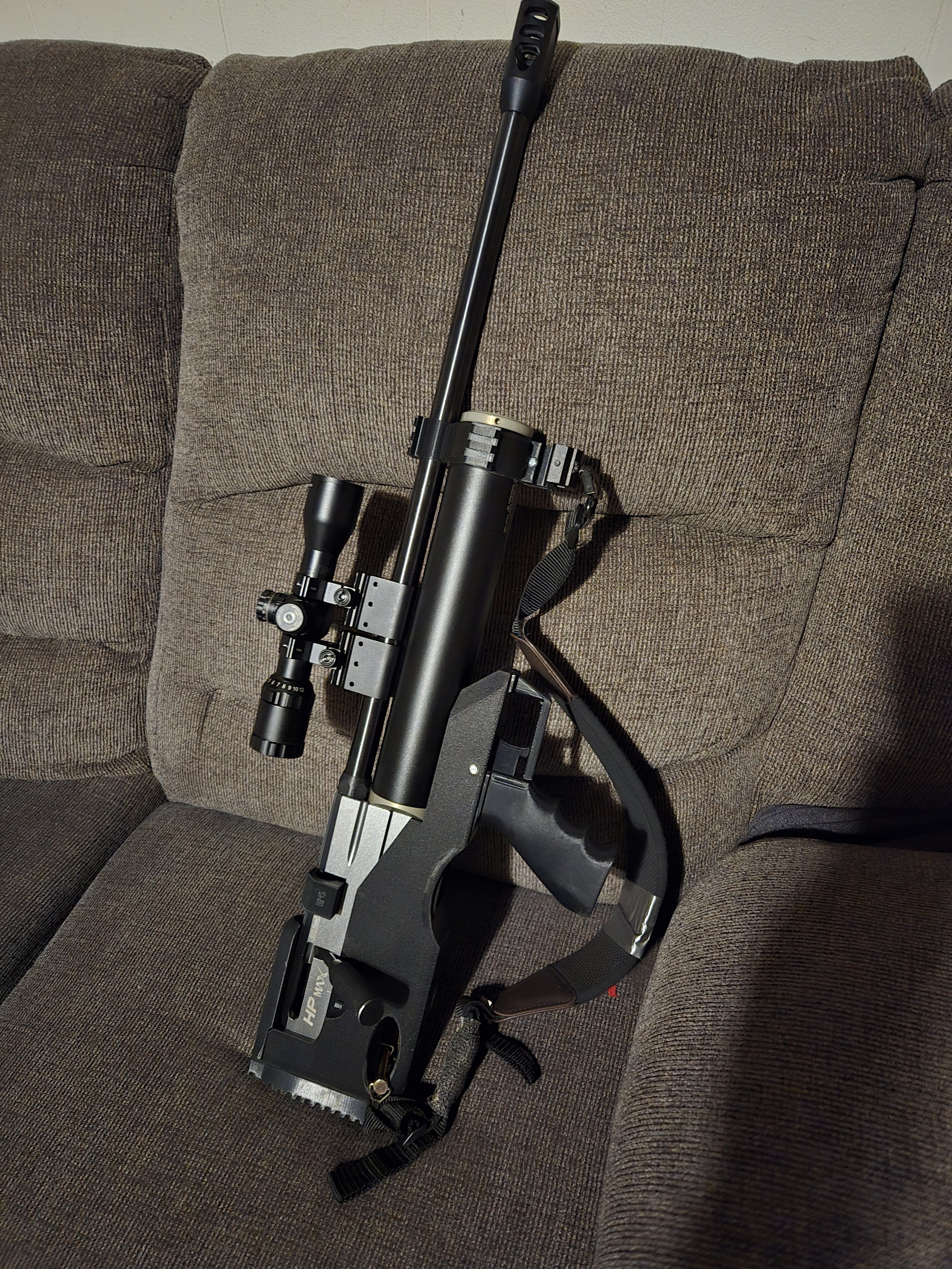

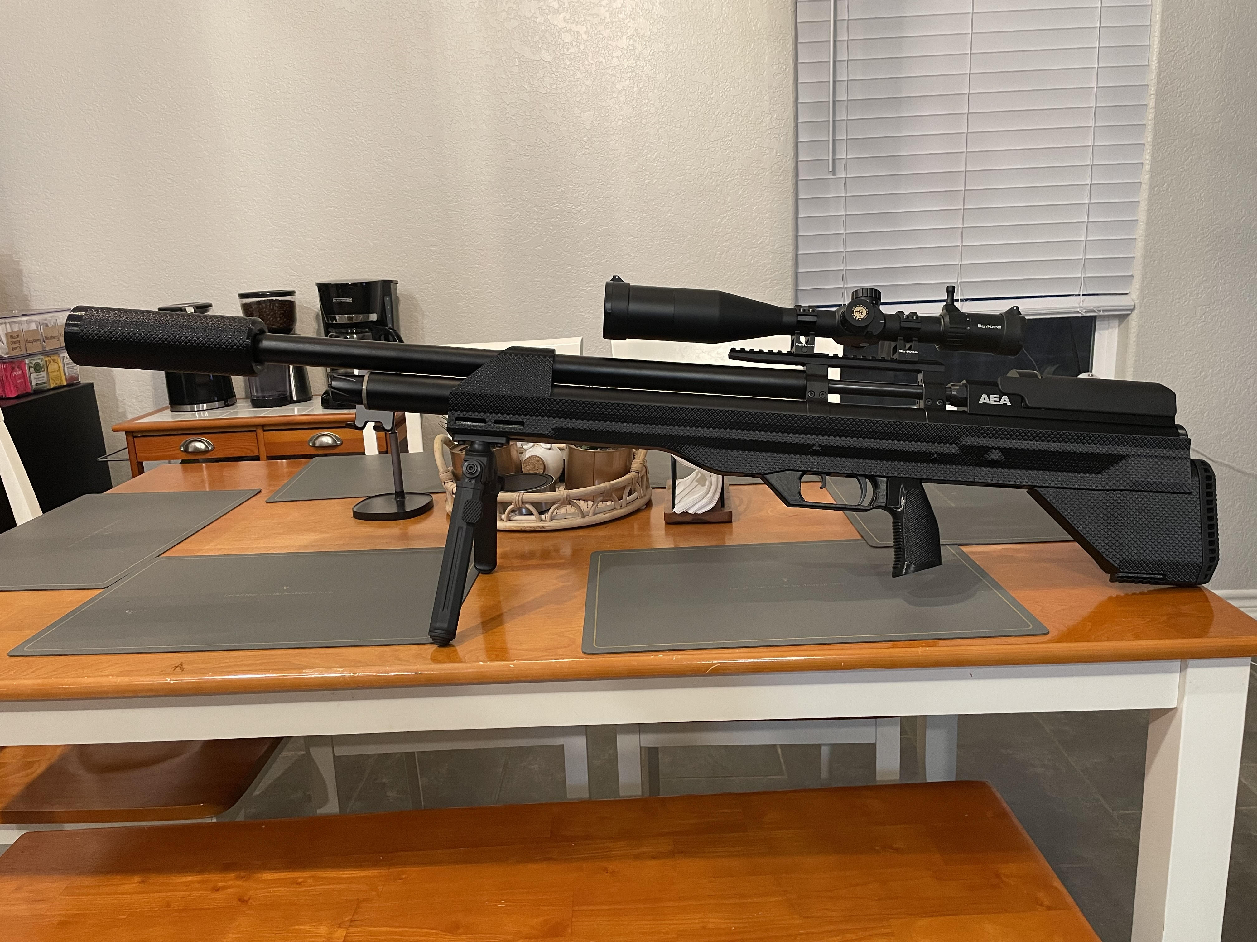

Here's a recent picture of my .457 and my .30

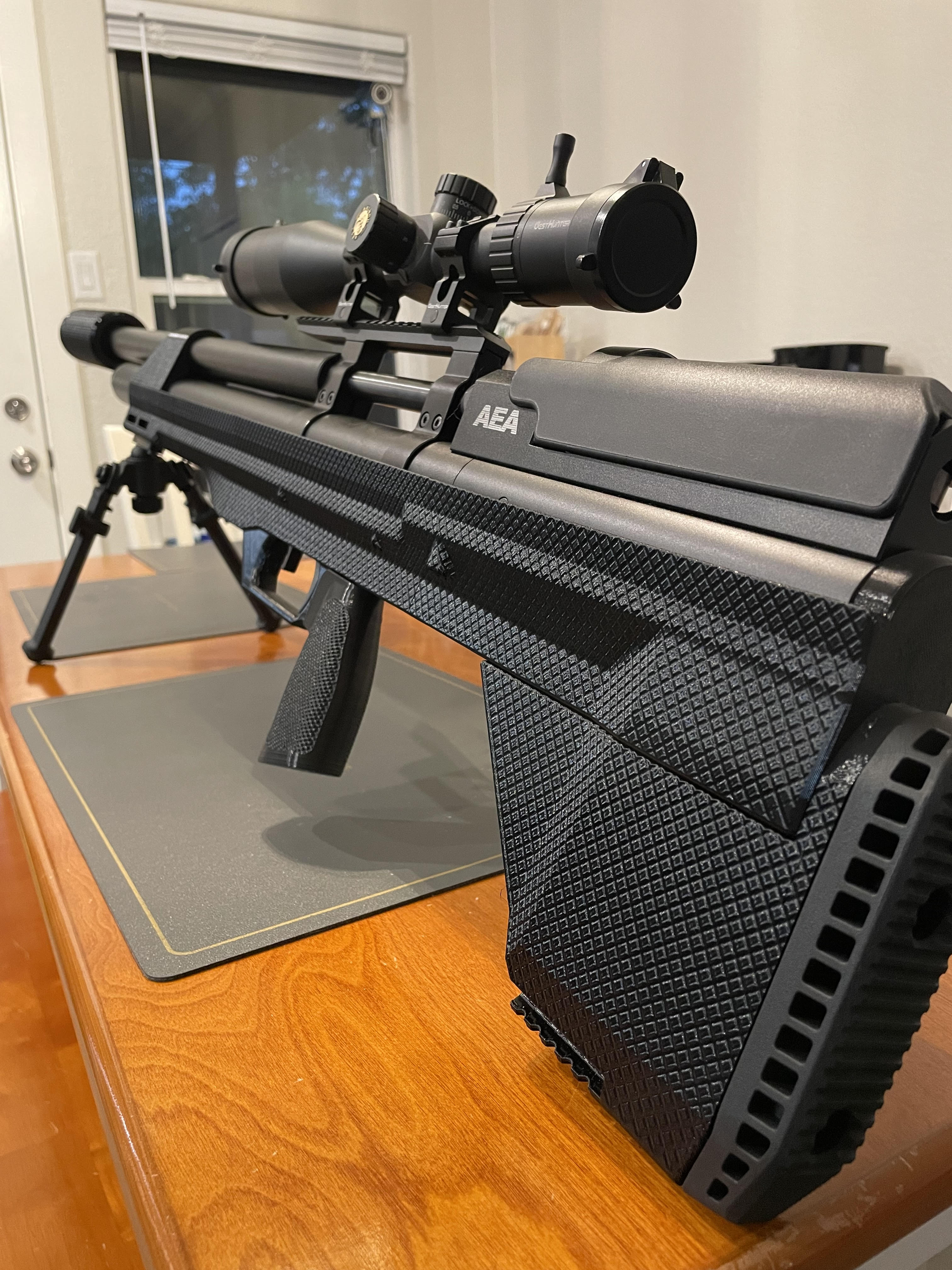

Here's a recent picture of my .457 and my .30View attachment 503487View attachment 503488
Beautiful. I’m not big into bullpups but the 30 is looking handsome as hell.
How important is having a magazine vs being single shot to you?
I would prefer it to have a magazine for sure. Semi isn’t that important to me though but a magazine helps. Ironically I have been trying to decide between the talon p and the Rex p lately even though they are both single shot lol

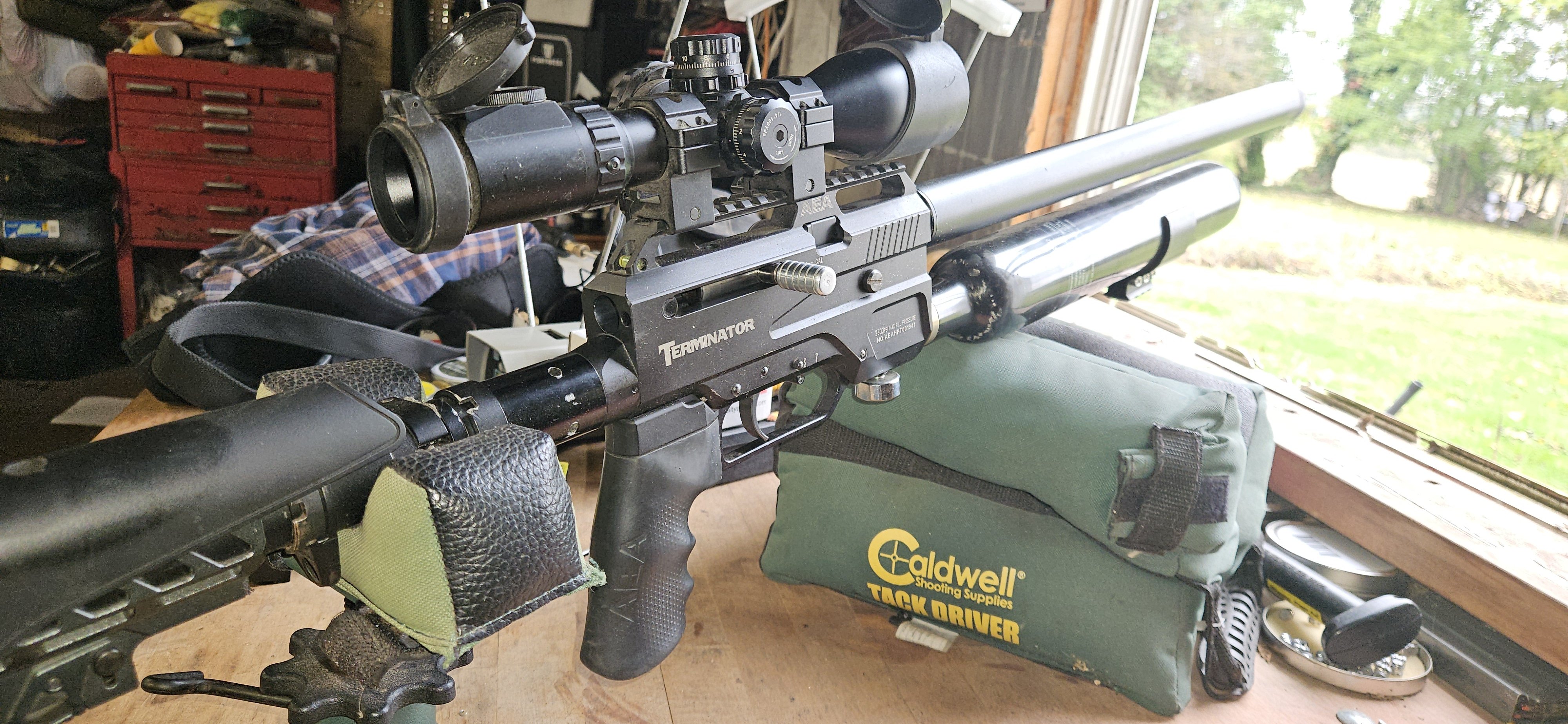

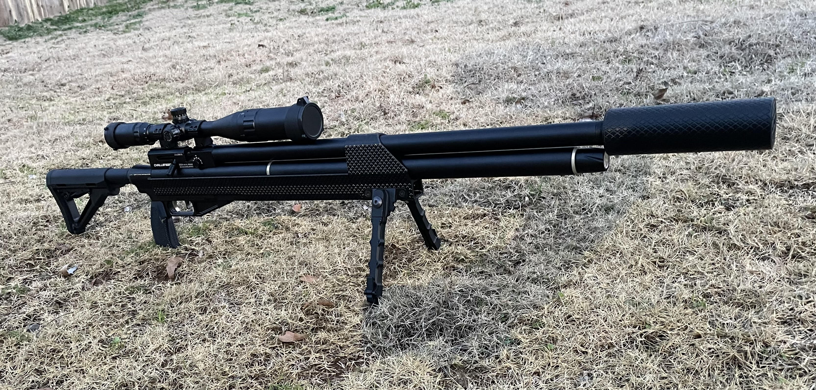

I have a semiautomatic AEA .30 Terminator. It has worked flawless since day 1. Bought it through Bintac and it has upgraded dual tanks (850cc). Not the most accurate rifle I own, my Niksan Ozark holds that title, but for shear knockdown power it is a monster. Pushes .30 48.50 Grain Hatsan Vortex Strike at over 1000FPS. Damn thing will rattle your teeth when you fire it. Which is the only detractor, tough to fire it multiple times on target.
I have a feeling that those above with the heavily negative views are working from aged data. I know a couple others that have AEA semi and bolt actions that are just as happy with their rifles as I am. I am quite sure those views were valid at one time but from what I've seen AEA has solved most of those quality issues.

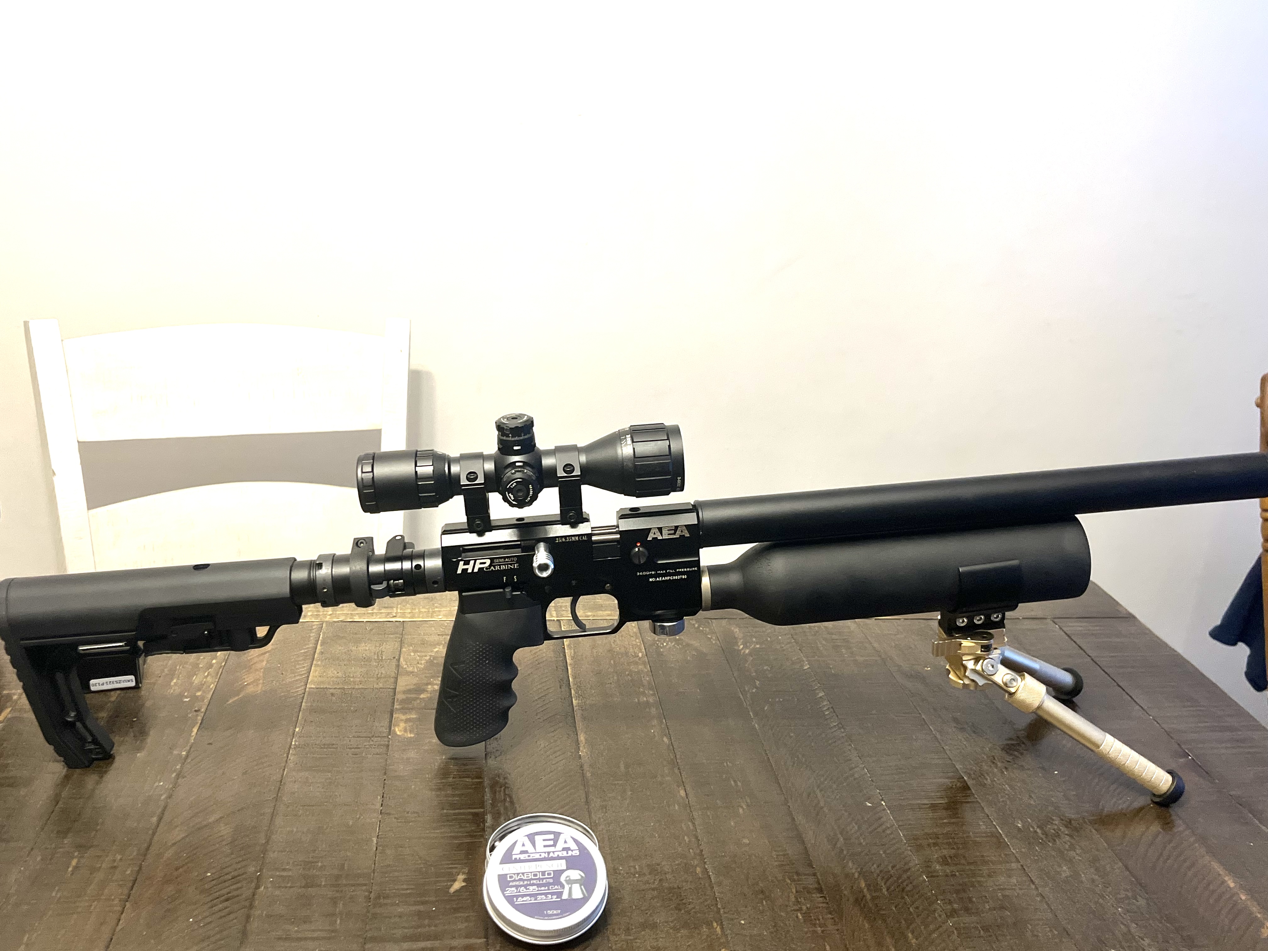

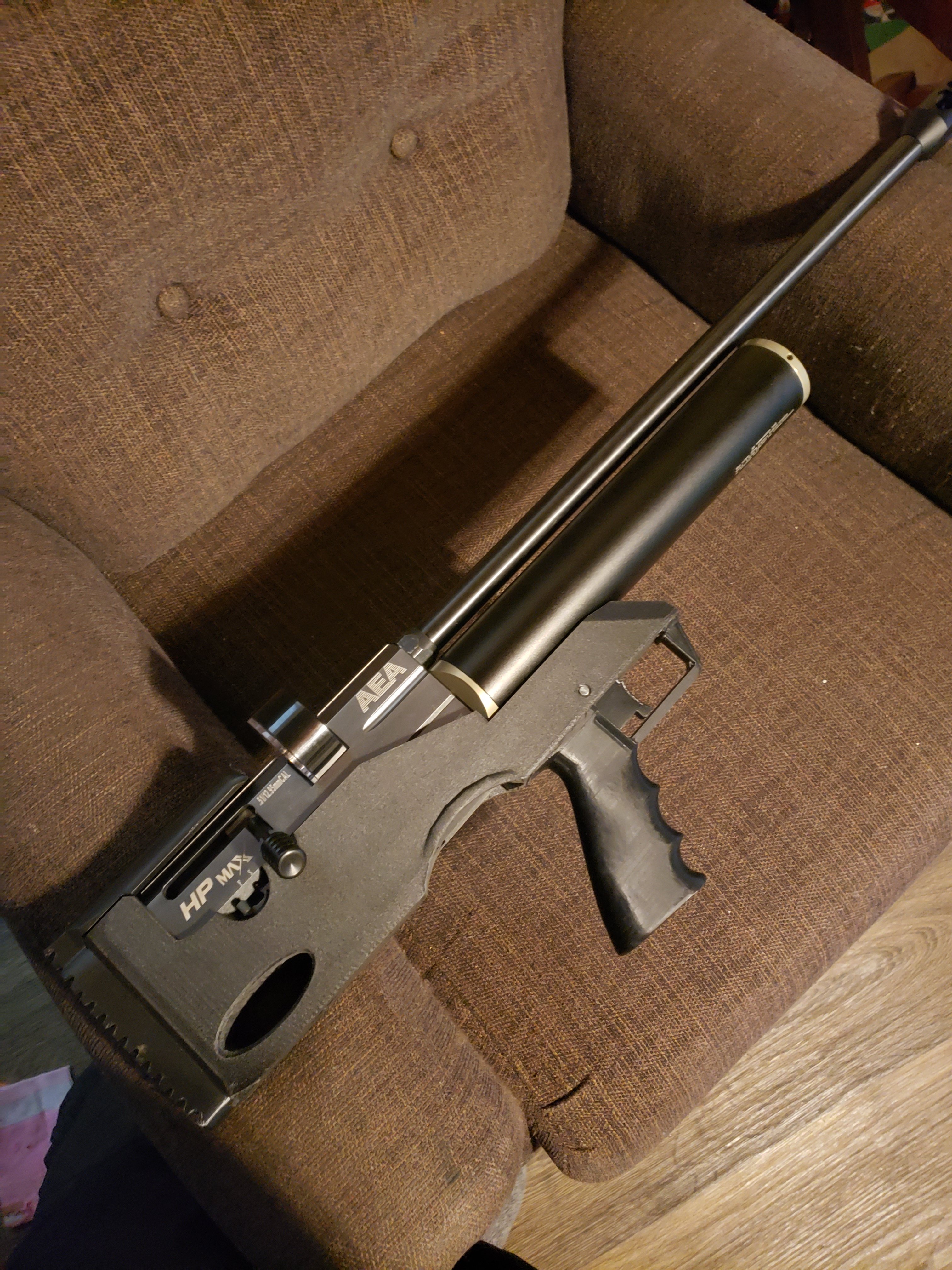

This is my HP max .457 that started as a .510. Could not get it to group with 10" or 22" barrel. Bought a .457 barrel kit and it shots so much better. I have a HP max .30 that is very accurate. Fingers crossed no problem.View attachment 503482
Sounds like you've got a bent barrel. I had two .510 barrels (factory and replacement), both were bent. But I made them better, and finally the groups were there. Not the greatest shooter, and shooting conditions were not perfect (freezing temps, wind gusts, shooting from knee), but 2 MOA @ 100 is real. A proper bench setup in summer weather would do 1 MOA, I'm sure. And now Huma-Air makes a proper regulator for this gun!

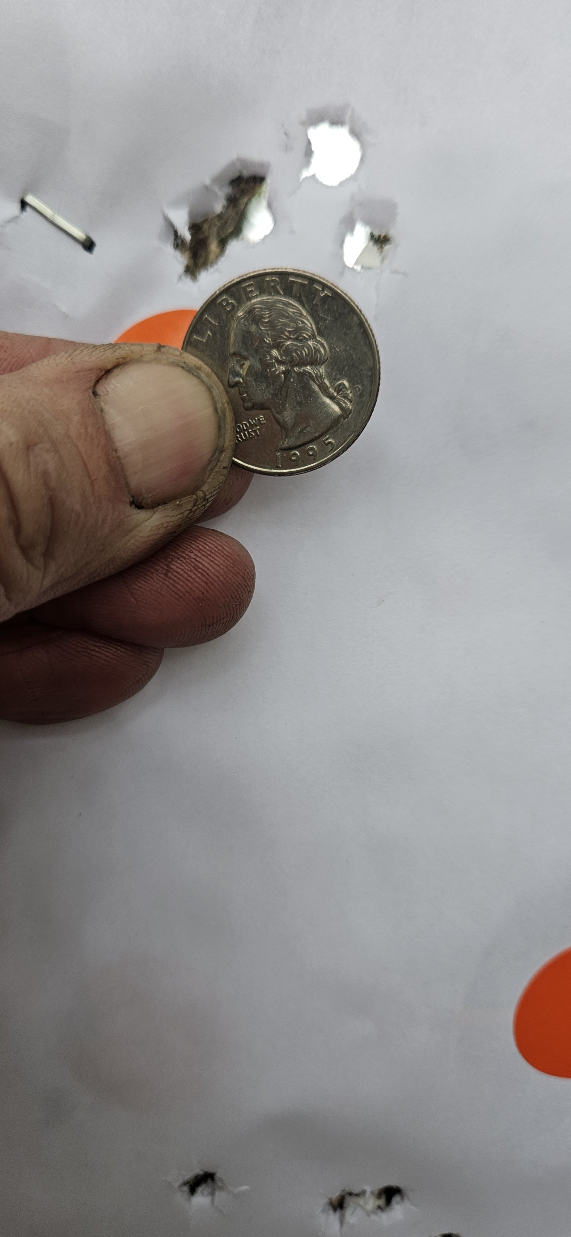

Matt my Terminator had ok accuracy but I had a FX 50.2 pellet recommended to me. Getting 965 fps out of it and at 50 yds shoots this type of group. I shot this group just before starting to type this result. You might want to try FX 50.2 grain pellets. The bore on the 30 cal are .303. I was shooting .303 NSA Slugs but the FX 50.2 gave much better accuracy. You might want to give them a try.
Not too worried, matter of perspective, half dollar vs dime. I really only use the rifle for Raccoons and they are much bigger than a half dollar. Tough buggers though, nailed them center chest (upright on two legs), knocked them over and had them get up and run a ways before I could get a 2nd shot lined up.
