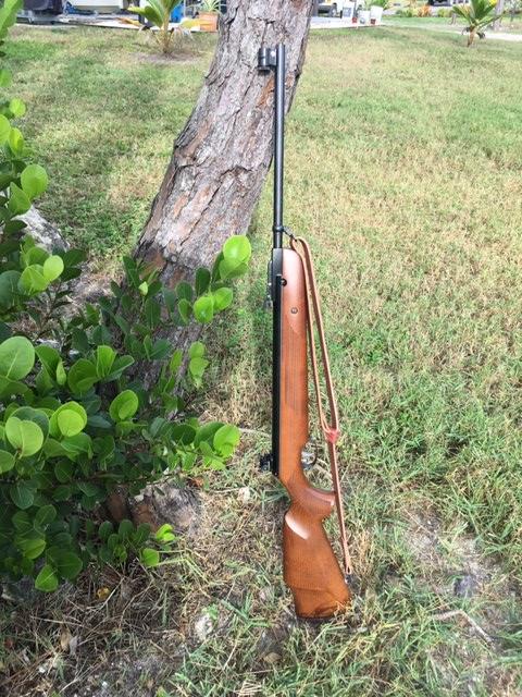

I have a HW95 and was wondering what open sights are available for HWs and what others are using.
I have 2 Williams sights equipped with adjustable aperature. For front sight I have tried at least 20 different inserts. I didn't expectmy favorite insert would be a "plain ol'" conventional blade. I especially like the one that is skinney and taoered to a point. I set the point at 6 O'clock on the bull and hit center. I mostly shoot a 10 Meter pistol bull aat 50 feet offhand in the basement. Instead of using a spoting scope, I have a video camera on the paper bull and monitor at off-hand location.

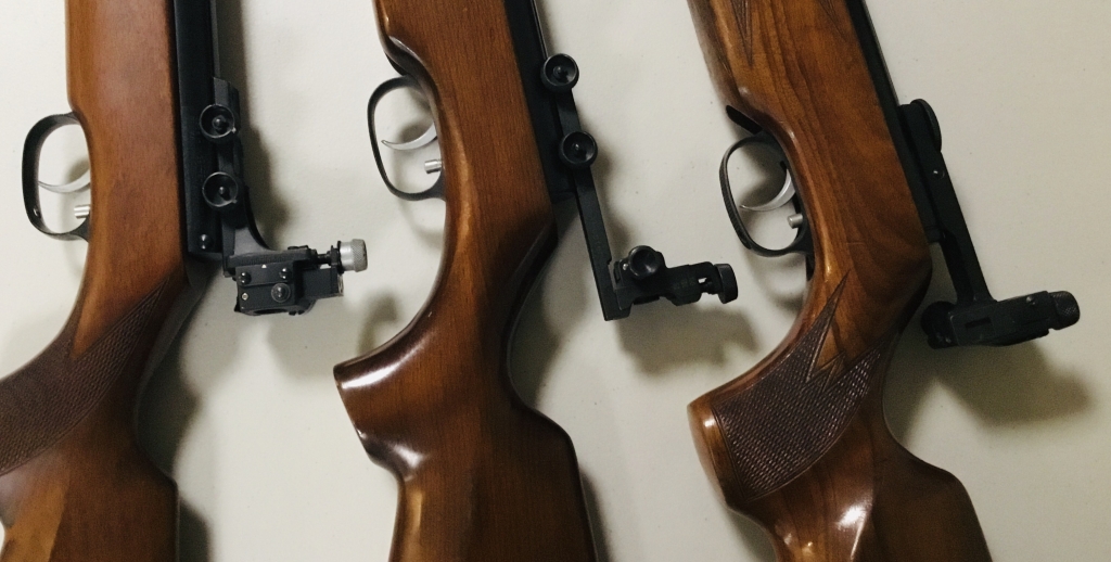

Bad photo, but shows match sights on three Weihrauchs. Left to riight, an alloy Anschutz on an old HW 50, a steel-body Anschutz “Universal” sight on another 50, and an old HW sight on an HW 55 target rifle.

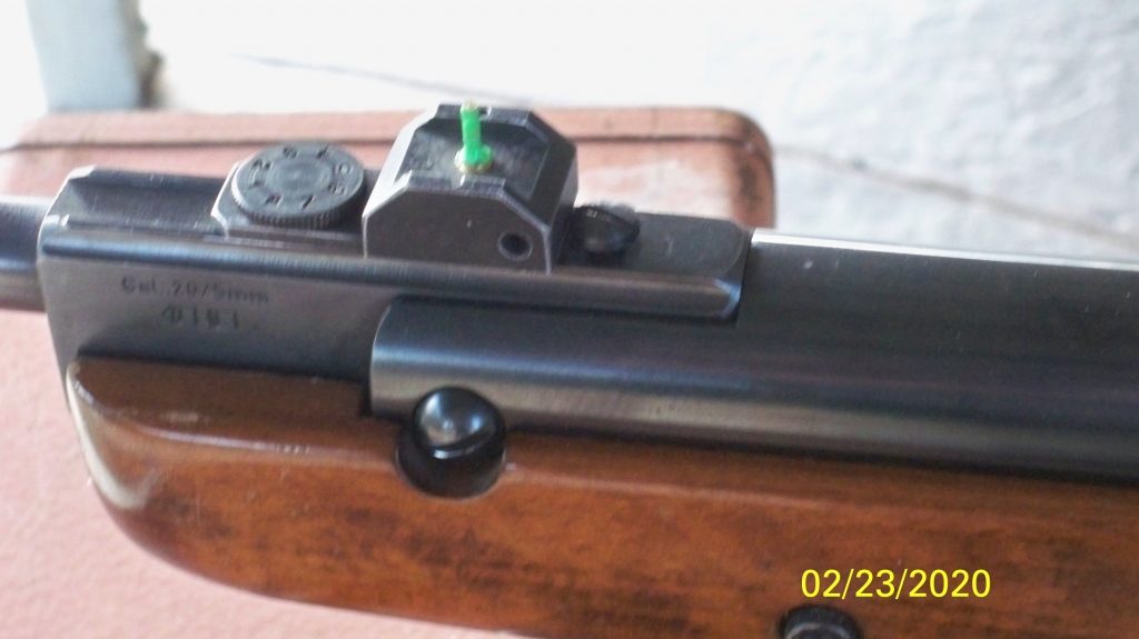

I've been using a Williams Foolproof with dovetail mount for quite a while. It has .093 aperture but I remove it and simply center the front post through the aperture opening. Similar to selection on an M-16 with carry handle. A dab of florescent green in the front sight and good to go. You may have to remove the back sight but that is an easy fix. But like the guys said. The Weihrauch sights are awfully good, and hard to beat.
