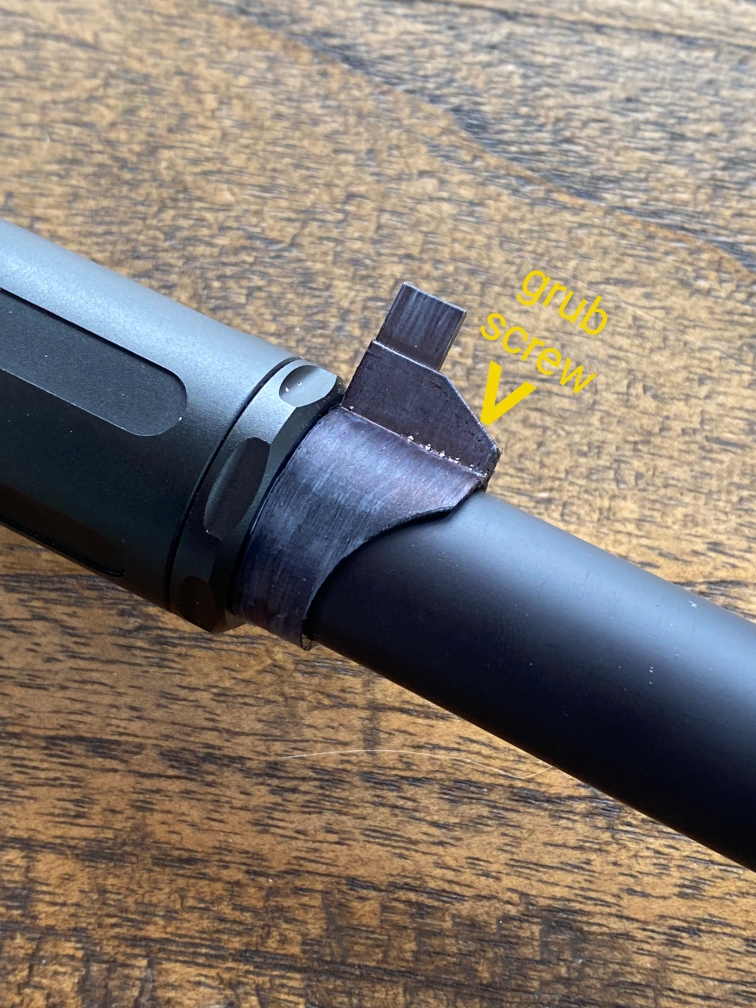

A guy made a 3d printed front and then maybe clamp on rear or peep could work out ?
Here's a pic of the 3d front he made for a gun to go irons on .. ( nice job I thought)

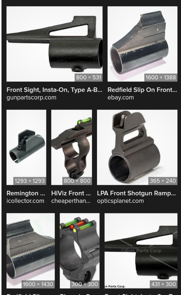

Maybe a store bought may slap on ?

Check the aa front rails at ant supply.
One of them may slip right on and just add the globe ..
