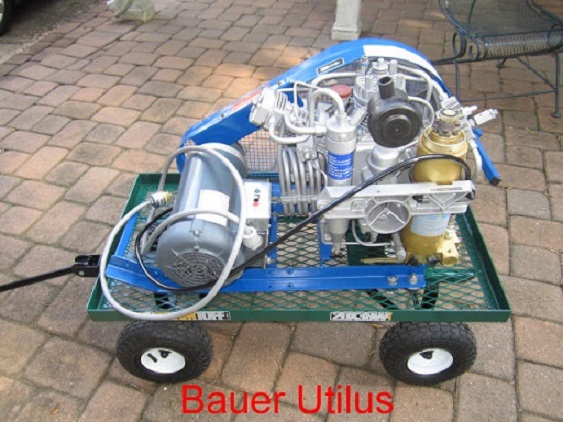

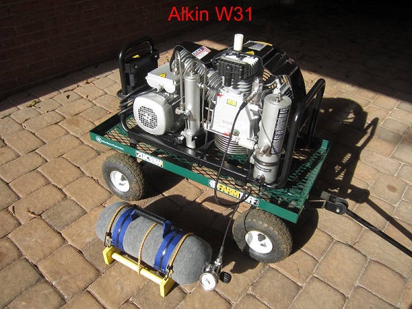

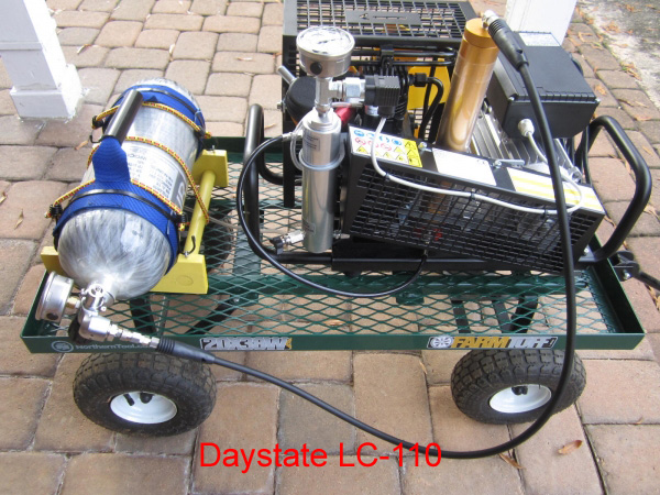

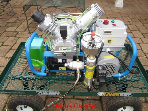

My interest in PCPs began 18 years ago. I've bought and sold countless air rifles and lots of air tanks over those years. During that time I've owned seven compressors and sold the first six without ever having a part fail that couldn't be serviced at home. The first was an FX motorized pump in a box that could only fill rifles directly to 3000 psi. It was replaced by a Shoebox Max then a Shoebox F8.
The rest have been 4500 psi dive compressors shown here. I noticed while looking through photos that they were all mounted on the same yard cart. Each is shown in its order of purchase. The first was a 20 year old Bauer Utilus which I used for 3 years then sold to a paintball field. They use it to fill a bank of storage tanks. It was replaced by an Alpha-Carette compressor which ran trouble free for 2 years. It was sold to upgrade to a Daystate LC-110 used during the past 2 years. I missed the heavy duty Bauer Utilus 220V unit so I upgraded to a new Alkin W31 three months ago. It is well made and seems to have the same build quality as the older Bauer. I feel confident that my compressor trading days are over. The W31 is a pleasure to operate and should last a lifetime. It effortlessly fills a 6.8 liter tank from zero to 4500 psi in 20 minutes.

I am very happy with the Alkin. It filled a 6.8 liter tank for me from empty this week in 20 minutes. The cooling coils on the output side were barely warm to the touch. A $3100 Alkin W31 is much more solidly built than the $4400 Bauer Jr. II. I purchased a 20 year old Bauer Utilus that is no longer made but its replacement sells for $8000 bare bones and is no more compressor than the W31 which includes more standard features.
Both are top of the line brand name compressors. Alkin wins on value for the money, hands down. The U.S. Navy thinks enough of Alkin to use them on warships and to supply air for the Navy Seals. That's good enough for me and better than any brand I've seen other than Bauer. You might also consider Arctic compressors if you want a U.S.built compressor that has quality and durability. I have no personal experience with Arctic but know they are priced well above an individual hobbyist's budget.

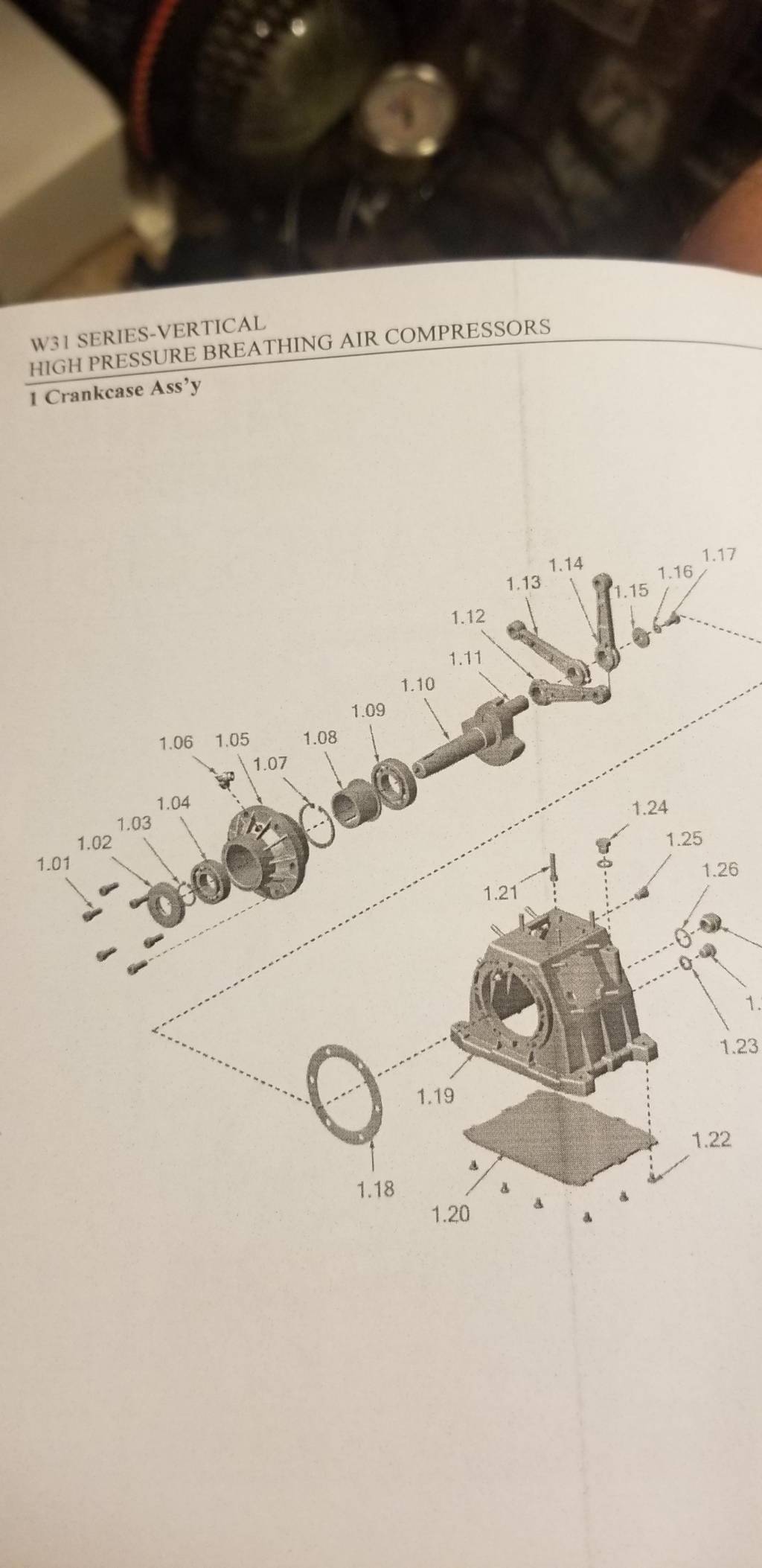

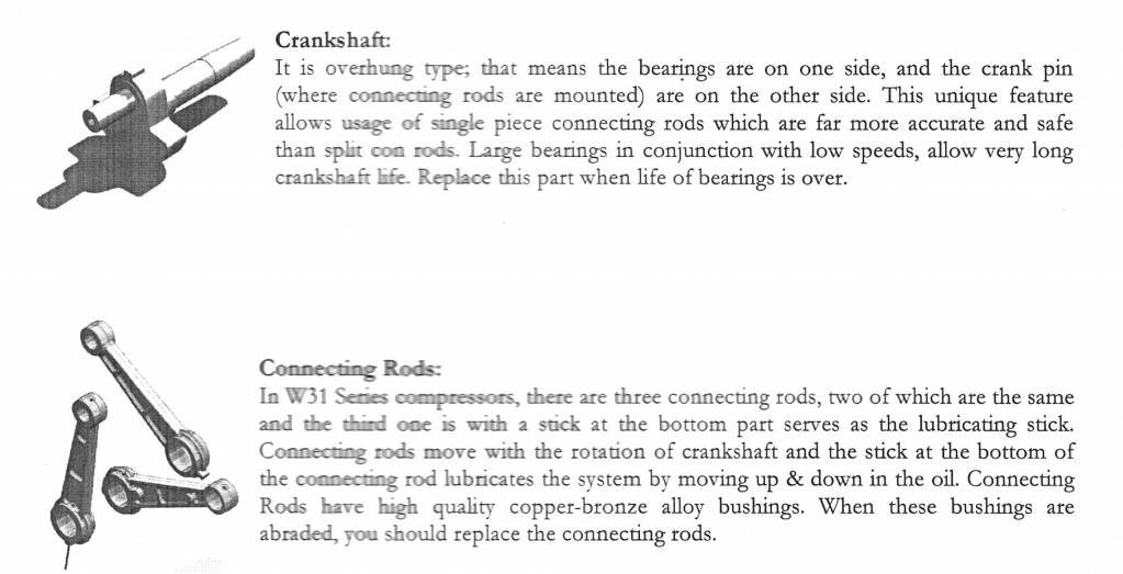

The W31 crankshaft is an overhung design. The reason it's not supported on both ends is to allow one piece piston rods and bearings to be slid on from one side. Here is a description from the owners manual. I'm not worried that this is a problem to be concerned with. This thing is built like an Abrams tank. It will outlive me for sure.
I liked the idea of the low RPM, long stroke Alkin W31, but that requires some design compromises. The Coltri MCH6, using a shorter stroke and higher rpm, has the crank supported on both ends, AND it has the one piece connecting rods. The Coltri is a four stage compressor vs the three stage Alkin.
I looked at reputation/specs/price/availability of both the Alkin W31 and Coltri MCH6. Both seemed to be good compressors but I went with the Coltri.
