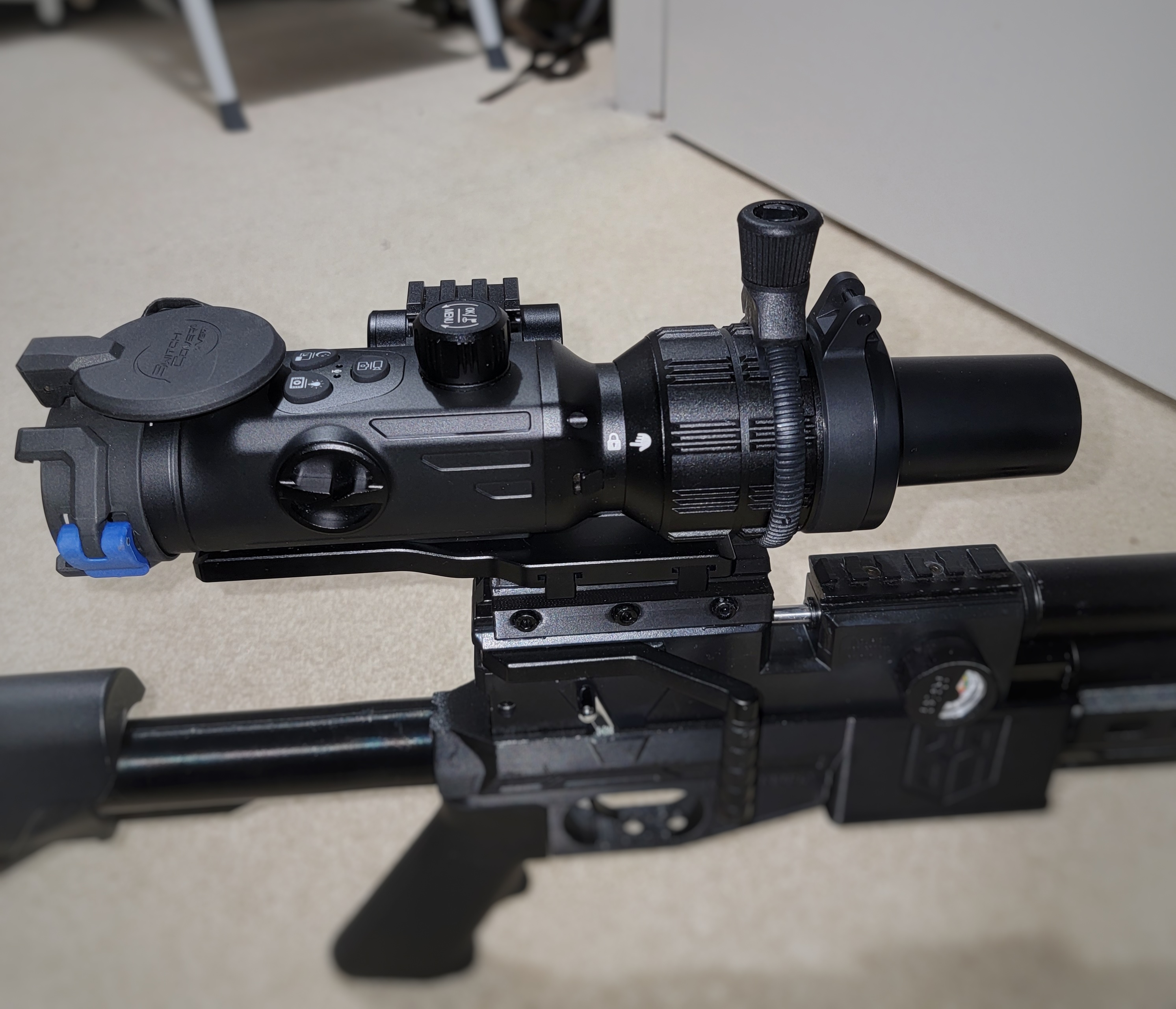

I don't see anyone talking about adding throw levers to the zoom which sometimes is hard to turn. Going to try out the fishing coasters idea using as a throw lever.
