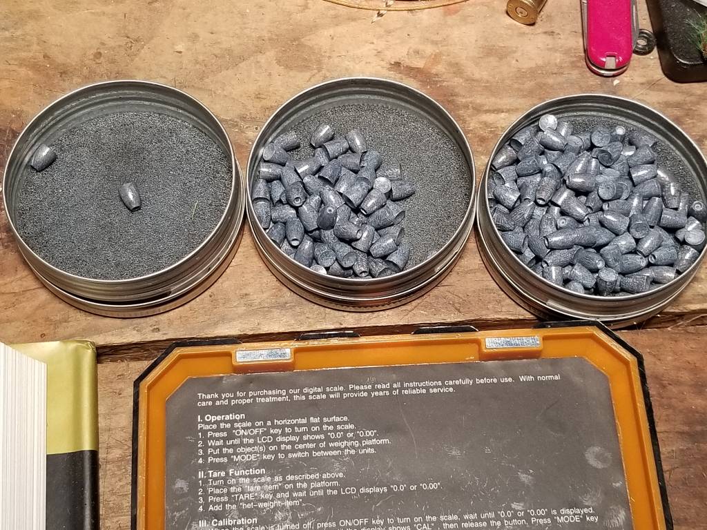

One tin of H&N 23 gr .218 slugs weighed
On my digital scale. Left, 23.0 middle 23.2 right 23.4. I've drone this many times, always with pretty much the same ratios. All weights shoot well for me, though 23.2 has the lowest extreme velocity spread.
Actually, I have used a rim size gauge with good results. And I started weighing the H&N slugs because I didn't have a good way to check diameter. Can't say for sure whether there is a performance difference, but I have seen tighter ES with 23.2 grains. From a previous lot. In a previous lot, 23.0 and 23.2 dominated, and 23.0 grouped tighter. I did not however compare the ES of the two.
Anyway hats off to H&N for such consistency, with 99% of a tin within 0.2 grains, and 100% within 0.4 grains.
