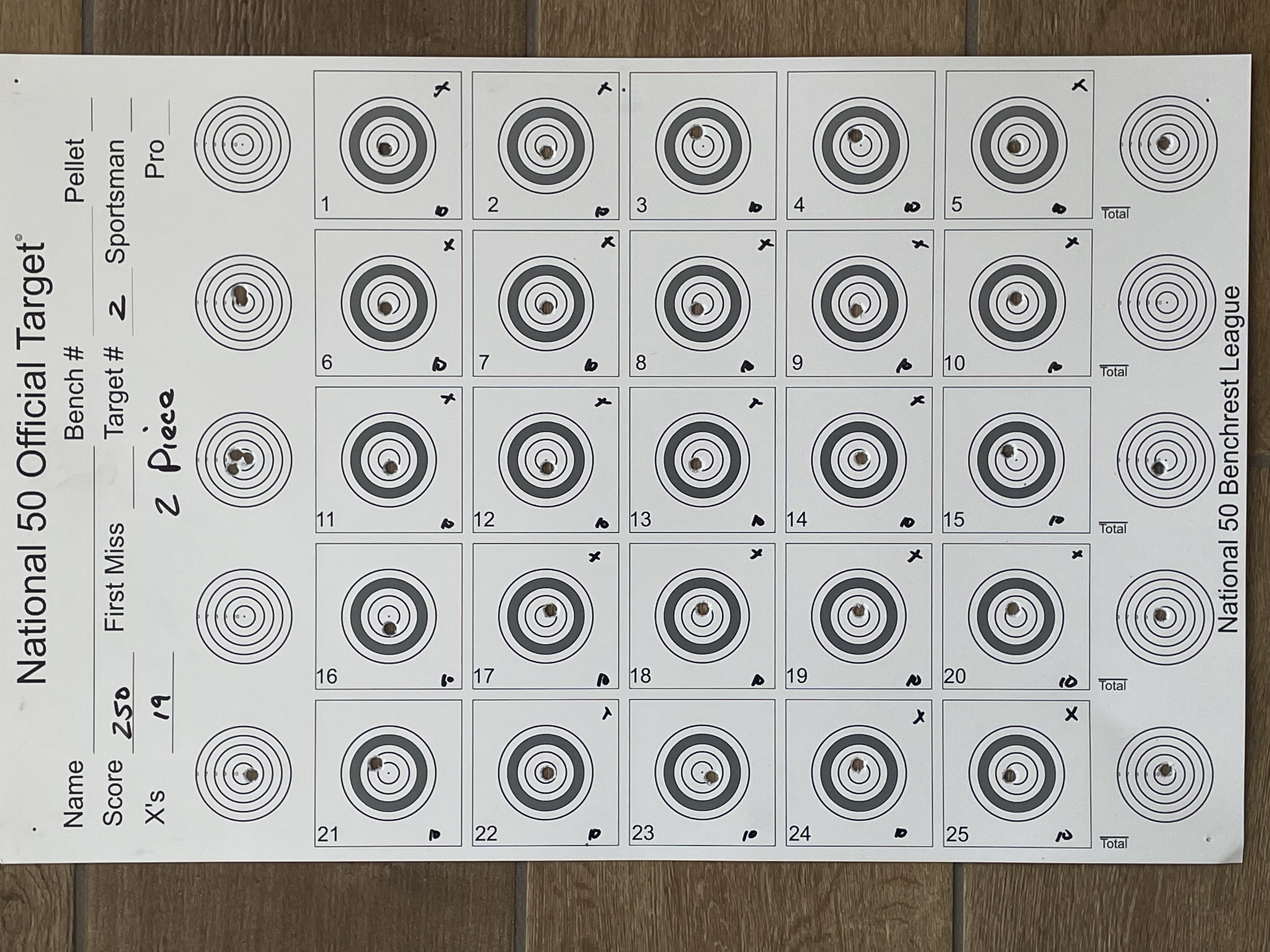

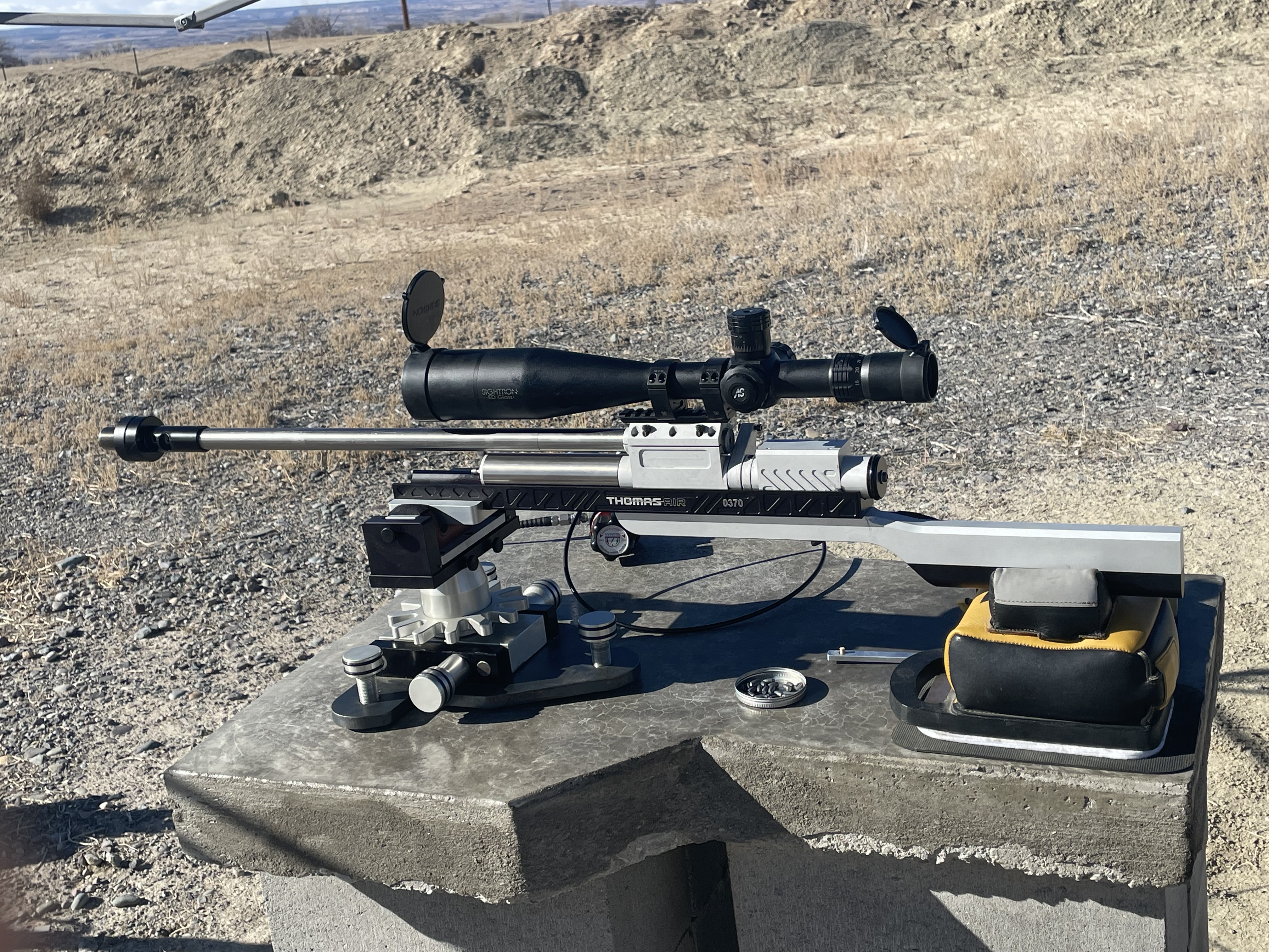

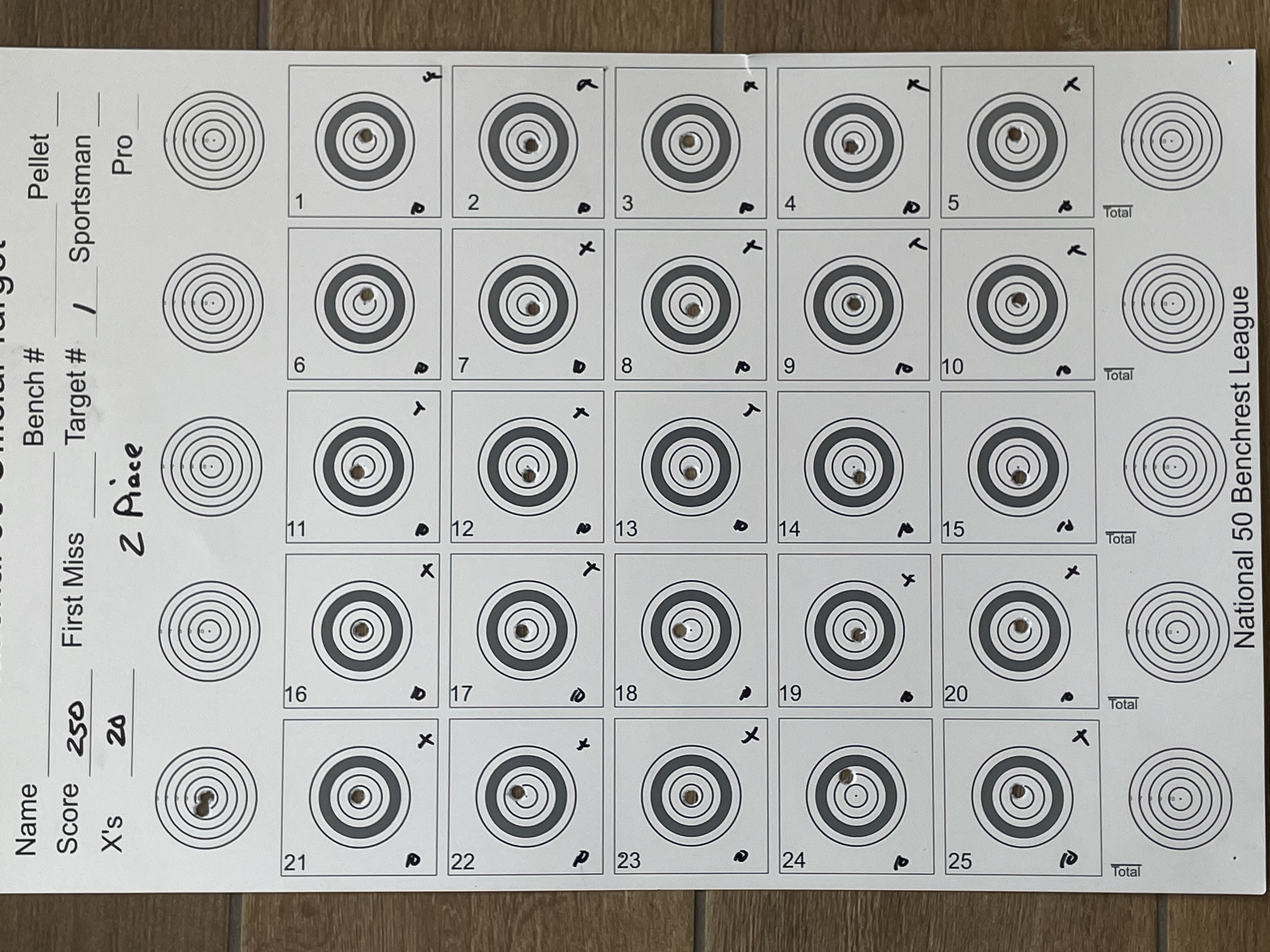

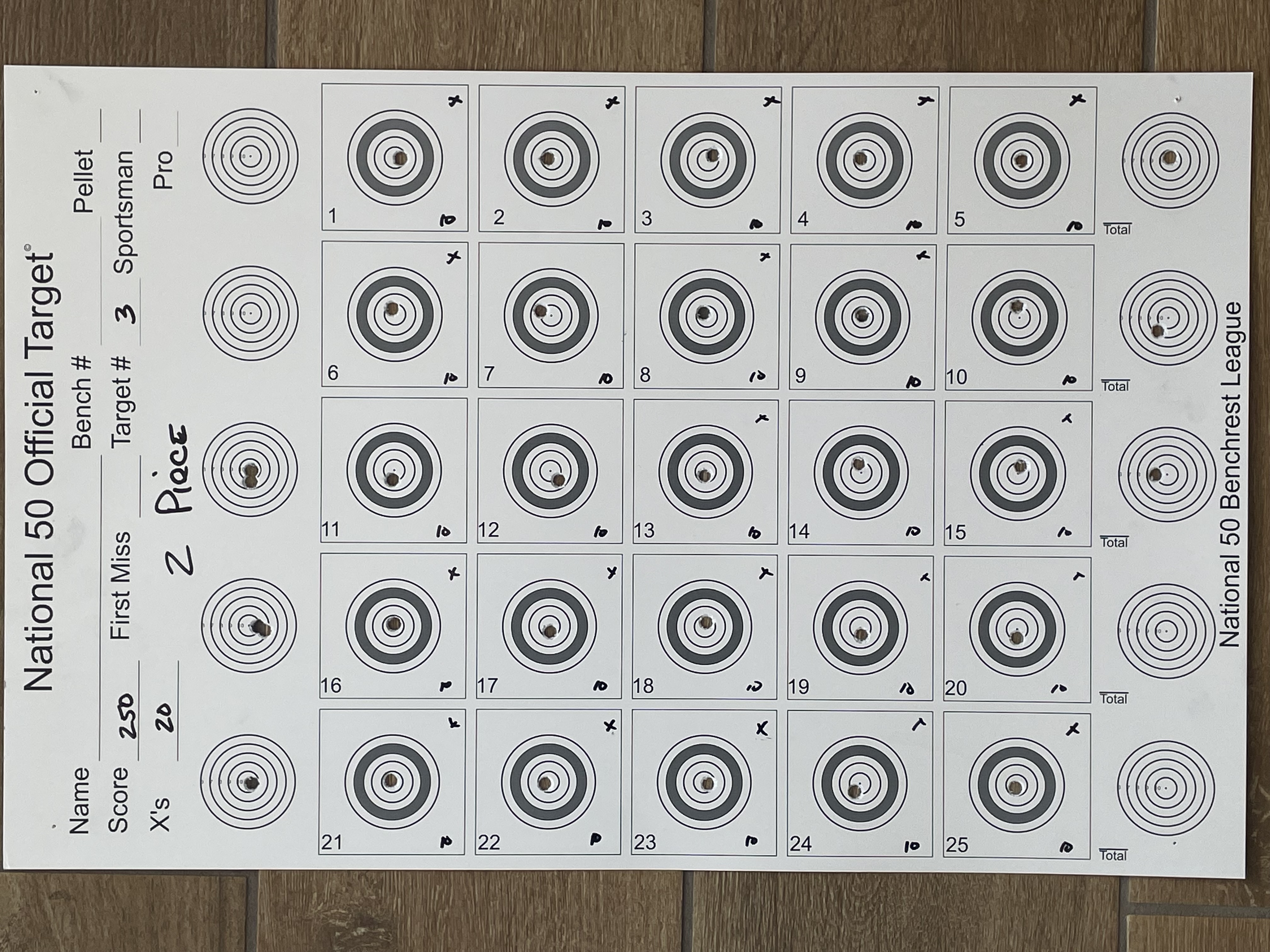

Shot 6 cards this morning with the intention of seeing how scores compare when using a one piece Randolph rest with sandbag top and a typical two piece setup with mechanical front using same top and a rear sand bag.

I'll post the 2 piece in a minute.
The 2 scores differences are pretty insignificant. Despite the two piece posting a slightly higher x count...it may just as well be a little lower next time around. The one piece is like having adaptive cruise on a long trip compared to the two piece just being regular cruise. You might get where you're going a little faster with regular cruise...but you'll be paying more attention to things.

I visually line up the rear bag with the front rest aiming at bull 13 and measure out the distance. You can slide the gun back and forth and watch through the scope to see if it's tracking straight and adjust as necessary. When you put the gun initially in the bag....it will be riding high and may take maybe 10 shots before it bottoms out and stays put. Once it no longer moves after taking a shot...it's packed up. I don't let that happen. I lift the rear of the gun and set it down lightly after each shot to keep it from packing. Once it's packed you can get odd vertical shots. This gun is long enough that I don't see any torque issues at 50y as long as I center it up before I begin.
It's a felt and rubber spacer under the bag. Just to lift it up.

Do you think the x count could be higher just because your paying a bit more attention?
No, I doubt it. I haven't found that telling myself to really focus or concentrate an extra amount will produce a higher score. I think the scores are representative of the average that this gun and shooter can produce....and if enough cards are shot the average will reveal itself.
Overall, I don't see that a one piece rest produces a tangible score advantage. That is an observation based on years of information....not just this particular test. The only advantage I could possibly see is if a shooter just doesn't know how to set up a two piece correctly .... or is just sloppy with its use. My one piece with hard supports is way more fussy about gun position on the rest.

Tommy...it's important to know, right away, that what's good for Rimfire may not be good for air and vice versa. I'm not a Rimfire shooter, so I can't say what they need from experience. I hear a lot of it, though. There are way more things going on in an air rifle that can screw up your shot compared to Rimfire. The strike, valve opening, valve closing, and even the volume of air moving inside the system can massively affect where the slug goes. It's a delicate balancing of these forces that make things work.
My slug gun prefers the rear bag to give a little. When I say pack ....I mean just that. Sand bags can pack up rock hard after a while...especially the ears. I get the best performance if I don't let the ears pack up. Lifting the back of the gun up and lightly setting it back down will keep the ears from packing up and becoming hard.

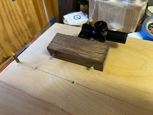

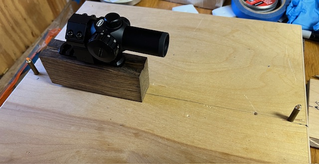

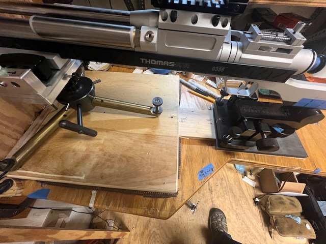

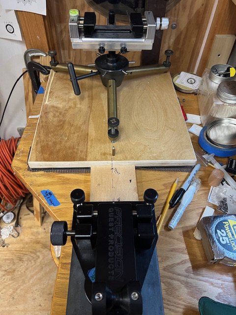

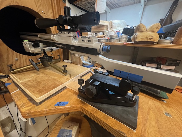

This thread got me thinking about how I can increase the speed of benchrest set up with my equipment. What I am going to post may not be relevant to most, but with the type of front and rear rest I have this has simplified getting my rifle on the center of the target with the front and rear rest in very good alignment. I have a front rest plate that adds mass and lessens the recoil wiggle of front rest. My front rest sets into detents in the plywood top. (Below the plywood is an attached 1/4" steel plate) So position of this sandwich plate is the first, and most important set up step. My dilemma was getting the plate (and thus the front rest and rear rest) positioned to be 90 degrees to the target and oriented so that the with the windage adjustment (on the rear rest, not front) when centered would put me right in the center of the target.
I made a simple way to do this buy using a indexed block with a small red dot scope mounted on top. Within 7-10 seconds I set the front plate and position the red dot to target center. After that I put the front rest in the detents in the plywood and then use a spacer block between the front and rear rest. I can achieve 1.5" L or R of center every time at 50 yds. The spacer block also allows repeatable placement of the rear rest to the rifle stock. It is quite simple and quite fast. I have used a one piece Randolph rest in the past , and they are excellent, but currently do not have one. So I have found this rest combination to be very adequate. This rear adjustment rest only allows for so much horizontal movement, so It's important to get the rear rest centered L to R as well as centered on the target and this set up procedure is fast and fool proof. I might add that I also use a smaller 3/8" steel plate under the rear rest .....this plate also has detents in it for the feet. (I don't like to fool with a rest halfway through shooting a card)
