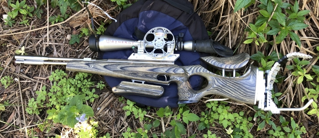

One of my first loves...TX200 MK3 .177
Just got the GC stock on May 28th Thursday. I was able to shoot it at my club's FT match on Sunday May 31st. I ordered it on January 8th.
Nice stock, congrats! Ordered in the middle of the pandemic, you're a brave man.
All things considered, that's not bad considering Gary & Jane were subject to a 7 week lockdown and just recently were able to return to work.
That’s a beauty. Gotta love those GC stocks.....worth every minute of the wait time. Here’s my HW97 with Sightron III 10-60x50 hydro dipped in brushed aluminum and mounted in a GC ambi FT stock
What a treat Donovan, to see another one of your exceptional build projects! It looks great, and in your hands will shoot great, too.
Curious as to what's under the hood🤓
The tune was done by Motorhead for the original owner. When I got it, it was shooting JSB 8.4 at just over 13fpe. I modified the spring by grinding it a bit and then polishing the ends to a mirror like finish....now shooting JSB 8.4 at 11.2fpe....very smooth shot cycle. I installed a Luke Jolly modified Rekord trigger with Rowan set back trigger blade that breaks very crisply at 8 ounces. I now need to put in the time to be as competent with it as I would like to be. Any word on your triggers?
