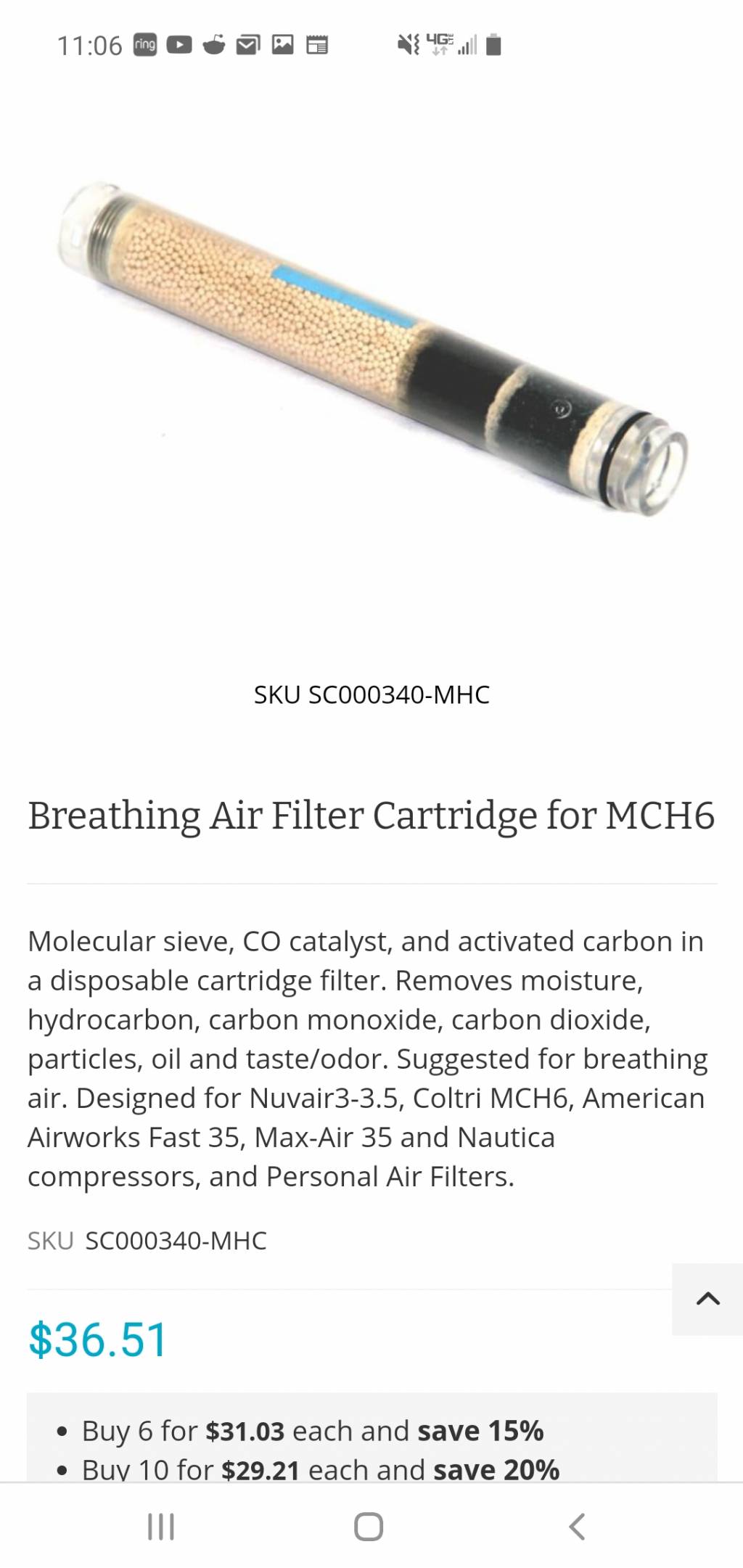

Thanks for the info on this, do the beads change color when they need replaced or is it a one and done purchase?

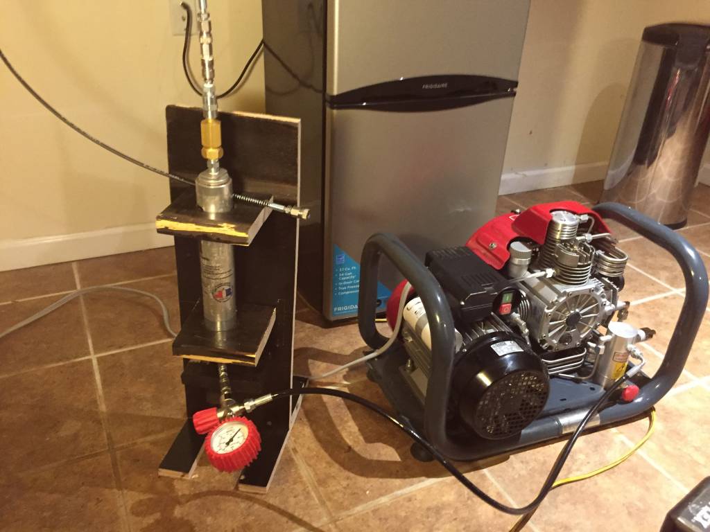

Looks decent. You wonder how much moisture is also in the air tank and compressor
There is a blue strip on the side of the cartridge that fits into the metal tube. When the cartridge needs changing, that blue strip changes colors ----> to pink, I was told. However, I changed my insert cartridge when the blue strip had changed to grayish-blue.
I live in a high-humidity area and the cartridge lasted ~18 months.
