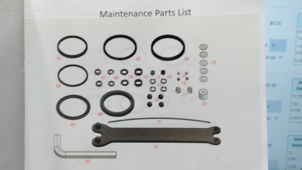

Here is a picture of what the manual says I get in the rebuild kit
This is what I got minus the burst discs and delrin bleed valve seal I replaced
I agree with bdzjls. Get in touch with Todd. He is the tec. Knows these compressors inside and out. GREAT guy. Gives you straight answers. I assume the phone number is his cell. If not I can hunt it up for you. That way you can go directly to him and not through AOA's phone system. Your rebuild kit is different then the one I had. But my compressor was one of the first ones out. sylvan Good luck
