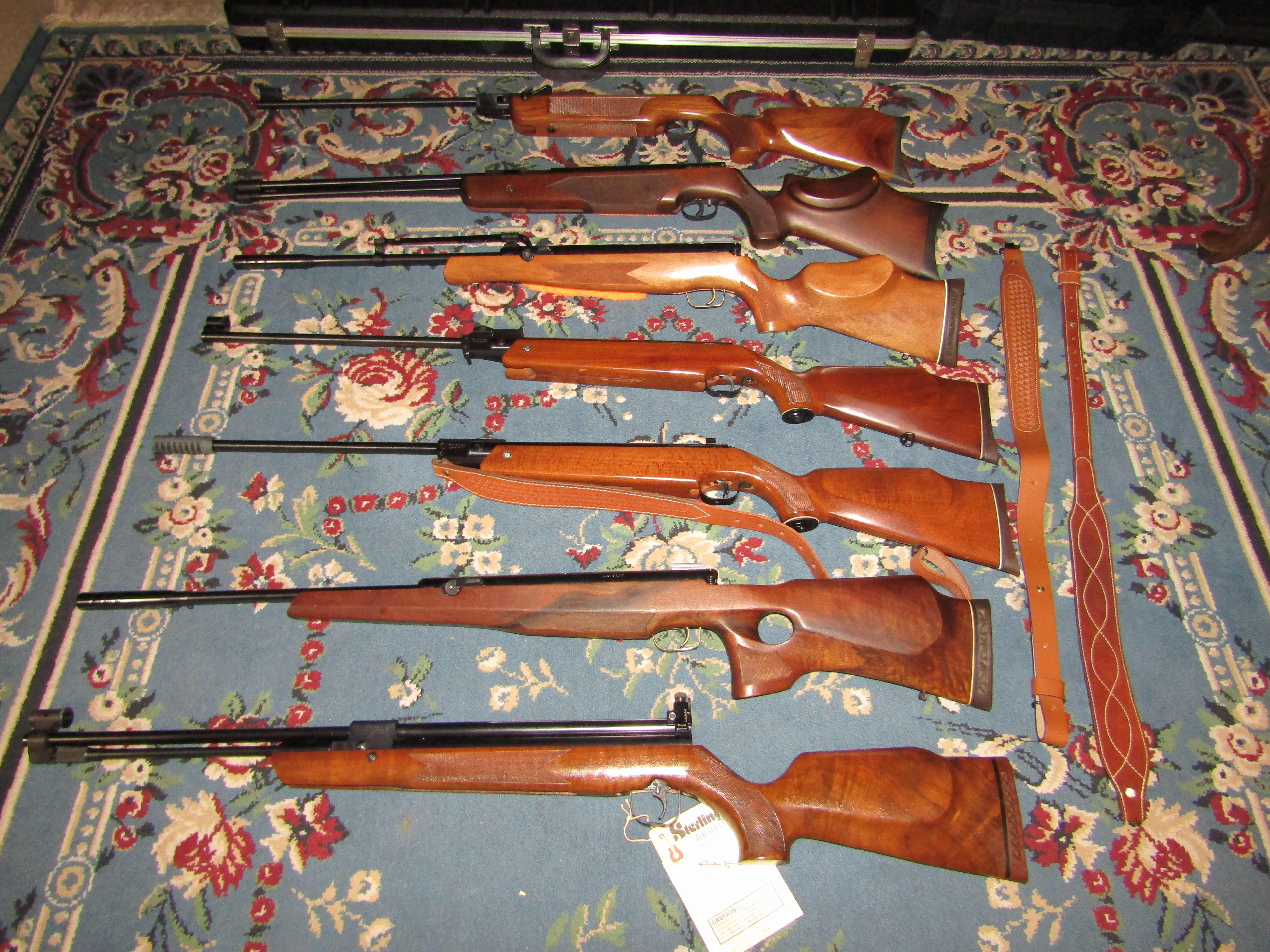

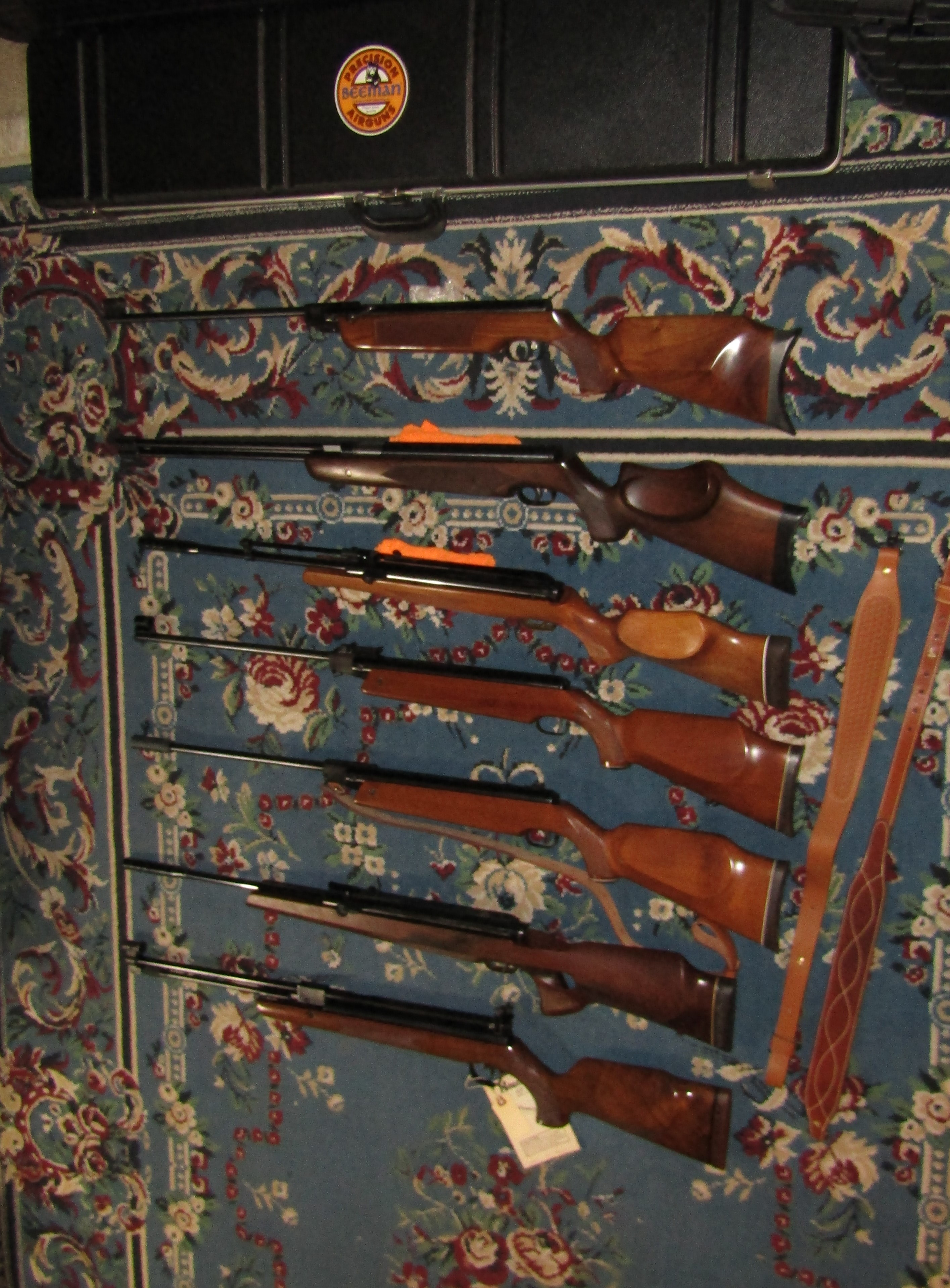

the photo is some of the ones I was talking about. The slings and scopes have not been mounted. The original diopter sights are wrapped up in the box and/or cases with the paperwork.
DO NOT shoot unless you plan not to sell . As you know unfired is a big item in collectables
The FWBs are definitely going to need rebuilt. The piston seals are likely a sticky crumbling mess by now.
The Weihrauch 77 is probably fine, unless it's "super tuned" and packed with that goop they used which is probably dried out. Piston seal is fine, the breech seal is likely smashed from sitting forever.
The Weihrauch 55 very likely has a leather seal. Some careful oiling through the transfer port with whatever oil you believe in will likely have it doing well.
The others I don't have firsthand experience with.
Reactions: dpauld
