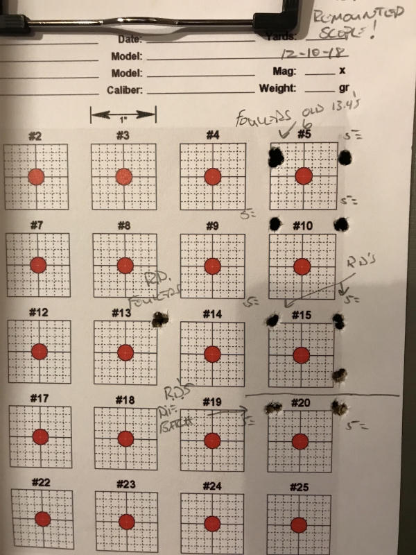

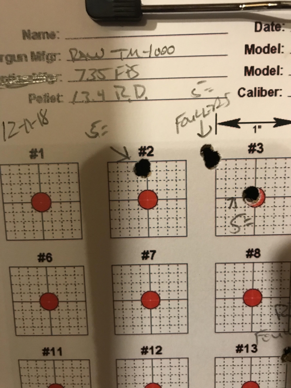

Thought I would post pics of some preliminary groups with old & redesigned jsb .177 13.4gr monsters first pic. Shot w/BM-500, indoors @ 16.5 yds, you will see a fouler group followed by 3-Record groups for each style of pellet- also note the groups @ bottom under drawn line are RD’s from a different lot but same head dia? (All RD’s 4.53 head dia.) next pic I decided to try them “RD’s” in my TM-1000 W/ LW-12 groove barrel, these shot @ 735fps?... I did not adjust Regs or hammer springs on either gun the BM-poly barrel was shooting the RD’s @ 790fps this doesn’t suprise me from either gun considering my previous chrono results.
I've tried both in my LW Poly barrel and it definitely likes the older style better.
