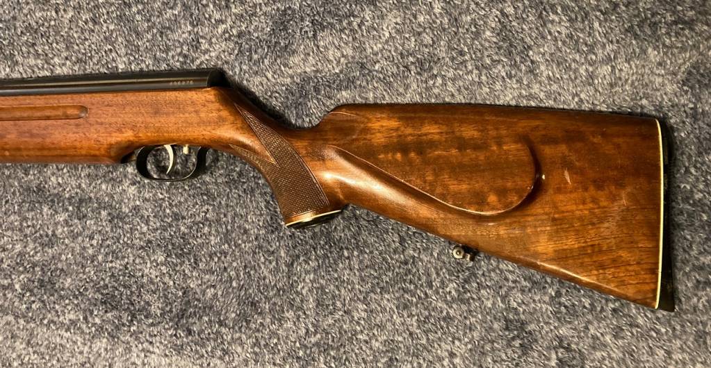

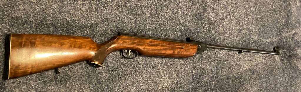

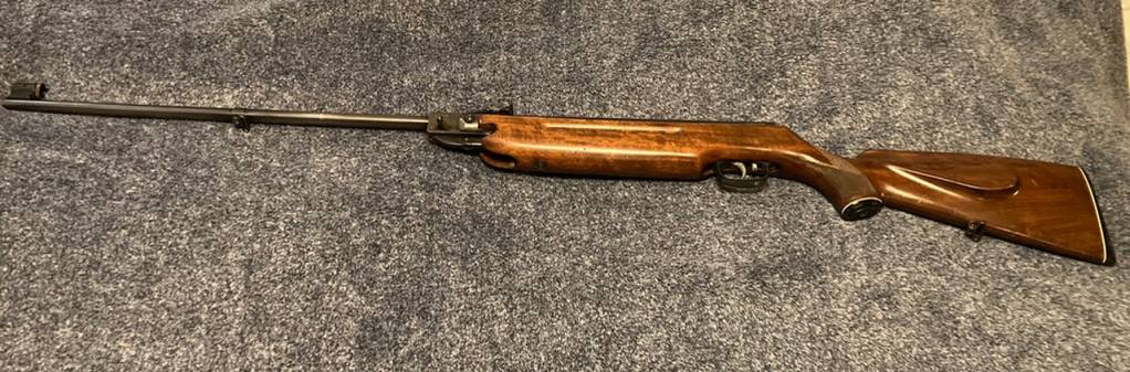

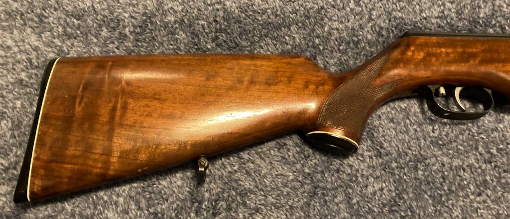

Recently picked up this real nice 1973 vintage HW 35 at a local gun show. This rifle sparked my interest to get into airguns
