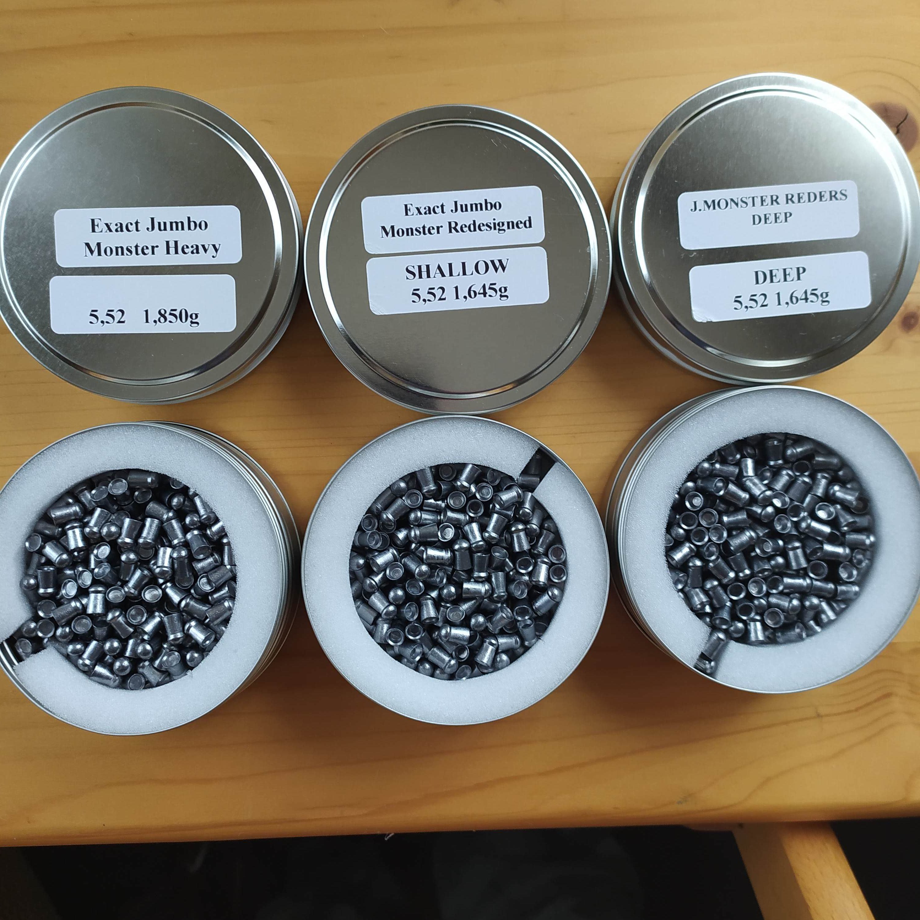

I've only been shooting PCP airguns for about 2 years, so I'm catching up on the various .22 caliber JSB 25.39 pellet designs. And I recently saw a post about the various .22 JSB 25.39 pellet designs and redesigns that I can't find now, so here is my question in a new thread...
From what I understand, there is the current 25.39 MRD in .22 that started production in 2022. They are currently called the "redesign." And then there is the older 25.39 that ran from 2019 to 2022. And then there was the 25.39 design that were in production prior to 2019. So, there are 3 versions that I think are being referenced...
2022
2019
pre-2019
And then there is the post from someone representing JSB (or a JSB distributor) that said JSB has been listening, and that they are going back to the 25.39 design favored by benchrest shooters. But which favored design are they talking about? The 2019 design or the pre-2019 design (which I've never seen). I guess this old, favored design should reach the U.S. market in about 90 to 100 days according to the post I saw?

I'm happy to report JSB will be ready to ship the old style MRD in about 2 weeks, which means we'll have them in stock in the USA in about 100 days. They will have a new unique label and have extra packaging protection, as it was the thinner skirts that were damaged too often that made them go to the thicker skirts several years ago. Anyway, stay tuned and keep on the lookout in about 3 months at your favorite retailer.
But still not sure which "old style MRD" they are talking about.

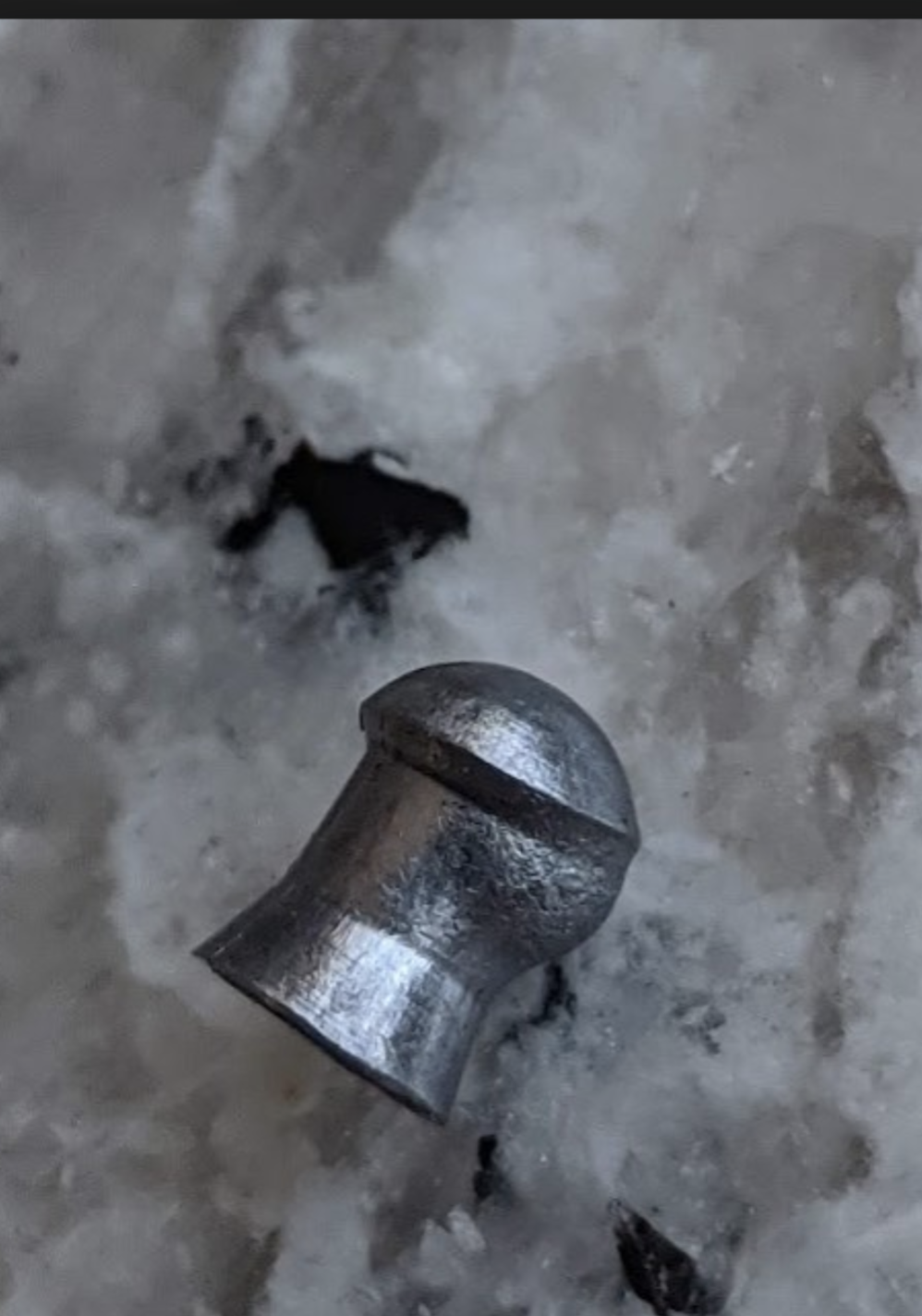

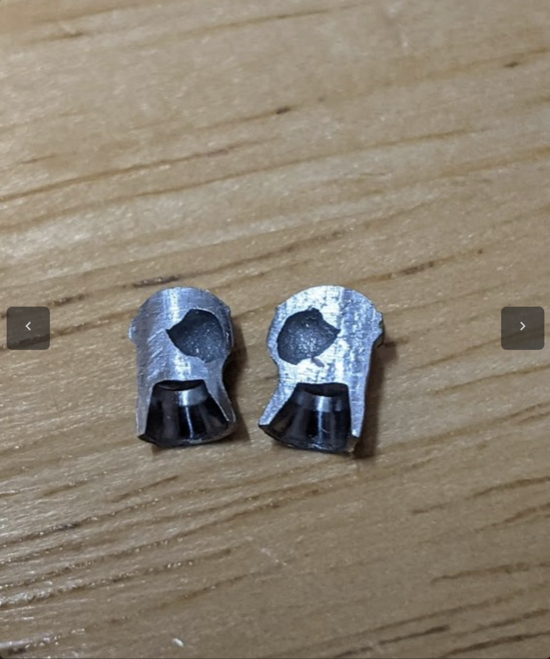

A couple mentions of bubbles and porosity......
This is from a while ago, and not a .22 Monster RD, but makes a guy raise an eyebrow for sure.
A JSB (FX) .177/10.34, in all its glory...
I knew I had read about it before! Thanks for the refresher. I recall some online source indicated that if the smelter had high humidity the result was hydrogen separating from the water/steam and causing bubbles in metal. The one you cut open is an extreme case but surely it’s not as uncommon as we may think.
-Marty

Wow! That is very interesting indeed.
Almost impossible to explain!
My understanding of the pellet production process is that the lead is melted and extruded into long continuous wire.
You wouldn’t expect there to be bubbles in it, but I guess it is possible.
The diameter of the extruded wire will contribute towards determining the pellet weight.
The wire is then stamped into a ribbbon which has balls in it. Each ball of lead will become one pellet and thus the weight of the ball will determine the weight of the pellet. If they stamp bigger balls from thicker wire, heavier pellets, thinner wire equals smaller balls and lighter pellets. The ball, with their pre determined weight are then “smashed” or pounded or compressed into the dies. Because lead is so soft it will conform under pressure to the shape of the die with out needing to be heated, softened or melted.
Well that’s my understanding of the process anyway.
So how the heck can you account for a cavity inside a pellet…? Well there must have been a bubble in the ball/wire…? Ok.
That’s plausible.
But there is no way to account for the bubble expanding AFTER the ball of lead has been cold pressed/compressed into the die and mounded into the shape of a pellet…???
I’m at a total loss…???
Someone enlighten me 😃
Air is a compressible fluid. Once the pressure is released it expands back to its previous volume.
You know, like how airguns work.
Most likely! My guess is that the wire had a compressed air bubble, which expanded when the lead surrounding it became thinner in certain point as the pellet was shaped. Thin enough for the air to finally bulge out.
-Marty
