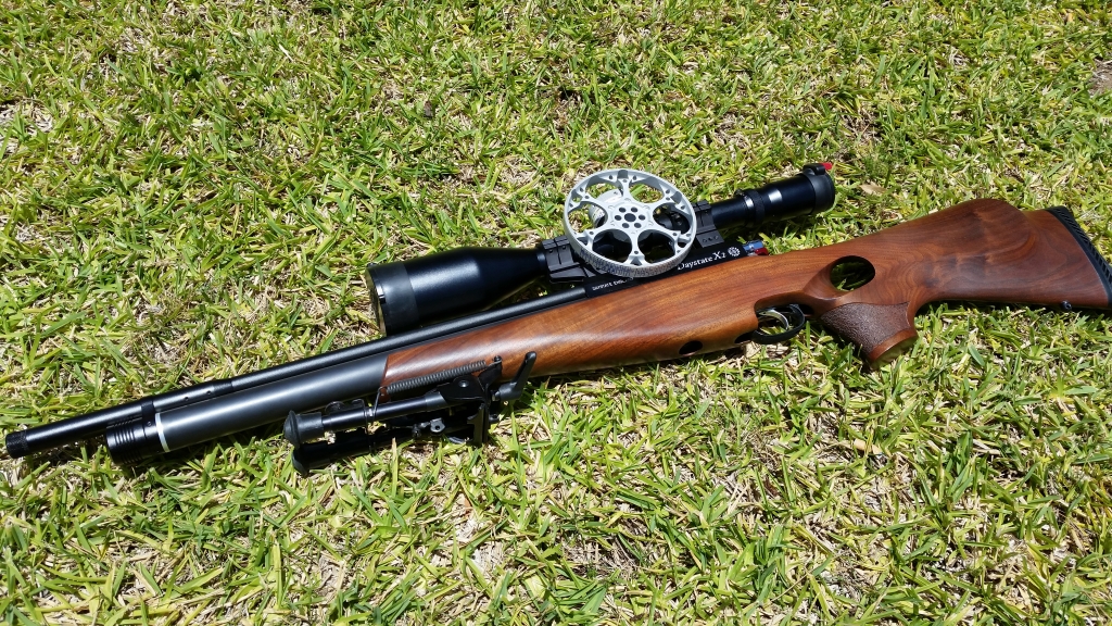

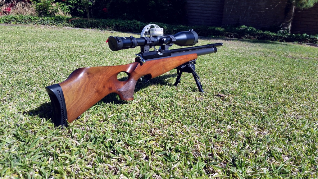

Heck yeah they are, older Daystate’s Rock 🤘 I have a 40ftlb version X2 Prestige in my collection. Fantastic rifle! I bought it new in 2004 from AOA, it was my first Daystate that I ever bought. When I was looking and trying to decide on what I wanted and could afford I waited too long and found out that they discontinued the CRX, and I missed out on one of the last CRX-ST’s they had 😭. I was uncomfortable with the electronics on the new MK3 so I went with the X2 non regulated model.
I have never had a single issue with it, it has never leaked, never changed POI on me, I still use my clicks that I made way back then. 50Y accuracy is outstanding and so is 100 yards. The build quality is excellent Older Daystate’s do take some getting used to, they have a heavy hammer and are a little hold sensitive but once you figure out what you need to do they will give you the accuracy you want.

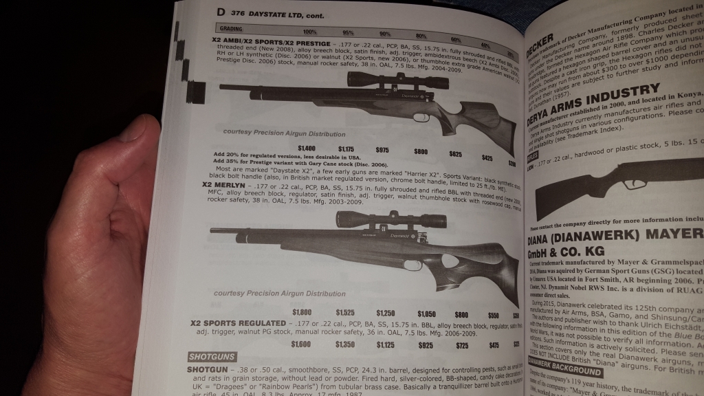

Yo’s advice on the pricing is a little off, I took a picture of the blue book pricing “12th edition” to give you an idea. And before anybody says anything, no I do not think that they bring what it says in the book for that model but a clean solid gun probably could be found for $700-800, more of course if it has a factory Gary Cane stock or the condition is near perfect.
Blue book is fine but my comment was what the market would actually pay. Yo!
