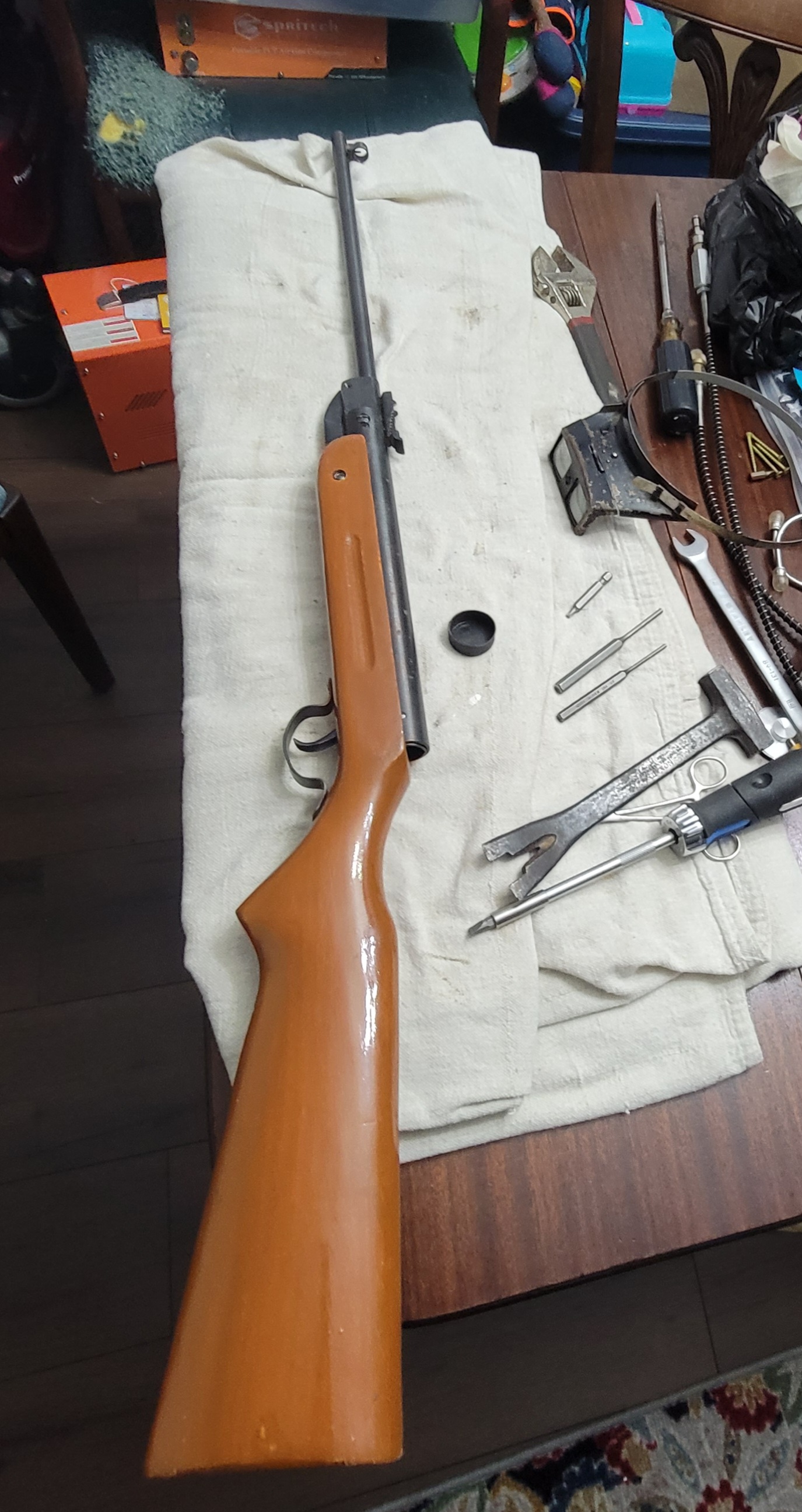

Other Old $25 chinese crack barrel.

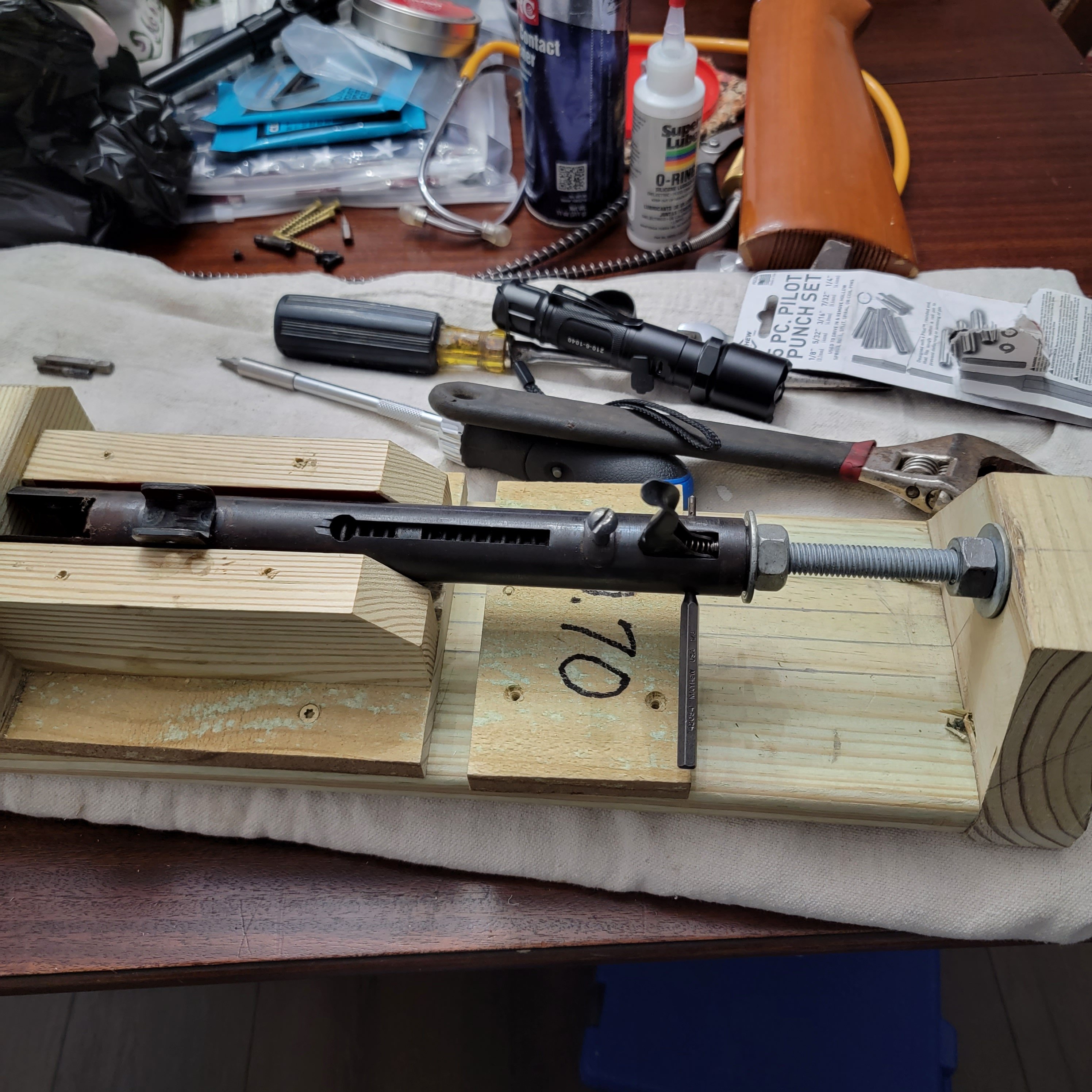

I'm attempting a sear repair on this guy.
It's designed to be able to lock the spring with the stock screw allowing access to the sear.
The trigger is stamped tin with a hard metal inseart in the sear area. The stamped metal was bent there causing it not to engage. I hammered it back into shape on the anvil.
I'm sure the problem will reoccur down the road.

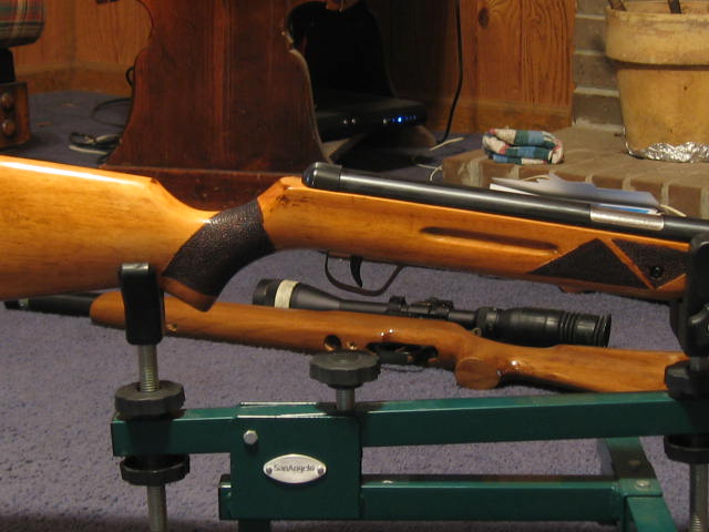

It should last, with occasional repairs. Had the old leather seal "Cummings Tools Truck" $20.00 (and a sleeve of 10 pellets that would blow to pieces 1-2"s from leaving the barrel). Hadn't ever seen one before but needed a rear site and thought $20 for that reasonable. Took it apart to install a synthetic seal & adapter but left it apart for ages.
Did get it put back together and the darn thing shot decent groups at 605fps. Cheap enough to have fun trying things to the stock also.
