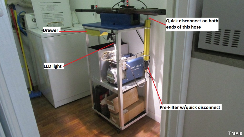

Hello @Clear Fork
Attached is a photo how I have my YH set up. Note the lower second smaller filter. I can unscrew the bottom end of the lower filter and remove the element and replace with a new one. I have been running this set up for about two years and have never replaced the large Tuxing Filter. Every time I open the Tuxing and inspect the element it is perfect color and completely dry. I do replace the small filter quite often so it does all the work and catches all of the water.
I purchased the manual shut off model.
I would think the Royal Purple compressor oil will be OK. Be sure and change the factory oil within the first 2 hours of operating. And be sure to run that oil through a coffee filter to check for contaminates. I actually check all my oil every time just to be safe.
Hope this will help.
ThomasT

Hello @Clear Fork
ThomasT
Good info. Thanks for the picture, that really helps.
Does not come with factory oil. You need to fill it for the first time. Have had mine now for 2 yrs with no issues. Have always from the get go used Royal Purple. As noted, change after the first hour or two of operation. Royal purple has a tendency to turn dark Don't let that bother you.A must is adding a filter like a Tuxting in addition to the small black filter that comes with the compressor to the outlet side. { change filter insert after every fill } if you do not have the hardback model. Would recommend the manual shut off as the auto stop shuts off at 3,000 psi. Don't let the unit get hot. 60 degrees cel. max. Also check the nylon bushings in all the lines as they tend to shrink after extended use that will cause the unit to build a higher pressure than what the gauge on the tank shows causing the rupture disc to blow. Ask me how I know LOL!
