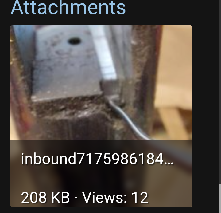

I'm sorry, I should've been more clear. The issue is that the face of the breeh is worn to the point that there's not enough engagement surface in the slot before the metal tapers out toward the face of the breech. While I'm at it, I'll most definitely have a look at the latch and will replace the latch spring. In my mind, a skilled welder, (Lucky for me, that'd be my son) may be able to put a tiny dab of weld right where the metal is worn. From there, I can file a new edge where its worn away. I'm open to any other options however.
Ya.. the picture i was trying to find was showing the receiver face side of the breech area that cut a groove line and at the bottom where the latch chisel "locks" it was well worn there deep notched .
I guess unless your welding skill is surgeon enugh to fill it in right and file it back Factory straight an smooth you maybe looking at a new receiver tube ..

Yup. That's what I'm looking at. Exactly.

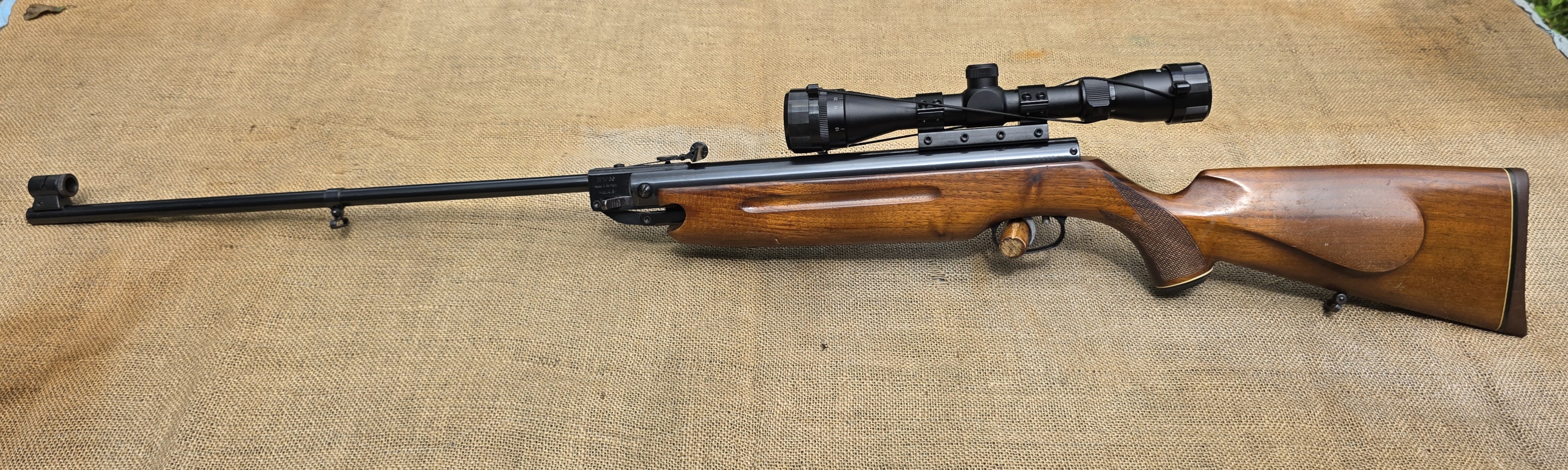

The barrel in the op’s picture almost looks like the barrel is rising upwards as if it was set off prematurely. This could have damaged the lock. Or maybe it’s not the original barrel. I’m sure back then these were hand fitted. Switching barrels could cause this. Like stated earlier this gun looks as if it was not heavily used. Could be just the angle.

The barrel in the op’s picture almost looks like the barrel is rising upwards as if it was set off prematurely. This could have damaged the lock. Or maybe it’s not the original barrel. I’m sure back then these were hand fitted. Switching barrels could cause this. Like stated earlier this gun looks as if it was not heavily used. Could be just the angle.View attachment 578436
Yeah, it's the angle. The gun shoots straight. If anything, a little low, but certainly not high. There is visible wear on the face of the breech at the engagement point of the latch.
