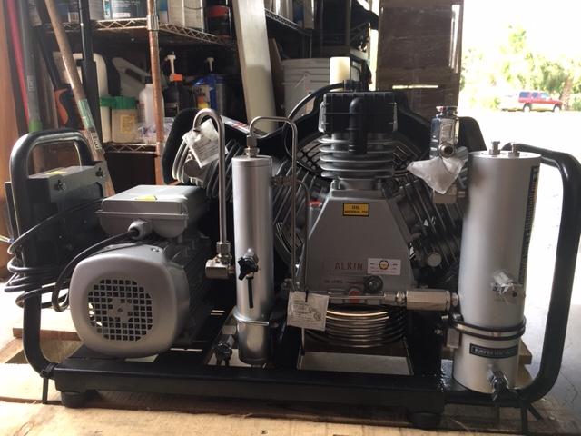

Just to clear things up the Ryobi pump isn't any bigger or have more water flow just more reliable than the one that came with (my) unit. 2 years and never over heated. I also used #30 weight non detergent motor oil ISO 100 as recommended and ran my unit without cuting it off untill my 106 cu/ft tank was toped off 30-40 minutes. It still runs I just desided to upgrade to an Alkin. It cost a bit more but Hey, I'm loving it. 6 minutes to accomplish the same thing without the worries, time or hassle.
