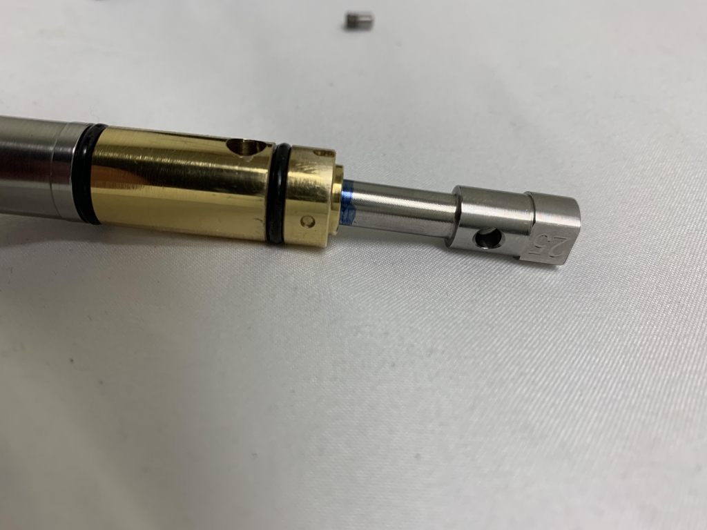

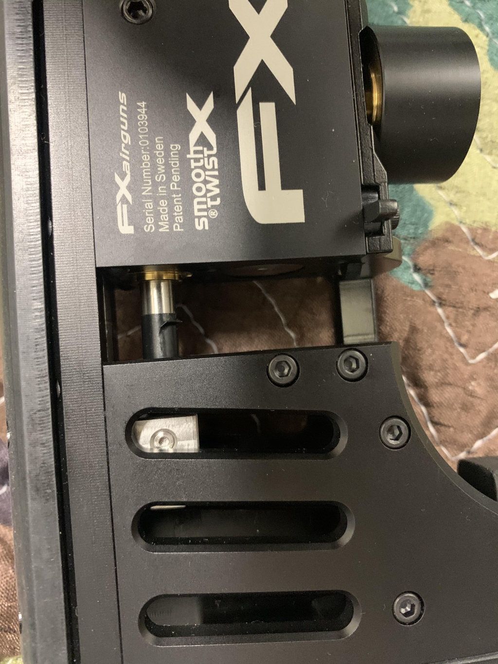

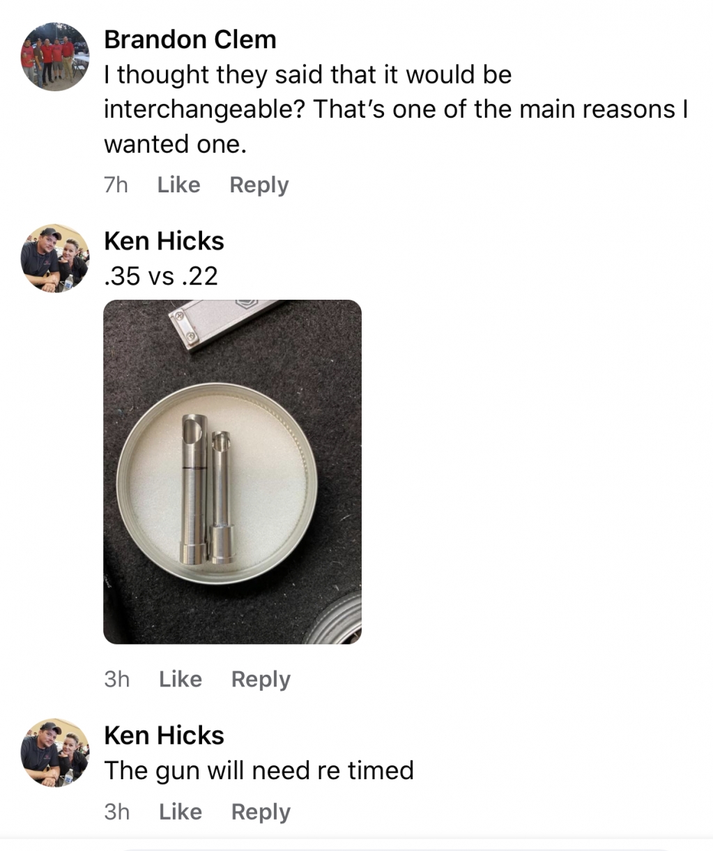

The gun needs timed just like Ken Hicks said so it's clear the .35cal impact is not a changeable caliber and I can't understand why FX has not told anyone this yet??

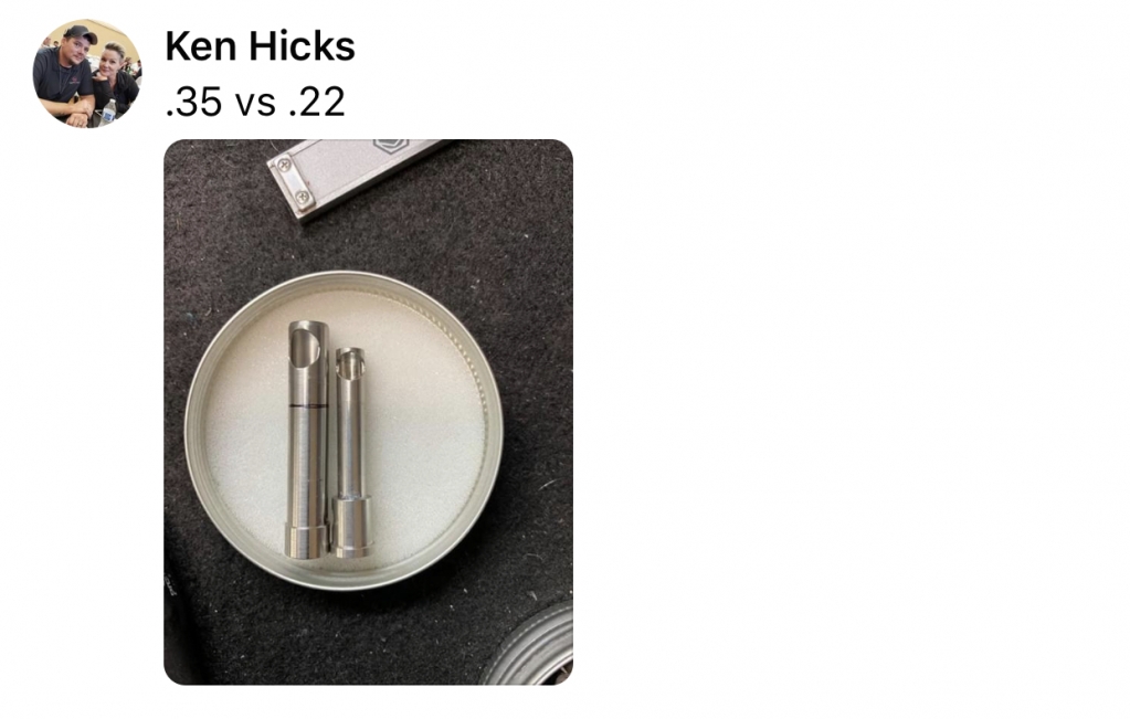

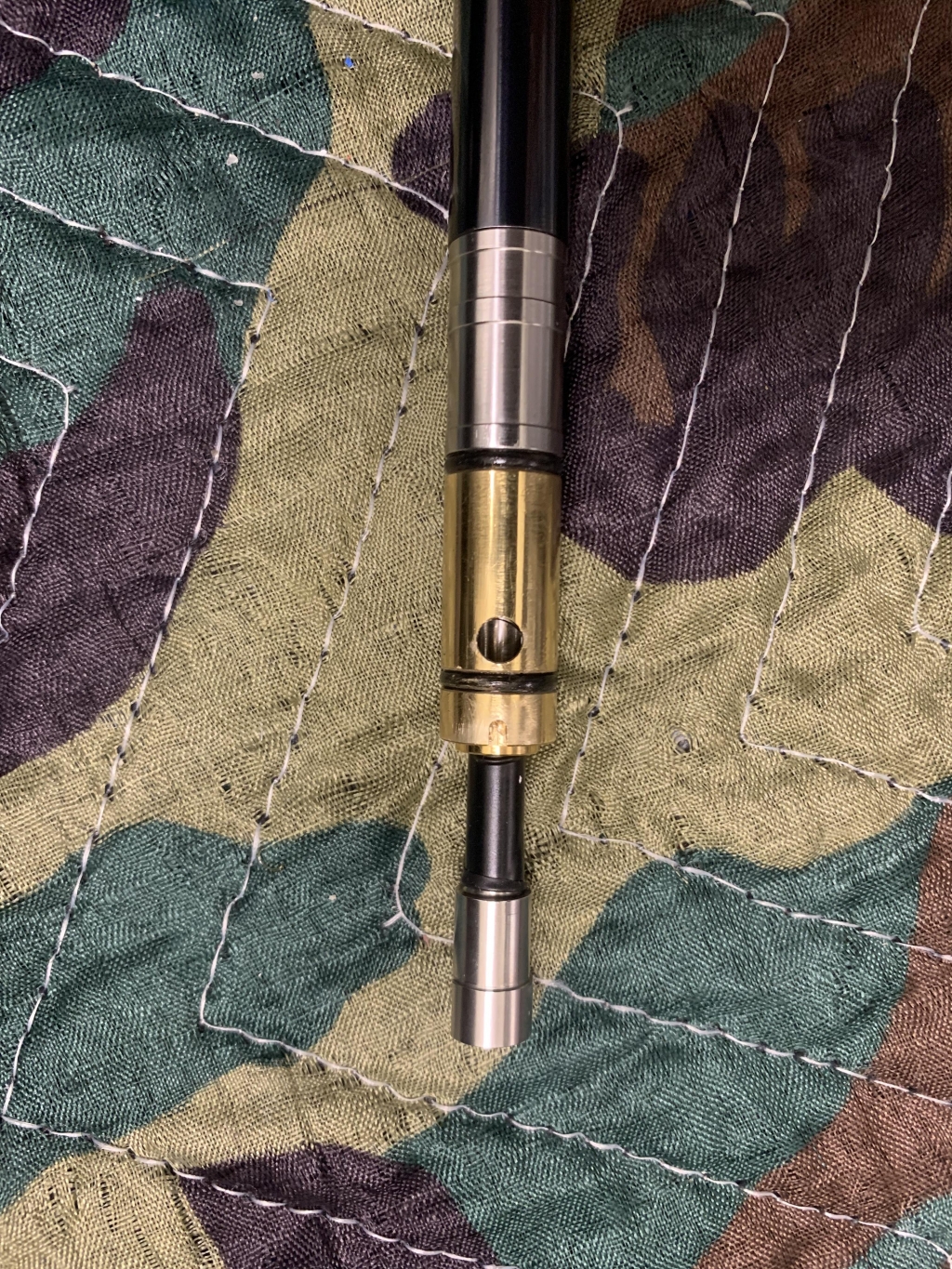

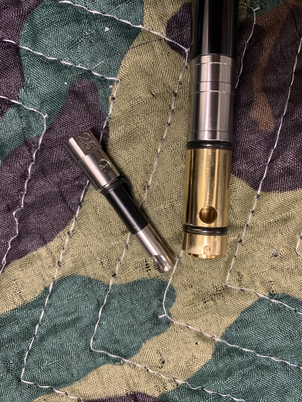

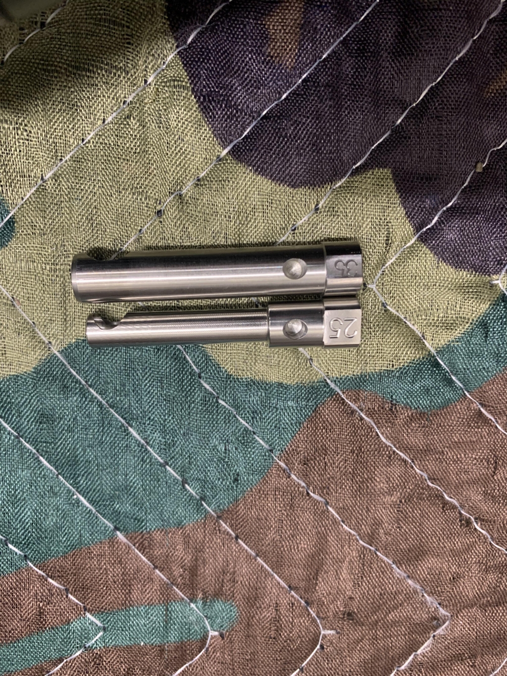

Ok guys I think i undaunted what might have happened and why they are so many different opinions on why you can or can't shoot from .35 to a smaller caliber? Ken Hicks of spaw sent me a photo of his 2 pellet probs. One on .35 and one on .22

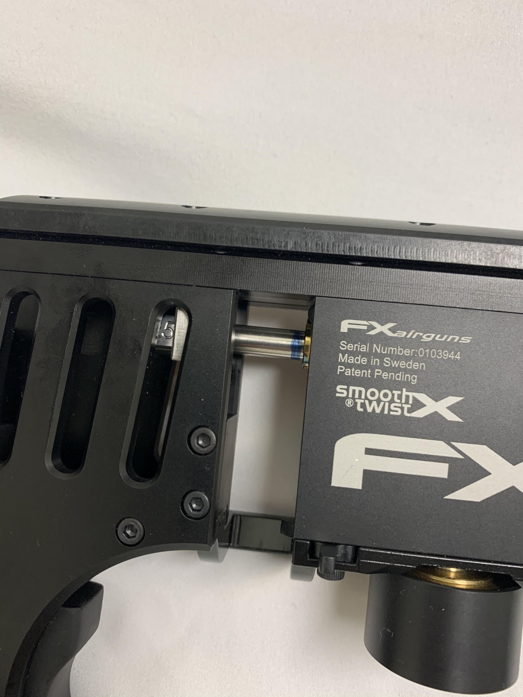

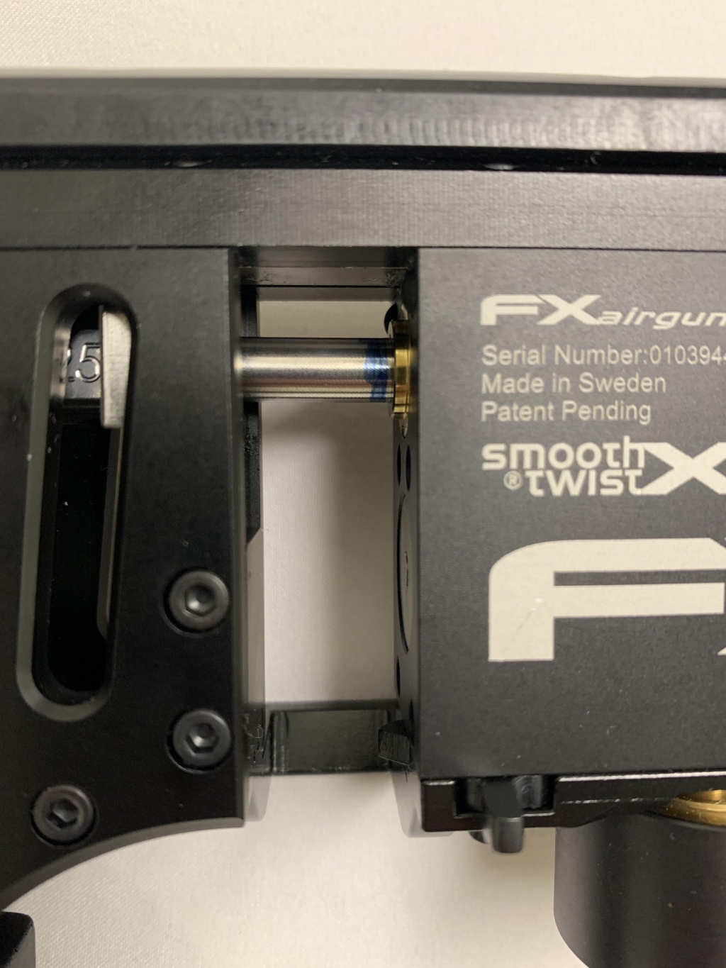

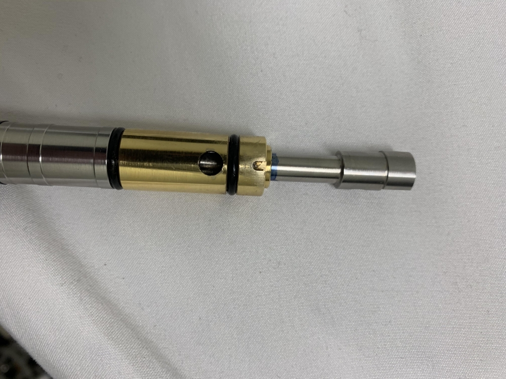

as you can see they are completely different sizes Length and size and that's why ken Hick said it won't work because it needs timed? Well Fx must have changed that because mine are the same length so timings the same.
I don't know if FX sent him and Utah airguns Justin Jacobson older versions of the .35 but they both have the same problem with size so I think Fx changed the size and never said anything to anyone because both of these guys are the best of the best when it comes to airguns they know everything.
so besides that I understand why Ernest Rowe told me to just swap out calibers and shoot now if the gun is to powerful well that's pretty simple to dial it down some I hope but at least I found out what they was talking about and they did not know because I guess FX never said anything. But am happy now and love my impacts I just hope nothing else comes up? But the timing of the prob and barrial port are perfect fit so that's awesome news for me because I spent a lot of money for the kit and impact hear are more photos thanks everyone I just have to get out and shoot and see hahaha.
So how I am interpreting you post is that now that your .357 FX Impact MK2 is apparently the version where the pellet probes are now the same length, now you can change between the .357 and the .25 barrels and hopefully just make some adjustments? Am I understanding you correctly? Please post an update once you have shot the gun and tried to change barrels so we can know that the new .357 FX Impact is hopefully not a one trick pony afterall?

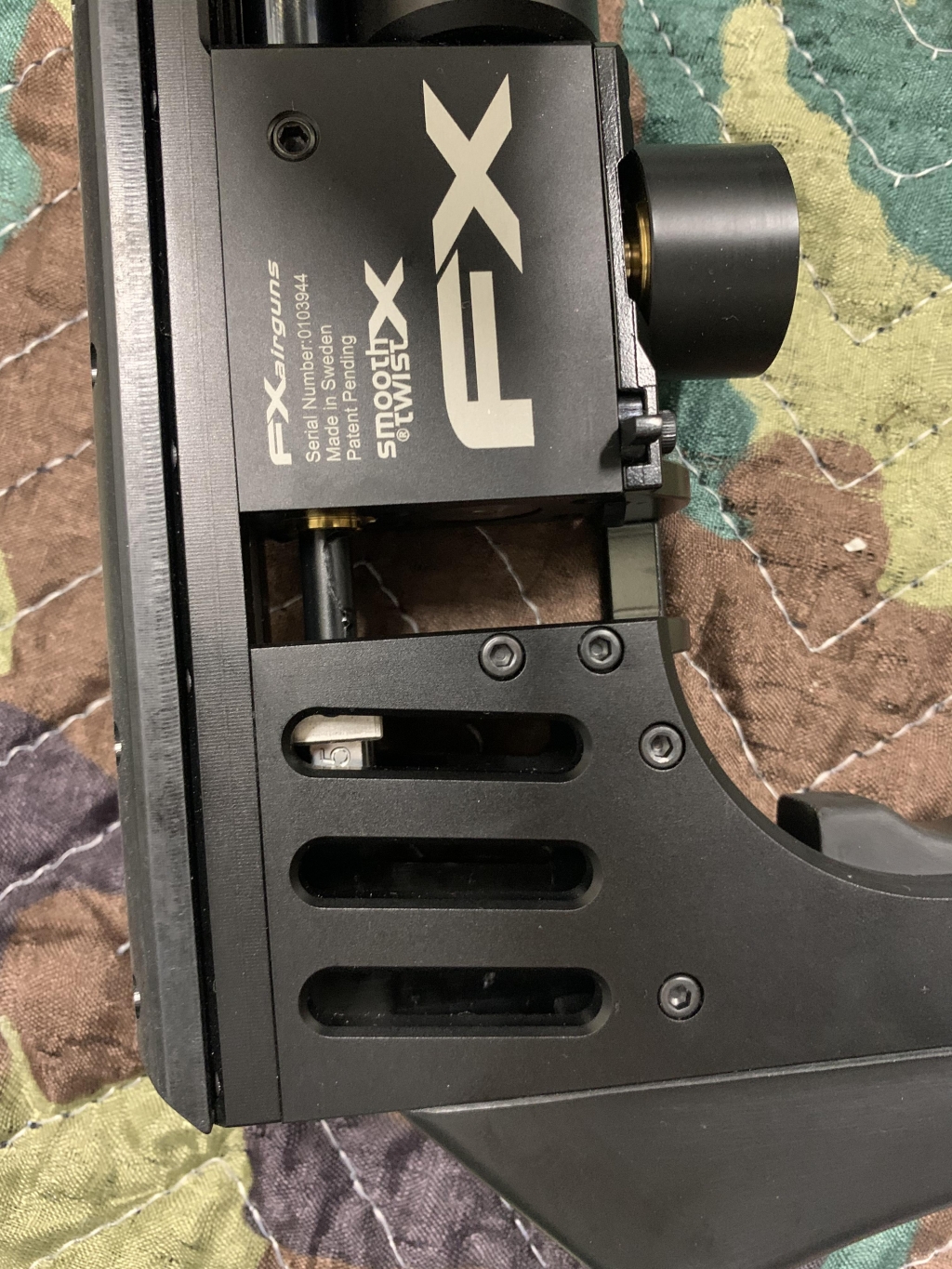

Yes I was always told that you can change calibers between all calibers but after I posted some photos of my new impact with .35 cal and a compact .25 cal I was told by very good sources that I could not switch calibers because the timing was different and therefore could not use my .25 compact kit. But turns out Fx at some point changed the pellet probe and timing so now you can. That's what this post is about the change Fx made but no one know about it I guess I only found out because of my photos and talking to members. I will get some range time this weekend and let everyone know how it went.

1# the timing link is different on the .357 meaning?
the pellet prob does not seat all the way in? Now Fx changed this but never told anyone I have photos from Ken Hicks of spaw and Justin Jacobson of Utah airguns who both say it's timing link is different. Now Fx fixes that with a smaller prob in .357 but it's still a tad short.

I will make videos in how to change caliber on the 357. Just to let you know the new . 22 has my design double TP rotate barrel to the smaller TP to reduce the speed to 150-175fps .22 will shoot hot if you don’t. You don’t have to disassemble the gun. Just changing valve adjuster spring between light and strong spring and keeping the rubber ball in front of the valve spring to prevent valve over travel. Believe me its so easy. If you want more info PM me in how to deal with the 357. A pin probe kit is need to adjust the length of the pin to insure the ammo is fully seated in the liner.
