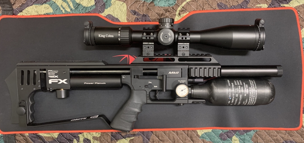

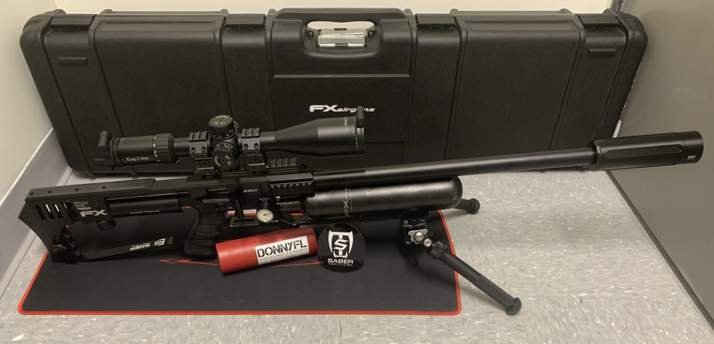

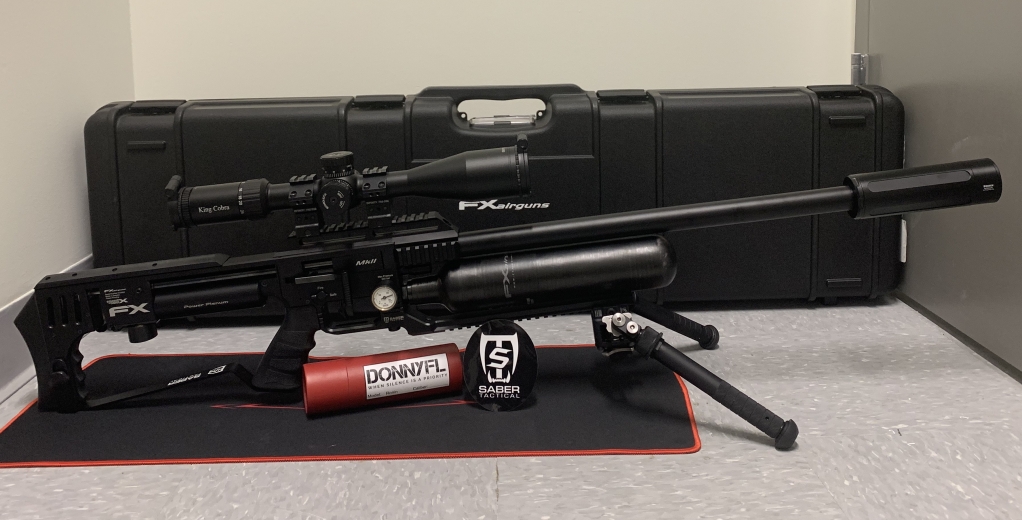

Ok guys the Fx impact .35 is a one trick pony you can't switch calibers
I was told by 2 good sources that my impact .35 cal I just got can't be anything but?? And what I mean is I posted photos of my new inpact .35 and I also put a compact 25cal kit on the same impact. So I would have the best of both worlds!! But I was told it won't work the gun would need way to much work done to make it worth it and was also told some one else had problems trying to do the same thing??
Wow that's not what FX tells us so why is this not Compatible?? So is it possible that the Fx inpact .35cal is a one trick pony and it's not as versatile?? My questions are why? it's the same impact I was told you can buy kits and switch calibers?
So why is this not talked about by FX. If this is truly the case?? Am i the only guy who just found this out or have anyone else had this happen to them Well will find out more from FX because I love all my impacts I have owned its my favorite airgun and I have several I hope I was told wrong info. This is the gun am talking about. In photos. It's a stock .35cal with a .25cal kit the kit fits perfectly??
I emailed Ernest roe and ask him what he thought about this. I was told the gun is timed different and it's a little to much for the . 25cal by someone else. But I put the superior liner in and I just watched a video that shows Ernest shooting .25 hybrid slugs at 1080fps and it's hole next to hole very accurate so am so confused with all the miss information on this I love my FX airguns and especially my impact so just can't believe this is not compatible like the other impacts are but he did say it can be done but it's not as compatible as all other calibers because of the very high power.

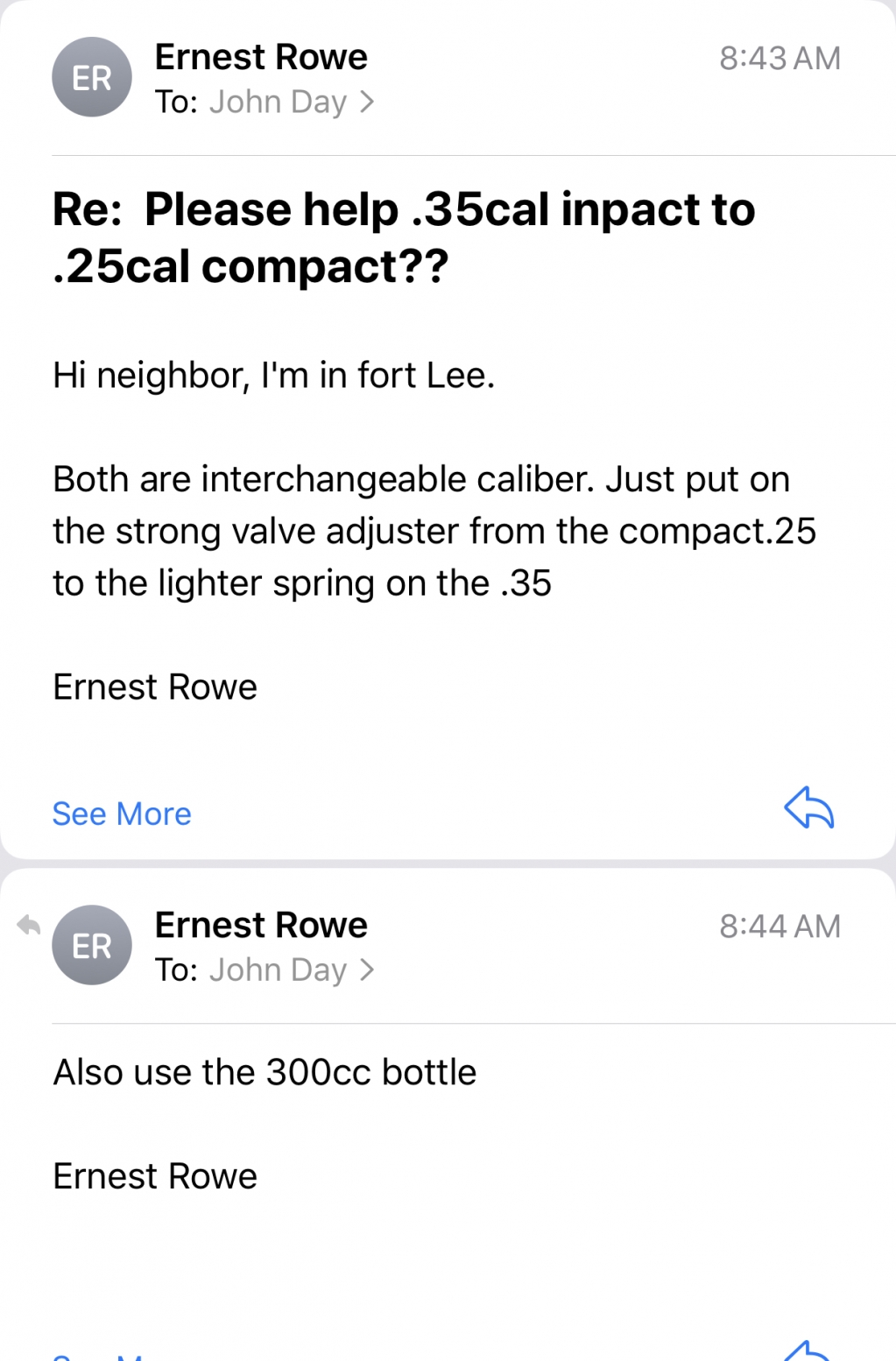

Ok I got a email back from Ernest Rowe he said they are interchangeable but I would need to change the valve and spring. So basically to much work to do it it's definitely not as easy as the other calibers. But the best news of all was turns out Ernest is my neighbor hahaha I just moved to New Jersey for the summer and he lives in the next little town over from me. I would love to meet him and have him tune my inpact. 😎 but he told me it will still work just dial down the power so I will test and see.

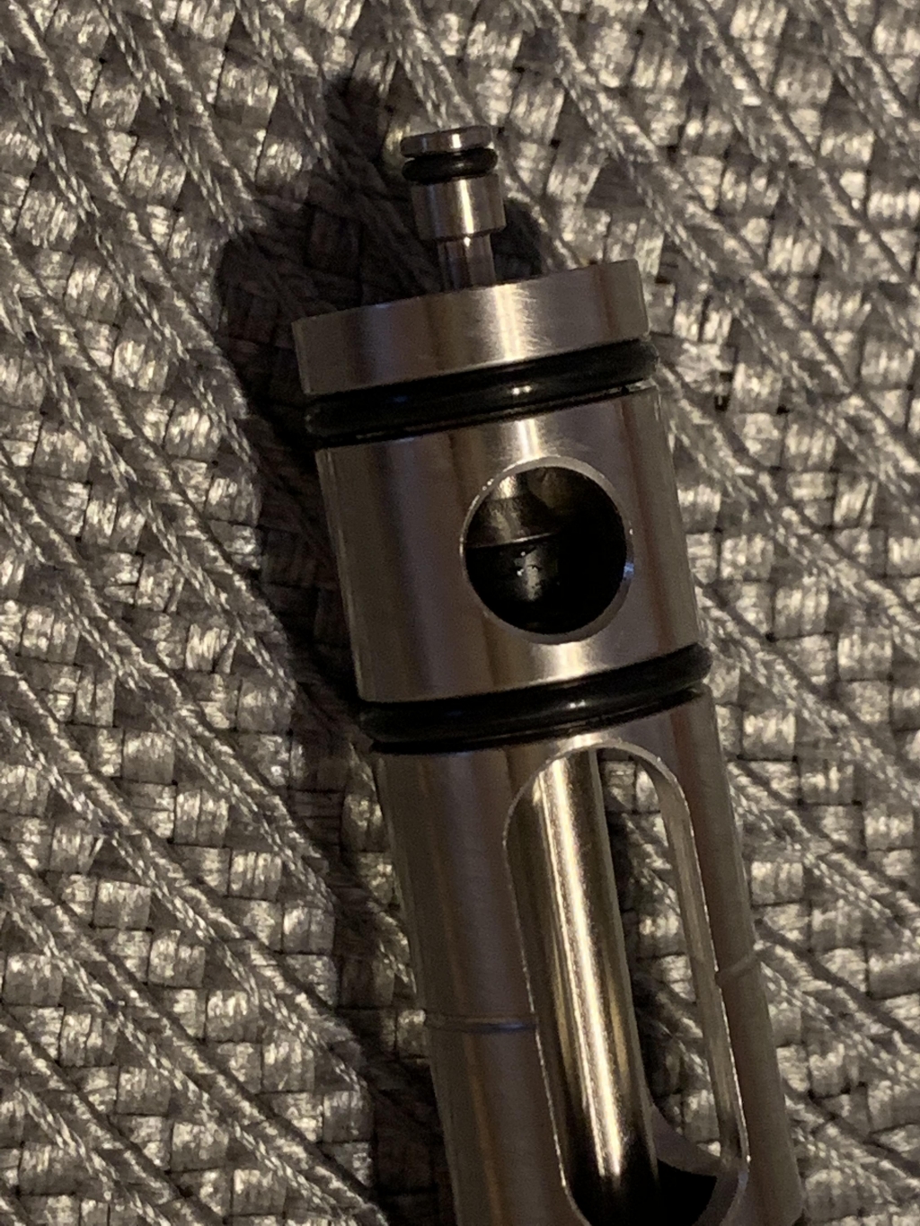

I've been wondering about the valve. I don't know if any of you remember a while back, I had FX send me a new valve and valve housing for my .25. When I got it and looked at it, it was huge. Apparently they had accidentally sent me the .35 valve and housing. As soon as they figured out what they had done, they messaged me and wanted it back pronto!!! If you buy the .35 and want to shoot .25 or .22, when you convert it over, it will be a beast!!! Here's the .35 valve housing with my .25 valve pin sliding right through it.
Stoti

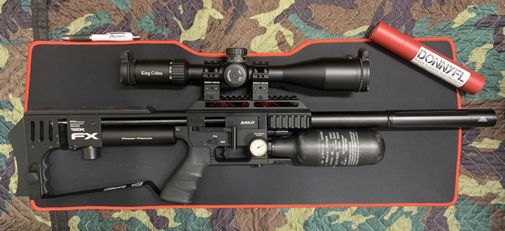

I understand not being able to go from .177 .22 .25 .30 up to .35cal because yes it's a bigger hammer Weight and spring. But to go smaller like from .35cal to .25cal I did not think it was a problem at all but.
I have spoke to 3 of the best guys who I would very much trust and that's Ernest Rowe. Justin Jacobson. And Ken Hicks. All of them say it's not really Compatibl it's timed different? So I am shocked to find this out they have tested this.

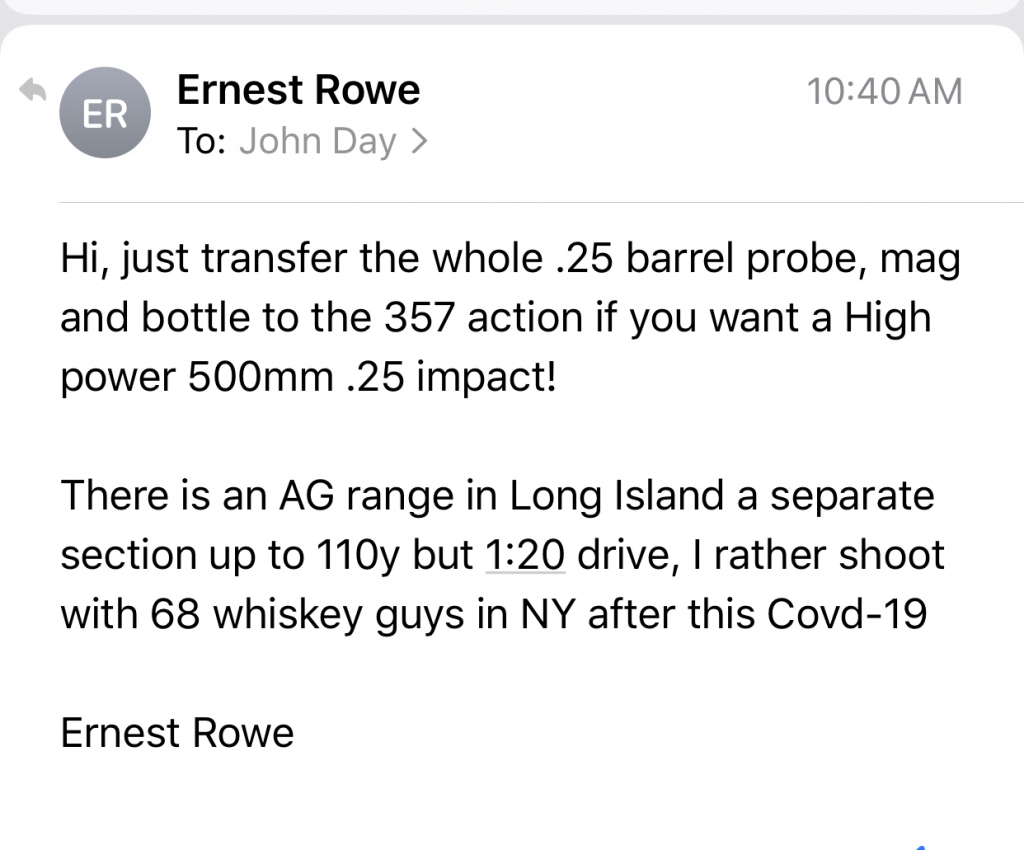

I think FX needs to be very much clear as to this is a one caliber airgun. Now I spoke to Ernest Rowe again and he told me to transfer my prob magazine and barrial along with my compact bottle and shoot. But he told me earlier I need to change my valve and spring. So I guess am just going to have to shoot and see.
I truly believe it's just a case of no one really knows but then again they tested it?? So I think FX needs to be clear on going from .35 to smaller calibers instead of the other way around. I will hopefully get time to shoot and see but New Jersey is not very friendly when it comes to airguns I called 3 ranges outdoor and they all said absolutely no airguns. But Ernest Rowe told me about one in Long Island I can go to. So stay tuned.
