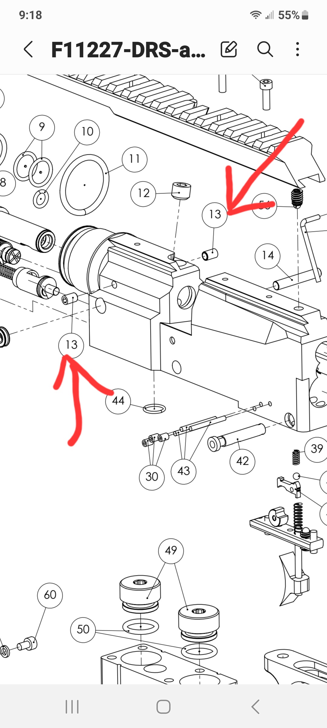

Hurray now we know. But what is that little grub screw next to the gauge for??
It looks like a barrel retaining screw

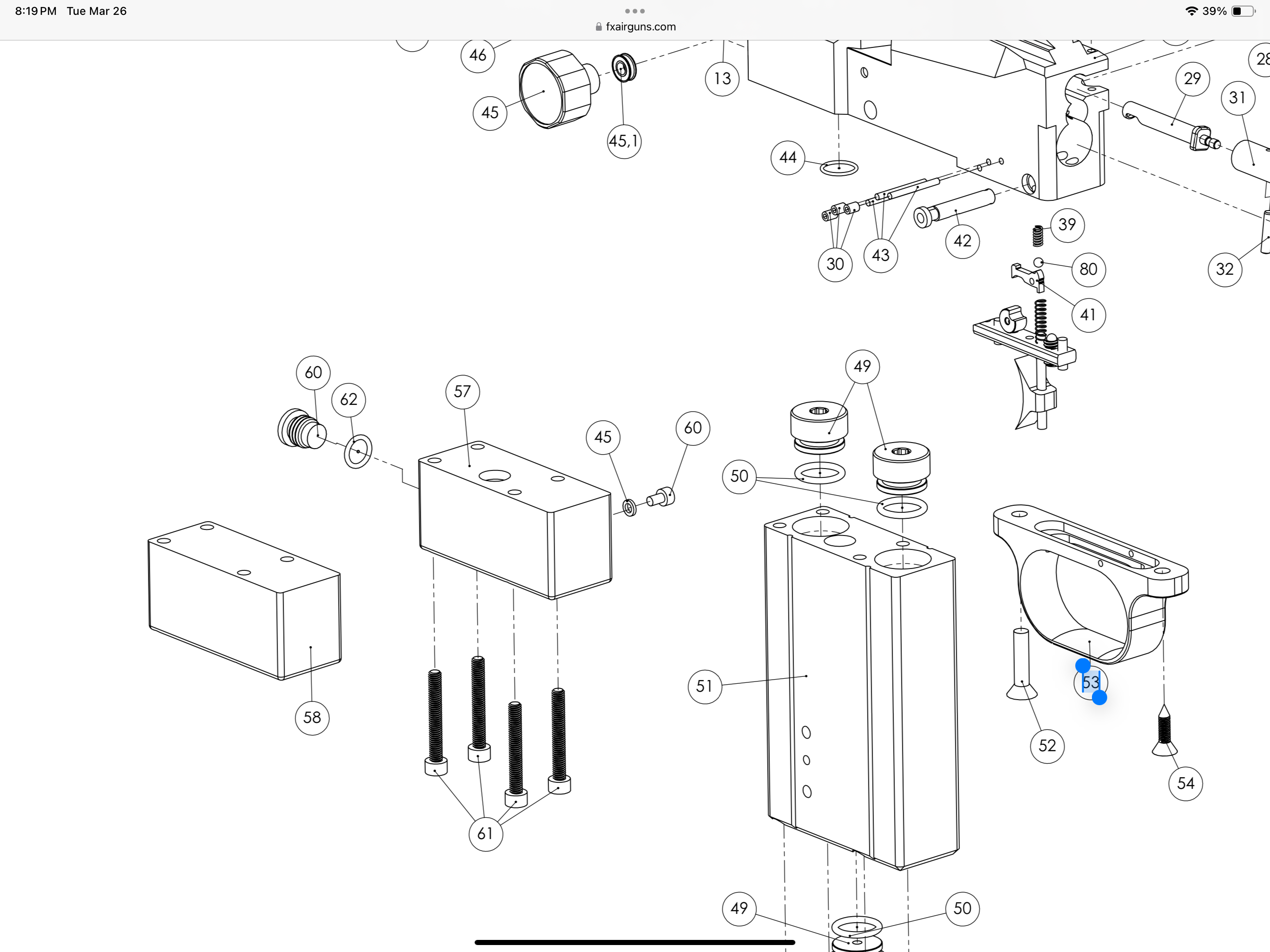

Yeah I was way off. Should have looked at this picture. I’m curious about the design of the Plentum. By the looks of this diagram the plentum for the sub 12 guns is just a solid block, so in a sense there is no plentum . Then the classic plentum shows just a single hole drilled from the top which I take is the inlet and outlet hole and the only volume for air in that block of aluminum. Then there is the much taller Pro plentum which shows three extra and much larger holes drilled and plugged for maximum volume chamber for the DRS Pro. Seems to me the DRS Classic plentum Can be made with some more volume by adding the extra three holes as the Pro version. How much more volume and more important how much more power it would add is my queastion to FX. And why wasn’t it made this way to start with? After all my GRS Dreamline with the larger plentum can be tuned from 18 grain pellets going mid 700 fps to a decent slug slinger. Makes you think FX doesn’t want to give us all the performance up front , to later offer the accessories to replace the original parts. Mo money!

But if you have not shipped it yet, Id be very tempted to at least examine the 2 orings shown as #8, in the regulator diagram.
The 2 orings (#19731) are identical.
If the bottom (deepest) oring were to fail, youd get a leak exactly where you have described.
Probably take 5 minutes or less, to remove the action, and examine that particular oring.
Part number #19731.
