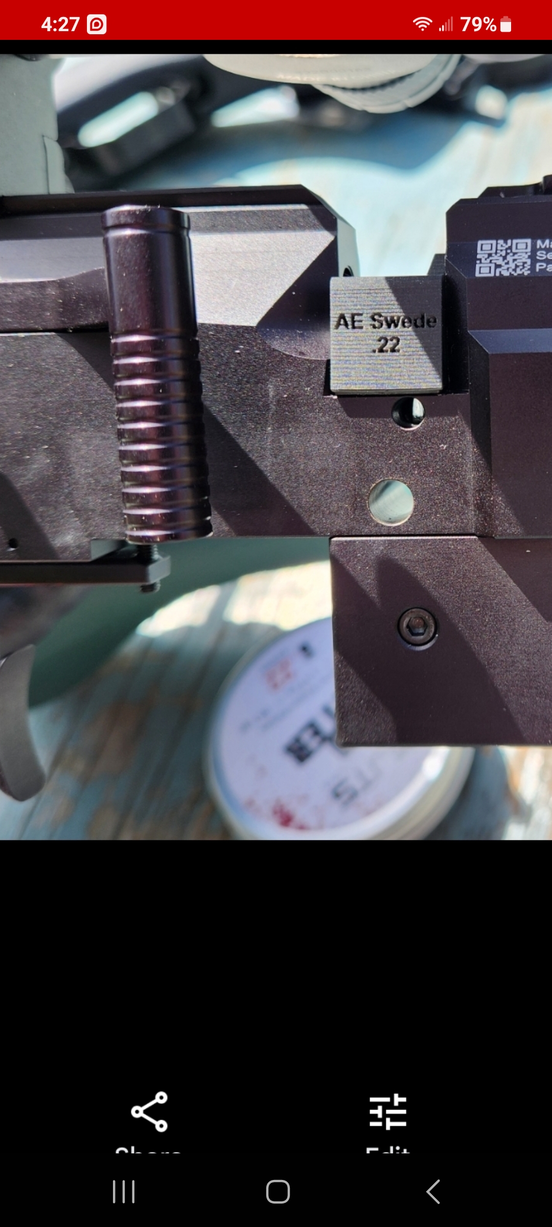

FX Ok finally got to the shooting range with the DRS...not good ......

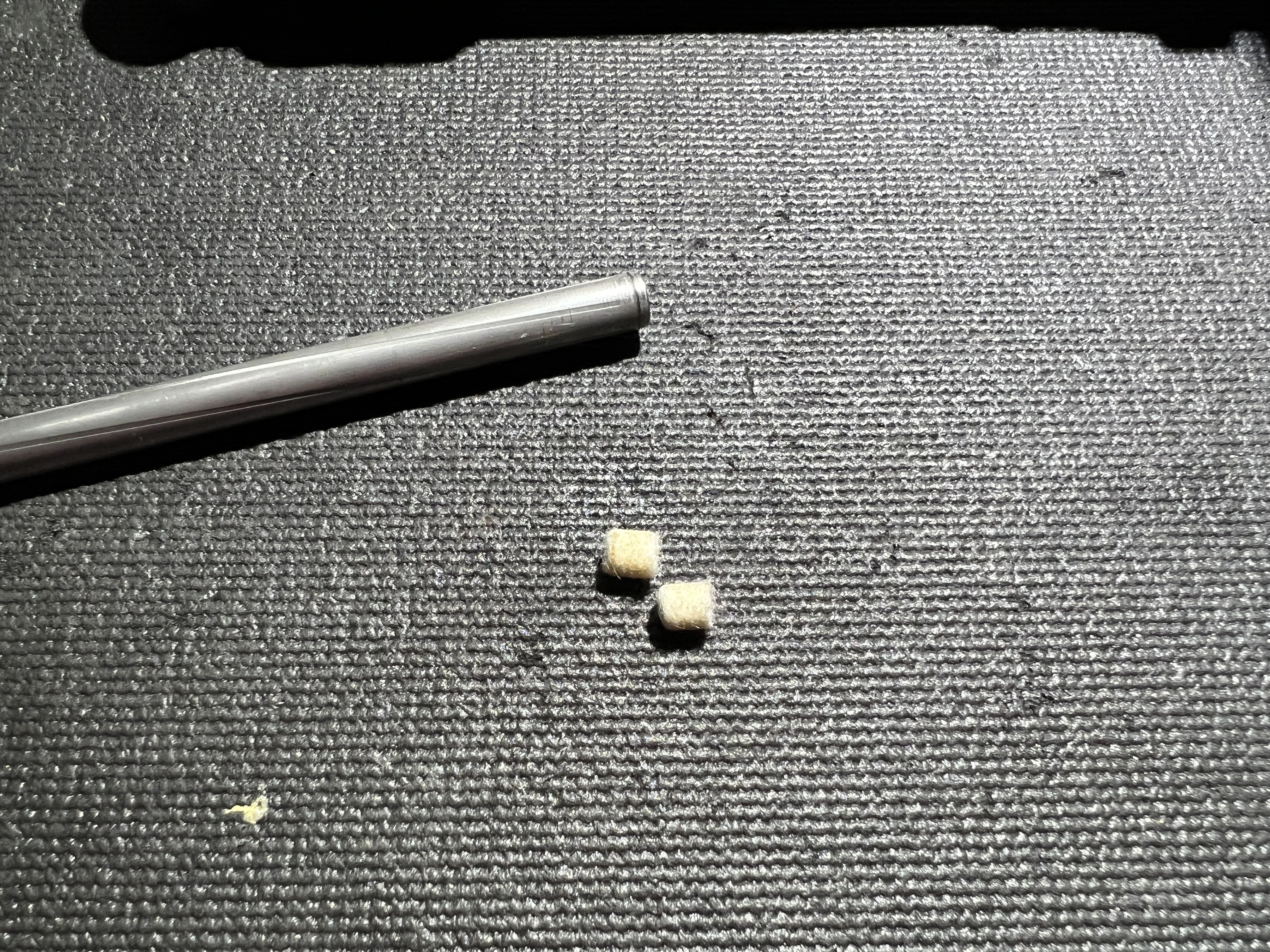

It takes 2 minutes to pull a couple patches through a new barrel. This is what came out of a new FX barrel recently. I know guys get excited but we should check for obstructions. I hope Cape Fear can handle it.

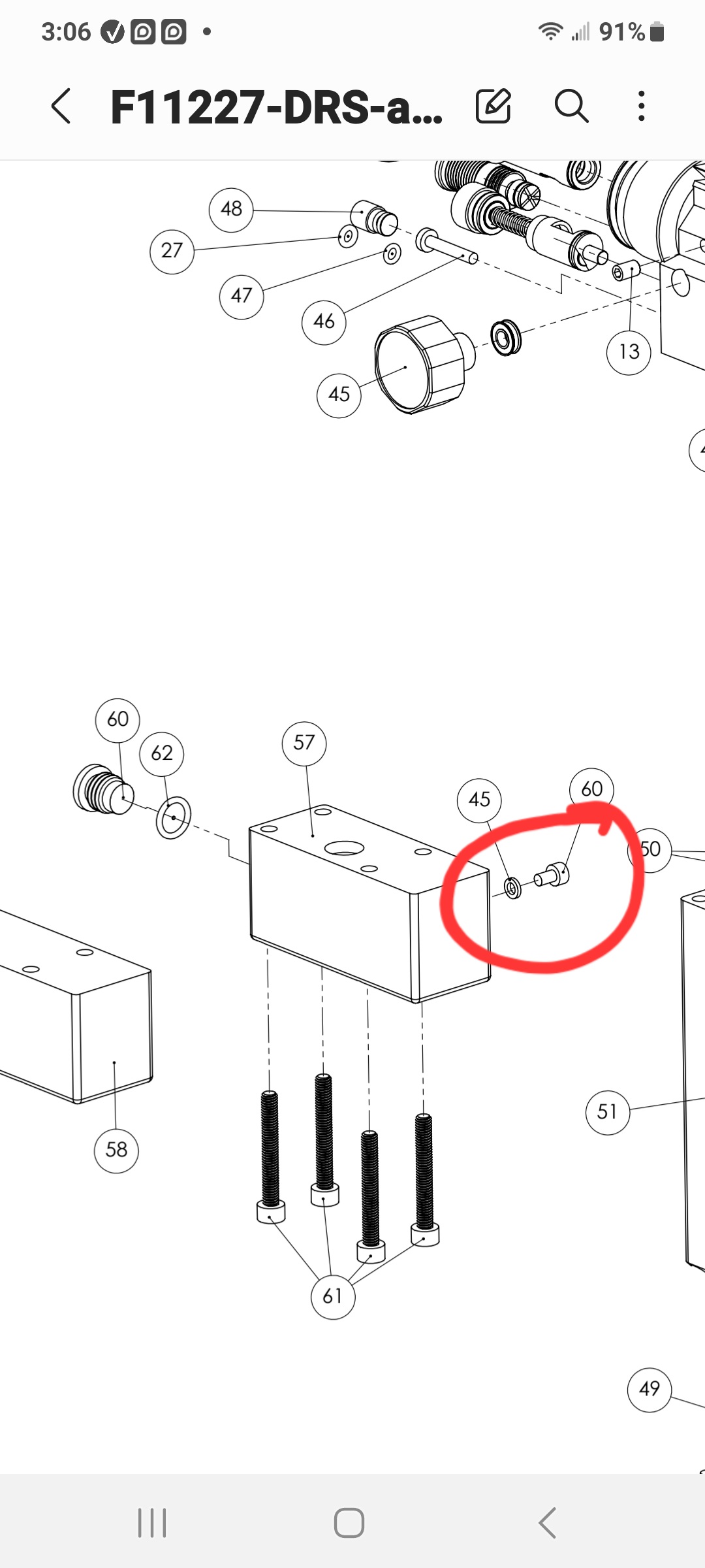

That’s the reg vent hole. Try degas the gun then take out the regulator adjustment screw and add some silicon grease to the orings. It takes no more than 5 minutes.

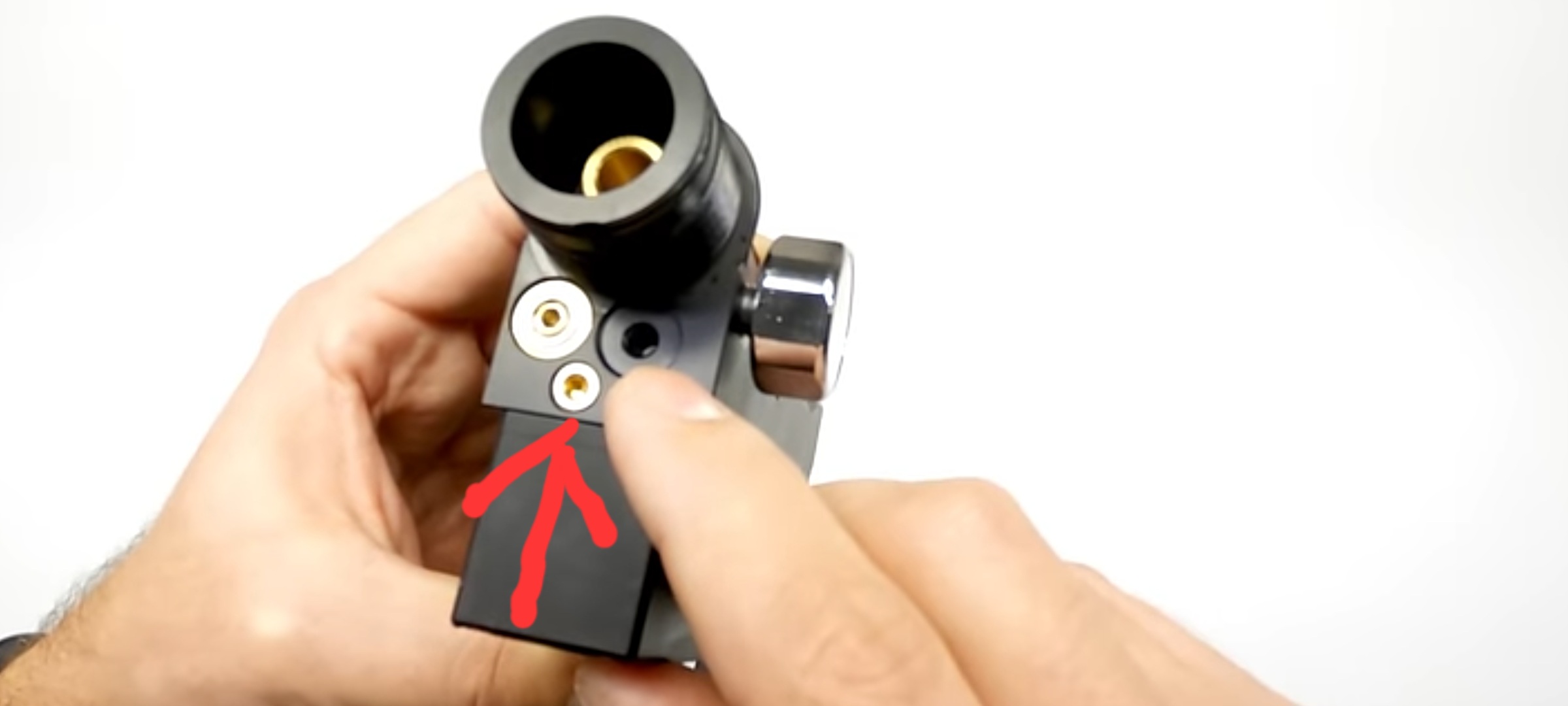

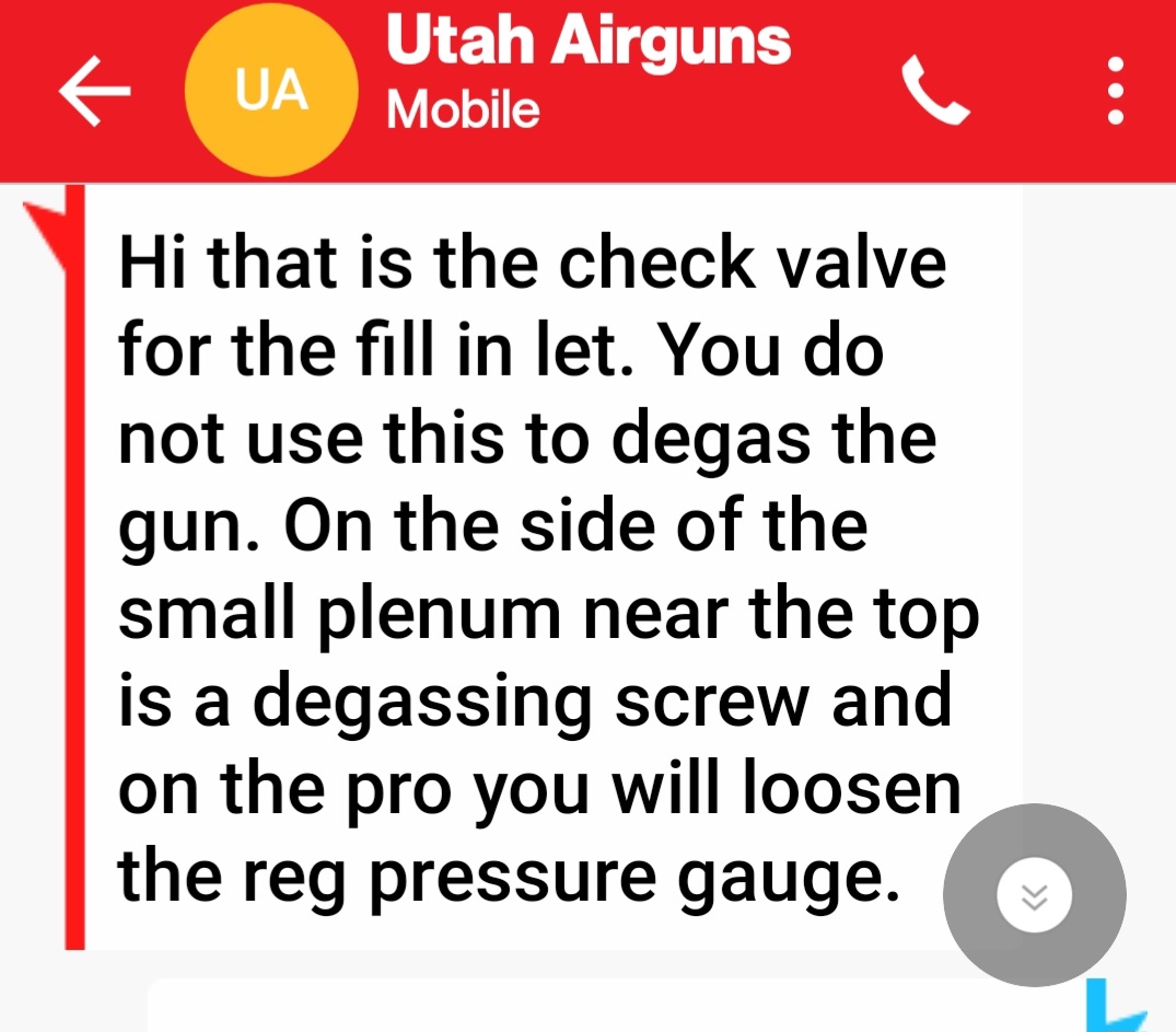

With this rifle I not idea where to bleed the air?? Everything else sounds easy just not sure what I am looking at....thanks ...
