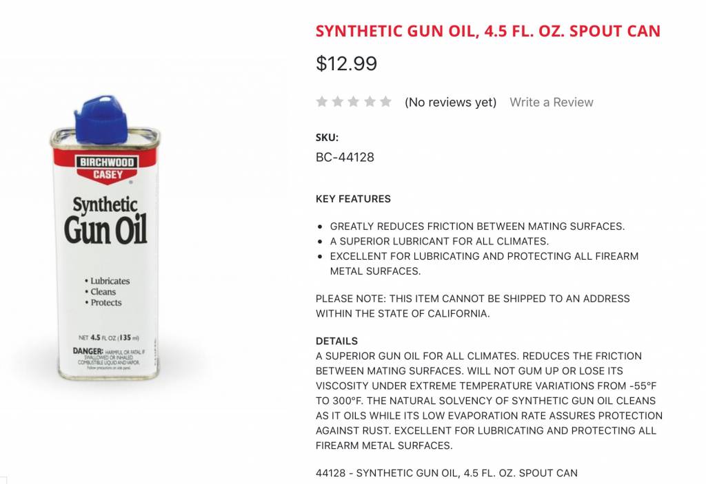

Any good gun oil should work. For pivots I prefer an oil around 20-30 weight, light enough for good penetration, but heavy enough for good lubricity. I also prefer synthetics because of their stability over time, nothing to evaporate or get gummy. Often I will apply moly in a light weight carrier, wait for the carrier to evaporate, then oil. I have had good luck with the Birchwood Casey synthetic gun oil.
