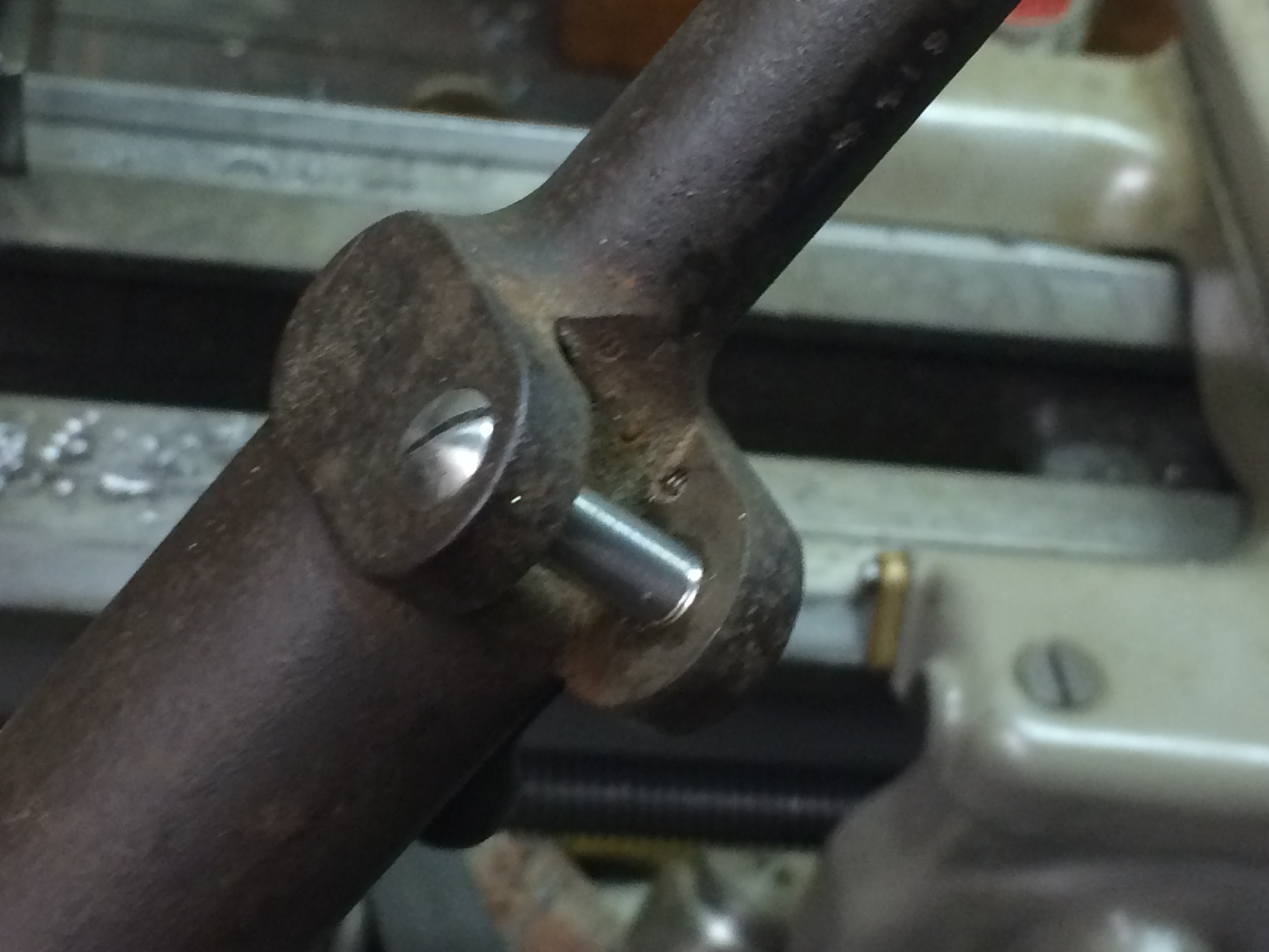

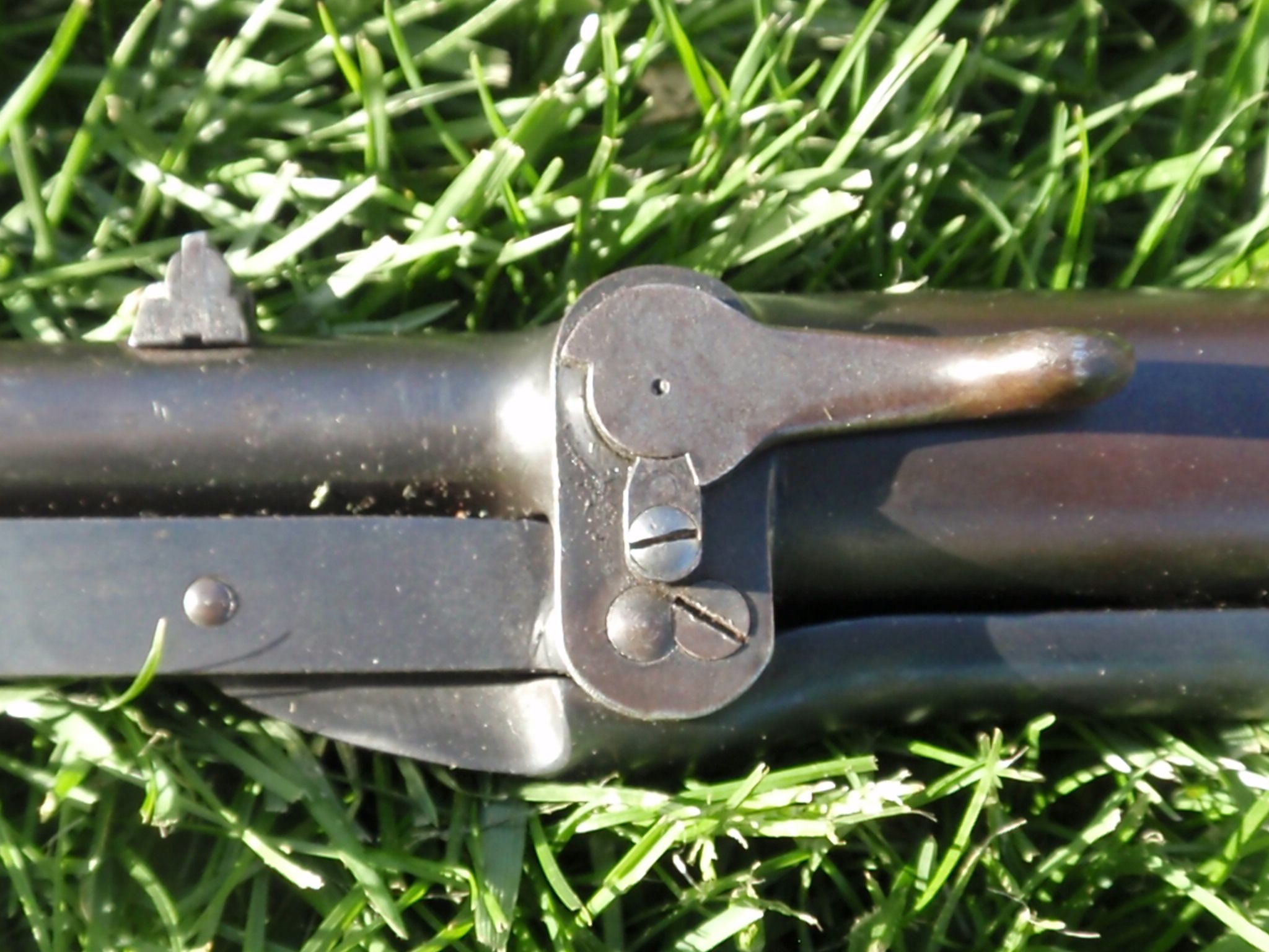

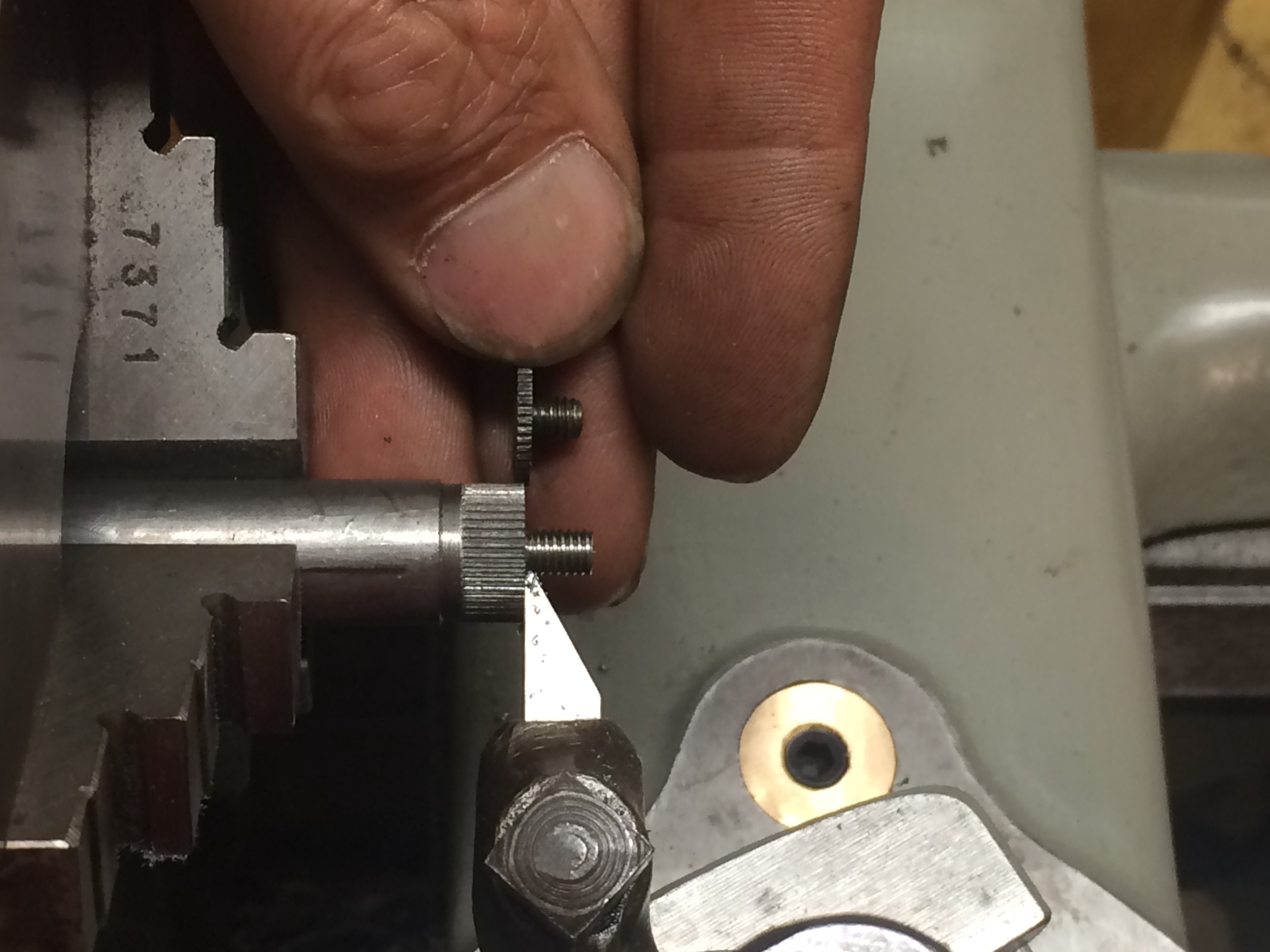

This screw (top one) was mangled so bad it looked impossible. Plus it has a tapered seat for alignment. It was real tight (was in there since 1906) but I got it out with a slot bit adapted down and the impact driver. Then I repaired the head by carefully peening the metal back to shape. You wouldn't believe it. It looked horrible. I have repaired many screws like that. You can not get them. Proprietary thread. Otherwise I have to make them. And sometimes I do

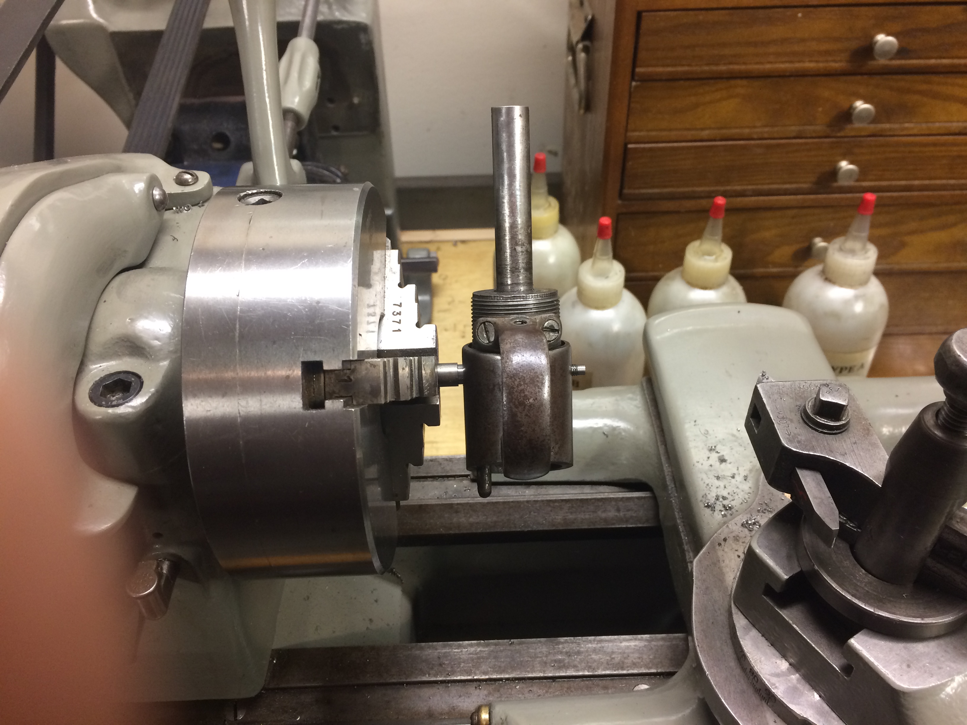

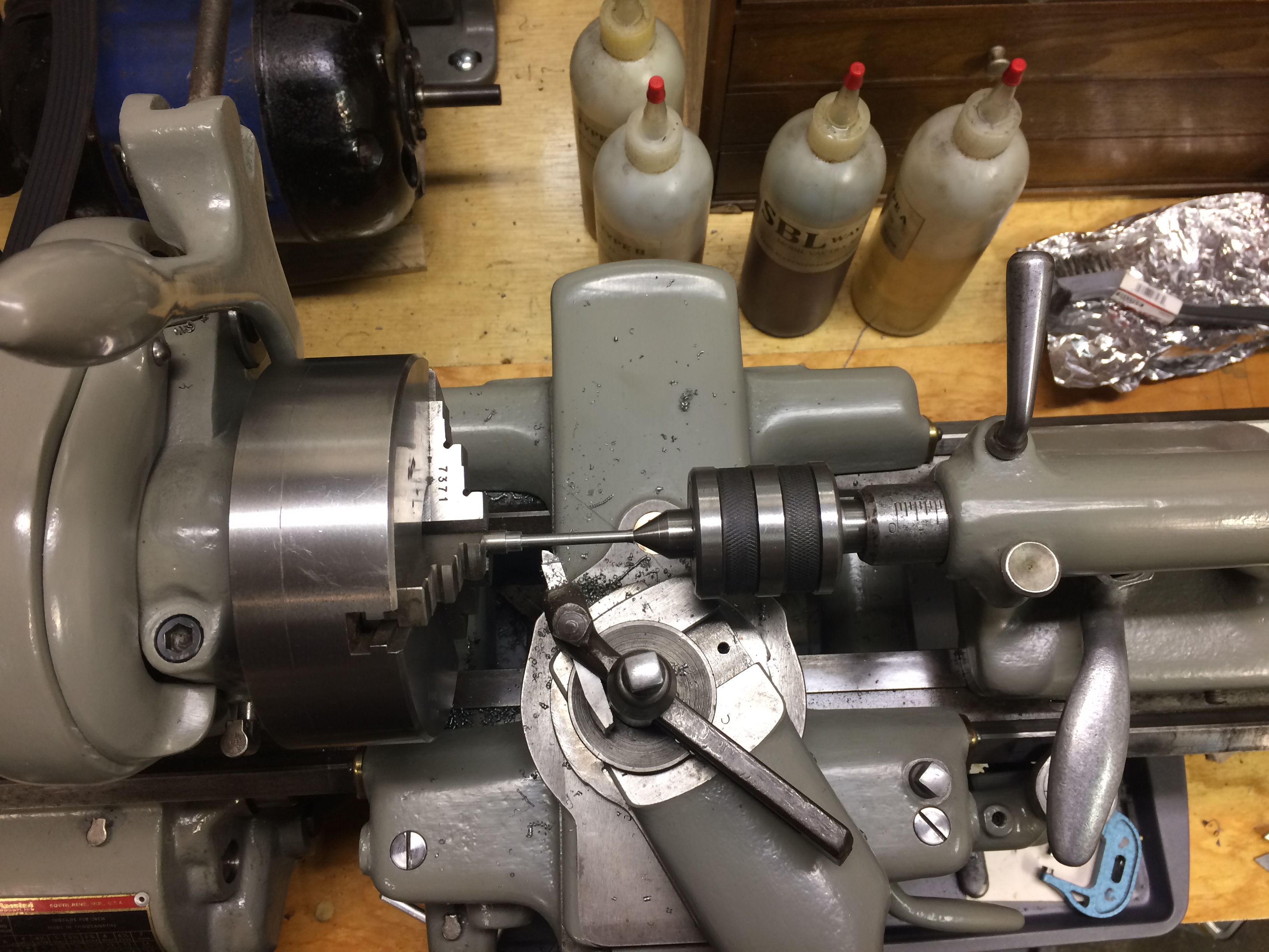

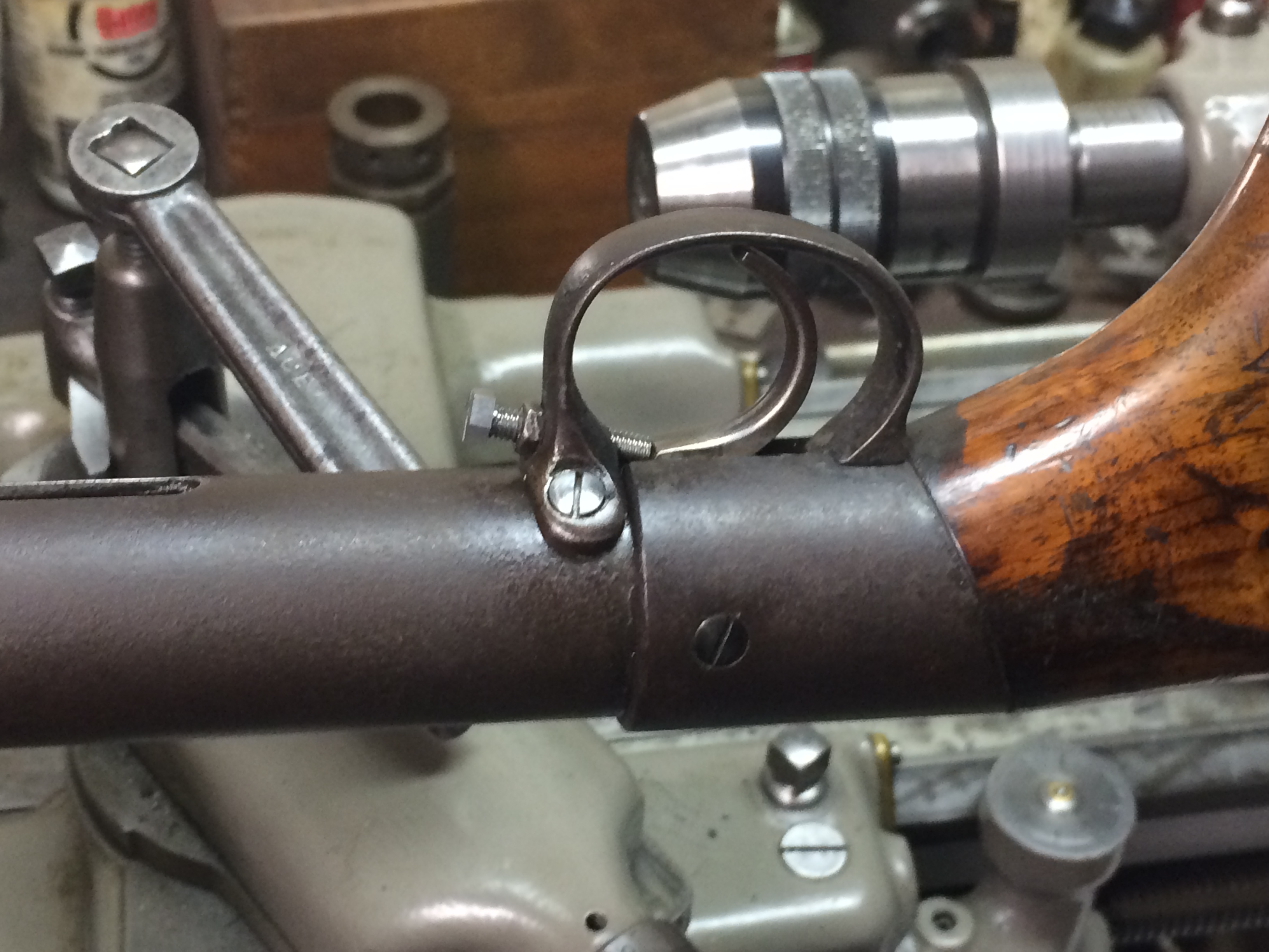

Made all 3 of these screws. Including the trigger screw. And many more.

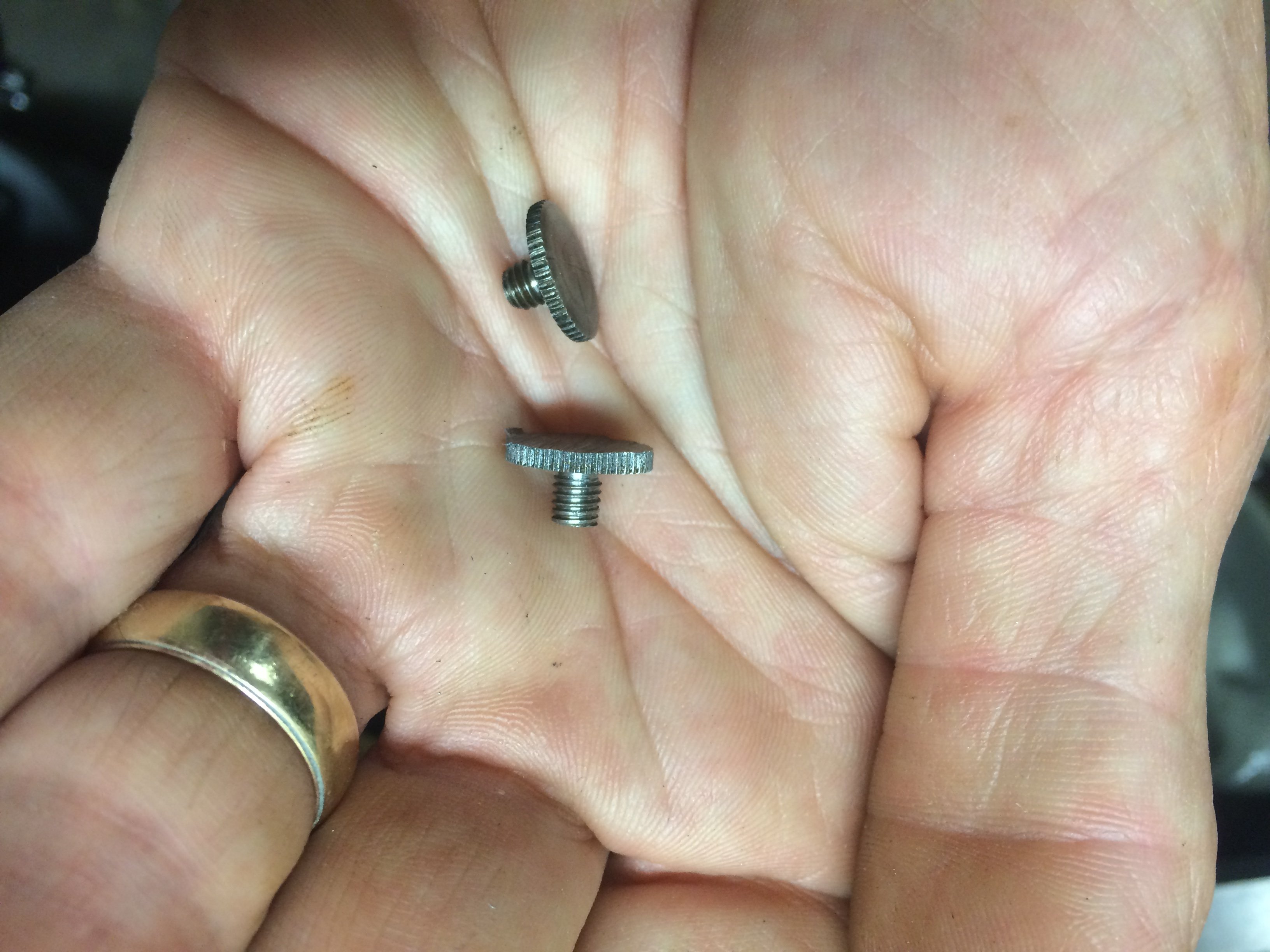

More screws made. Child's play
