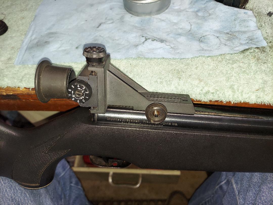

Often wondered .. Now I know, FWB 300 sight fits on a 124/127 Rifle.
Recently acquired a full set of FWB 300 Universal sights.
Have owned a FWB 124 for near 40 years !
Always wondered about the dished cut outs at rear of the 124's receiver
Well I'll be darn, The rear peep / diopter sight slides right on and those dished cuts are clearanced for the clamp bolt of the sight.
Pick the position wanted and no amount of recoil is going to slide the sight.
Who-Da-Thunk ... while never ever reading EVER about someone placing these sights on the 124/127 sporter rifle.
* OEM front globe sight retained.
Perfect match to the rifle, and looks great!

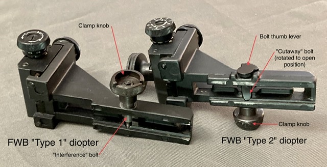

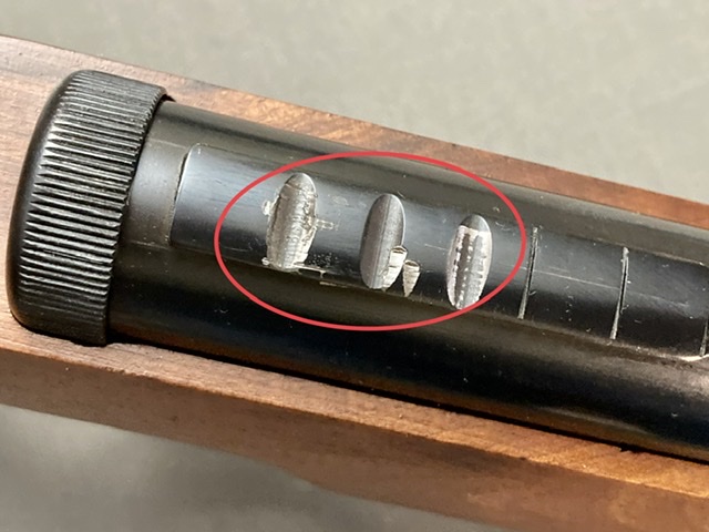

One caution - with this early "Type 1" FWB diopter, that cross-bolt must be turned all the way out when taking the sight on or off, and aligned precisely with the curved recesses when tightened, or it can ding up the receiver. You often see that sort of damage on older FWB match rifles (also on Walthers, from whom FWB borrowed the detail. Pic is an otherwise minty Walther LGV...ouch).

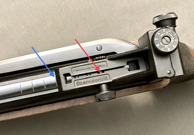

BUT...the markings on the gun help you out with this. Here you can see the dished recesses for the anti-recoil bolt on a 124 (red arrow); the small transverse lines further forward on the receiver (blue arrow) are "aiming" marks for the front edge of the sight, to assure the bolt is correctly aligned. The sight mounts in one of four positions, with a corresponding aiming mark for each.
Here it is in action on a 300S.
On the later "Type 2" version of the sight, the bolt has an ingenious cutaway underneath that circumvents this problem; just rotate it out of the way 90 degrees, and the sight easily slides on or off, without having to crank the bolt all the way out. The "Type 2's" clamp knob is moved to the left side, with a neat thumb lever on the right, for rotating the bolt.
