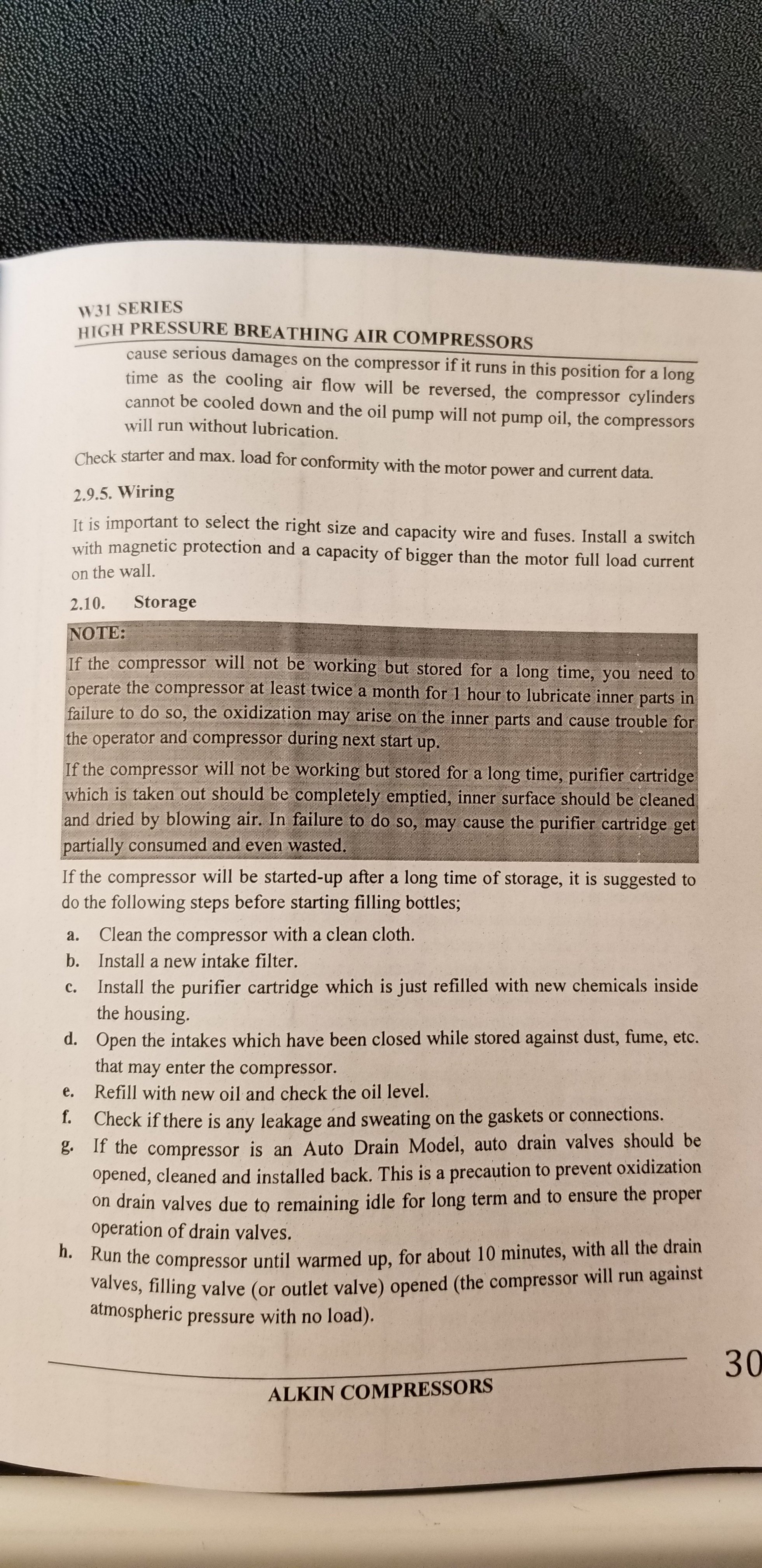

@archerhmr I’ll double check. I was reading over the long-term storage instructions a couple of days ago. Some of what you’re saying doesn’t look familiar which is why I asked. I could’ve have overlooked or read something incorrectly. What is the date on your manual? And which model do you have, gas or electric? I believe my manual was printed in May 2021.
My Alkin manual says to change the oil every year, not every 6 months, unless you hit the hour limit within a year.
Manual was printed in January 2020.
@Chuck-in-Ohio If I remember correctly, mine says the same. Didn’t want to say anything because I don’t have access to the manual at the moment.
The 2 hours a month thing is only applicable if you are storing your compressor without using it and HAVE NOT done the long term storage prep as recommended. That would be the misting of oil in the intake scenario. If you do not do that, THEN you are recommended to run the compressor twice a month to stir up the lube.
Long term storage according to Alkin is 6 months or more.
Reactions: Skydivingmiami
Let’s clear up some confusion here. Below are a couple of photos I have stored from the hard copy manual with a May 2021 date on it. These photos are of instructions in regards to long-term storage for the electric 220V Alkin W31 Mariner (vertical) compresor .
If you have information that is more current or different as it applies to other models, please post evidence and specify where the discrepancies are in the information. This has been a good thread so far. Let’s keep the confusion down so that it remains that way for others that will come looking for information behind us.

I spoke with Matt at Alkin this afternoon and told him about the discussion in this thread on maintenance, long term storage of the W31 Mariner, and differing instructions in the owners manuals over the years. Here what was communicated to me:
  • Use Anderol 755 synthetic compressor oil
  • Change oil every 100 hours or annually
  • Follow the recommendations in the 2021 owner’s manual even if you have an older compressor.
I was also told that some design improvements have been made on the W31 compressors over the years, but I didn’t ask the details of said improvements. If you have an older compressor and you’re in doubt about any of this, I encourage you to contact an Alkin representative and ask for clarification.
