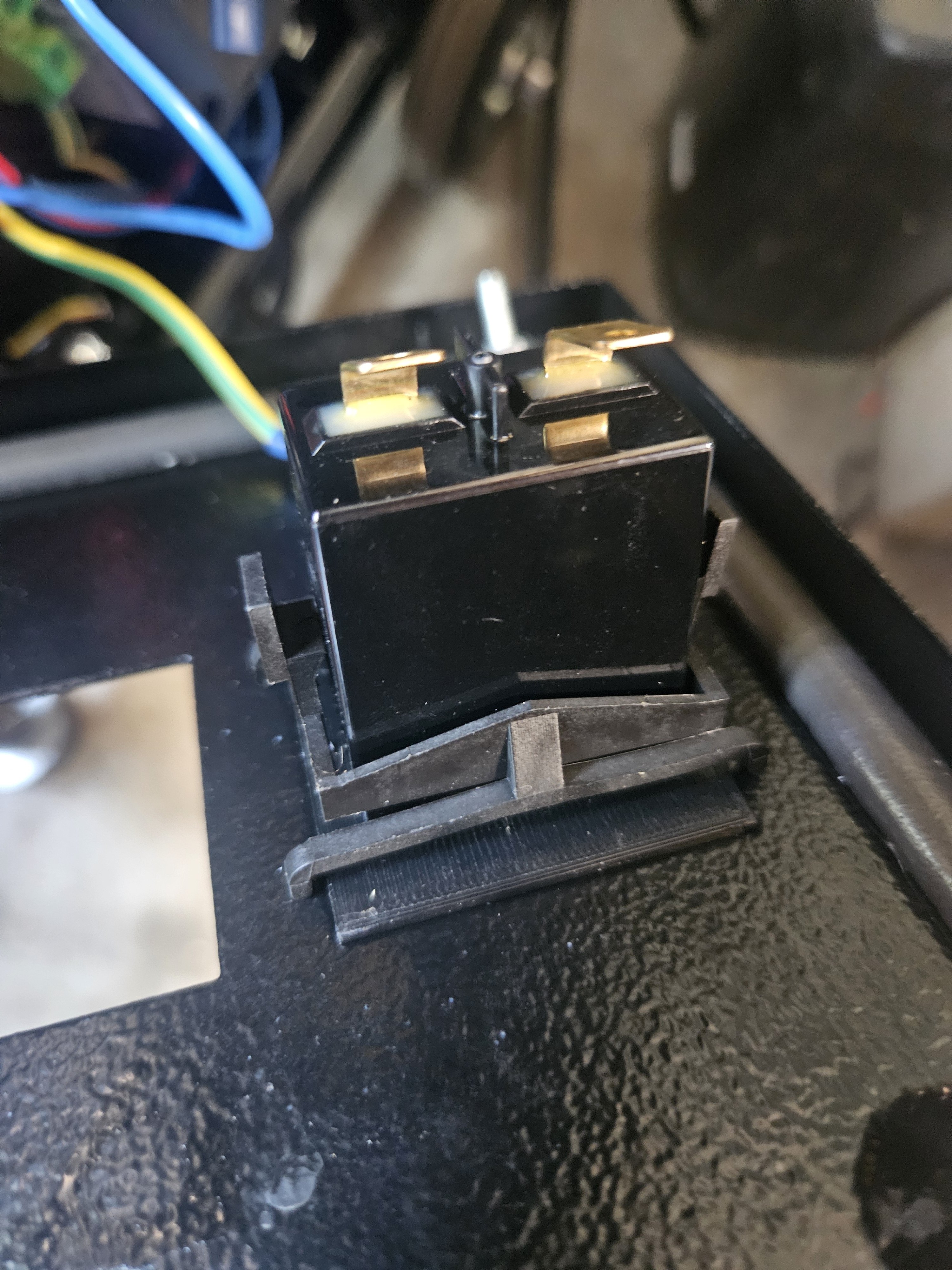

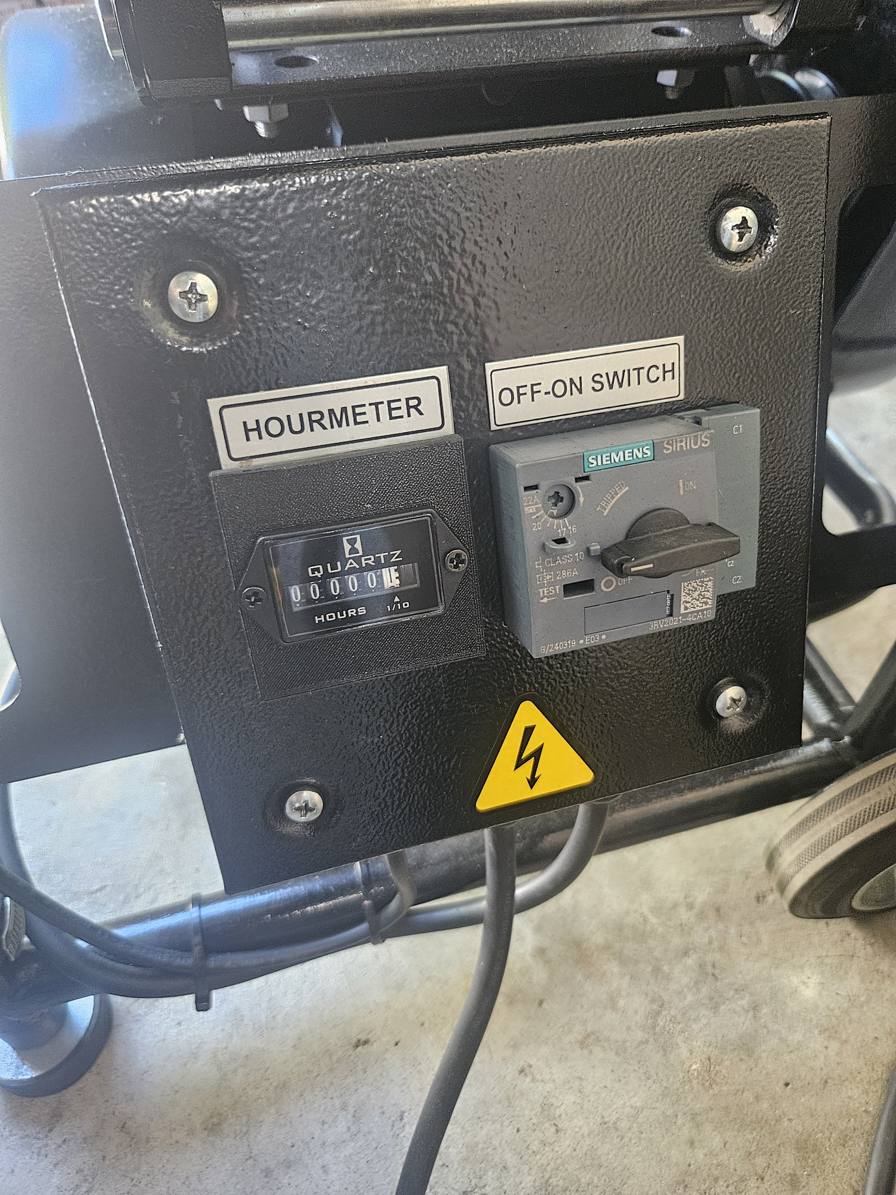

Just got mine a few weeks ago. Noticed the hour meter wasn't working and contacted alkin. They asked me to check the voltage to the meter. Trying to open the panel i snapped a piece of the power switch off, only to find that the power wire to the meter had been smashed flat between the panel and the body during install.
Voltage to the meter was 248v, not the 24v they said it should be. I sent them a photo of the smashed wire and they asked me to try fixing it.
There is nothing I like more than spending $6000 almost and it shows up not working, was never QC checked at the factory, then I'm expected to fix something that should have been working in the first place.

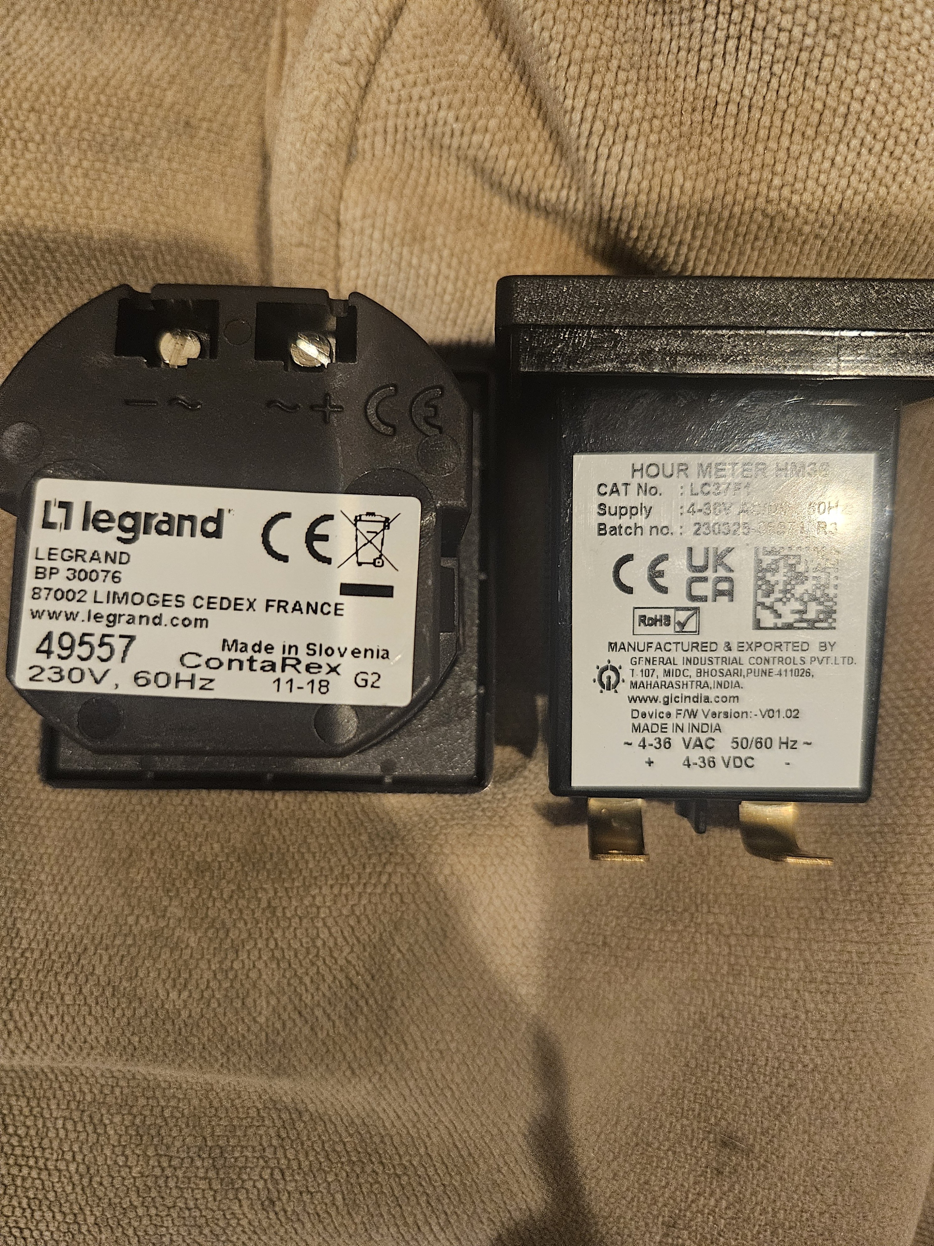

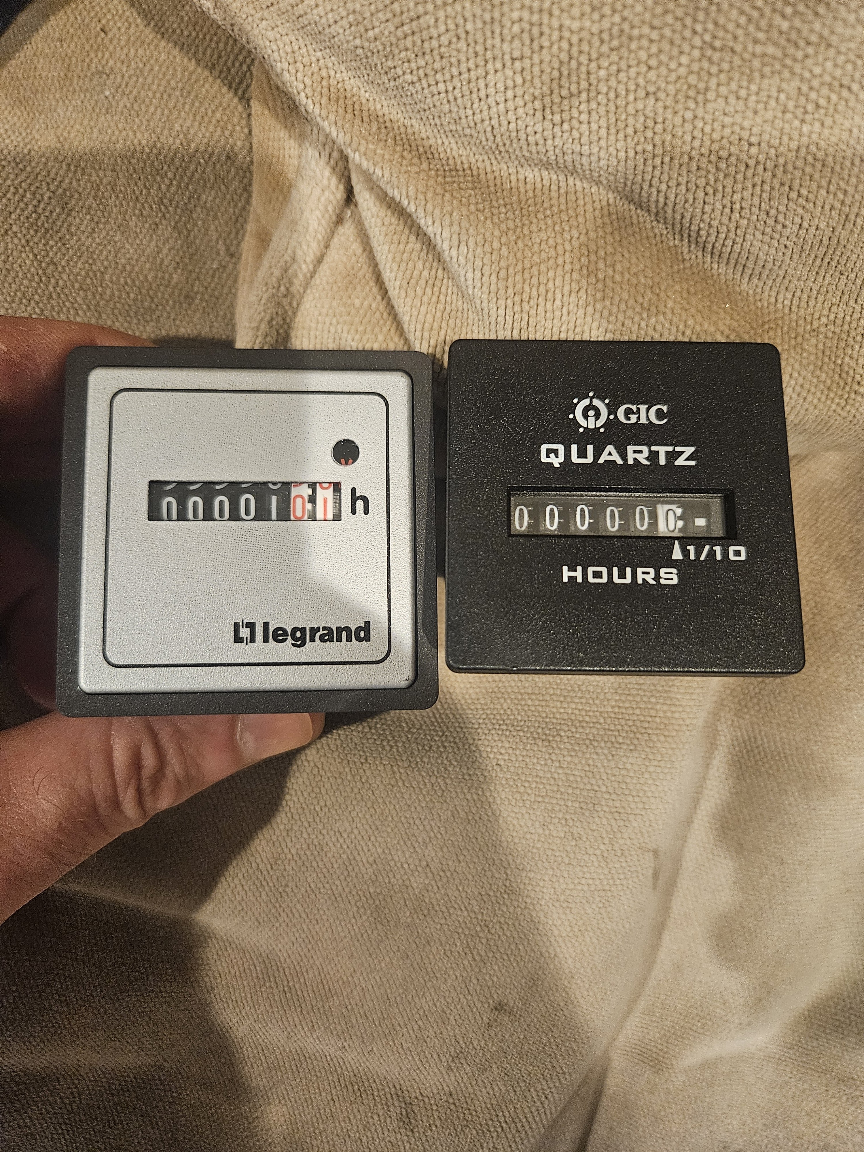

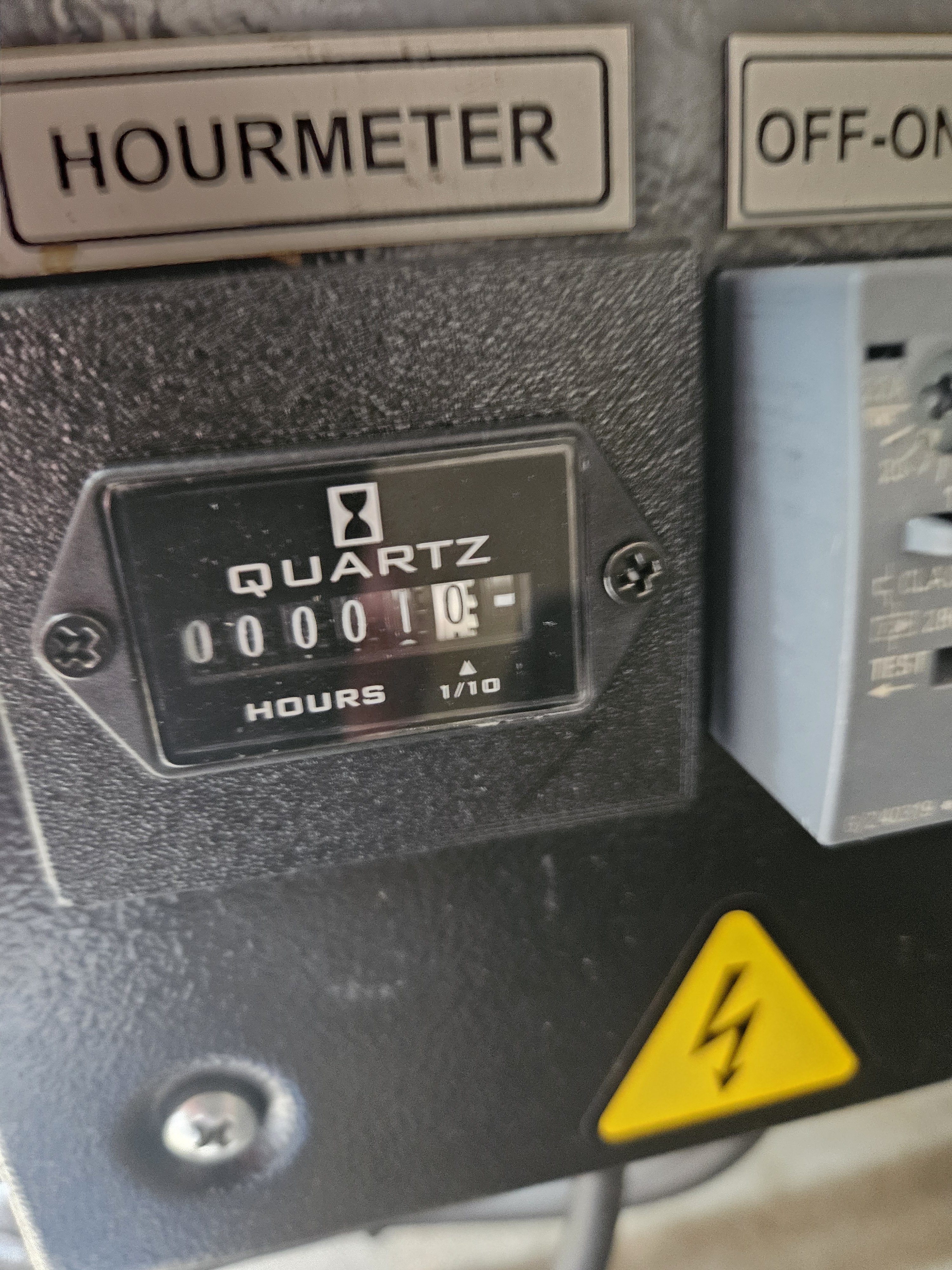

So my new Alkin w31 apparently had the wrong hour meter installed in it at the factory. They sent a new one that runs on 230 volts instead of the 34 volts the installed one was rated for.
The best part: the new one was used, a totally different brand, looks to be years old, was in an open box, and requires me to cut the spade terminals off the wiring inside the compressor to attatch this new meter that accepts bare wire connections.
I ordered a good meter from grainger. Don't expect Alkin to replace something they broke with original equipment. They wrote the replacement off as a warranty repair even though they screwed up.

The one with the spade connectors is the original meter that burned out, rated only to 36V.
The other is rated to 230V but I would have had to cut off the connectors to use it, and the face plate on the new one was too large. It came into contact with the HOUR METER raised label on the compressor and wouldn't sit flush.
Edit to add: if I had to guess, they put a gas engine meter in this electric unit on accident. I'm pretty sure the gas engine would generate a much lower voltage with some kind of a transformer or other electrical magic to make the meter work. :)

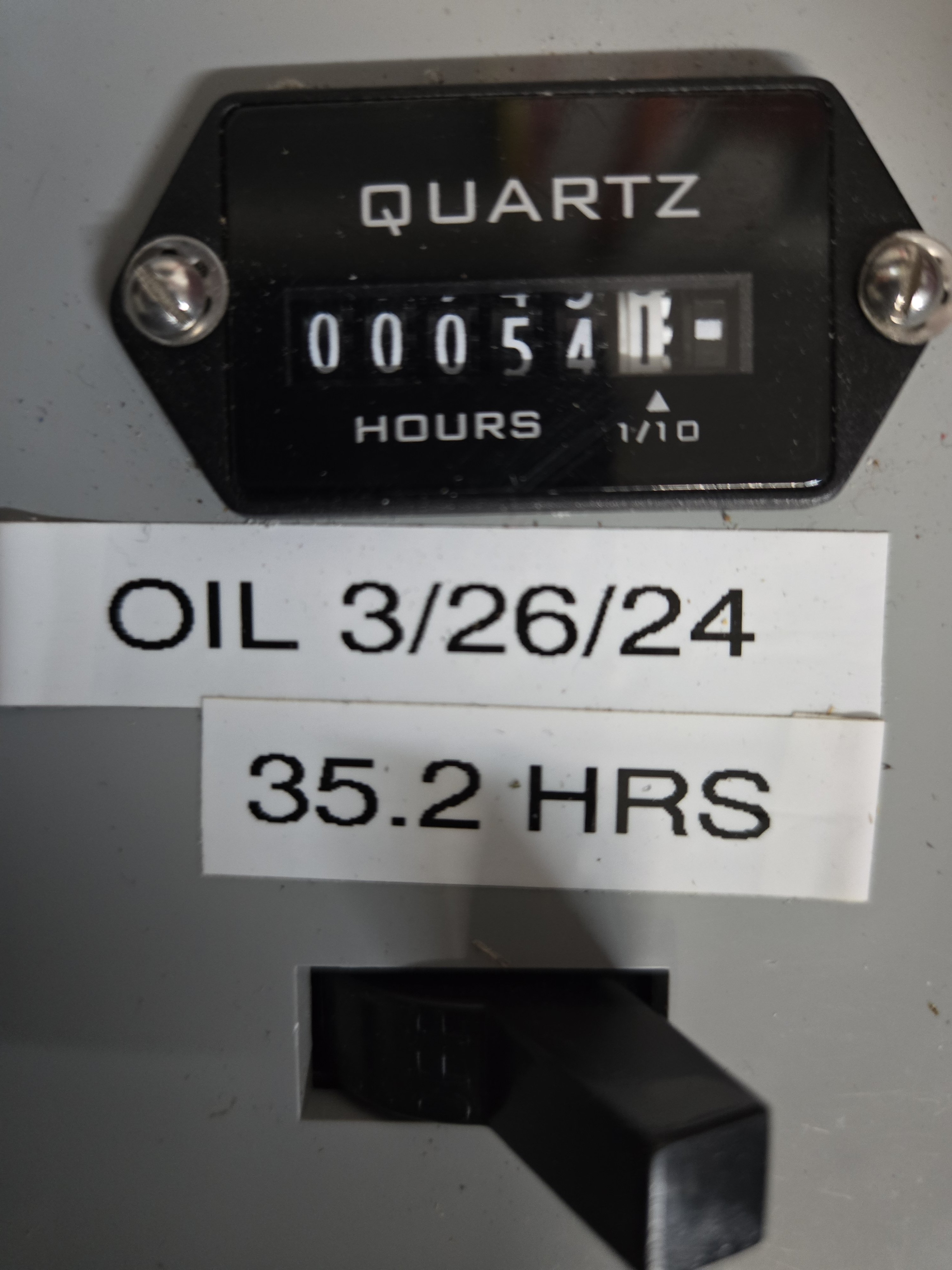

just hit 1 hour on the meter. This is the new meter I installed after the one that showed up with the new unit burned out.
Aside from the issue with the meter this thing has been great. My average top off time is like 4 minutes. It's way nicer waiting 4 minutes then the 12 it used to take my old compressor.
