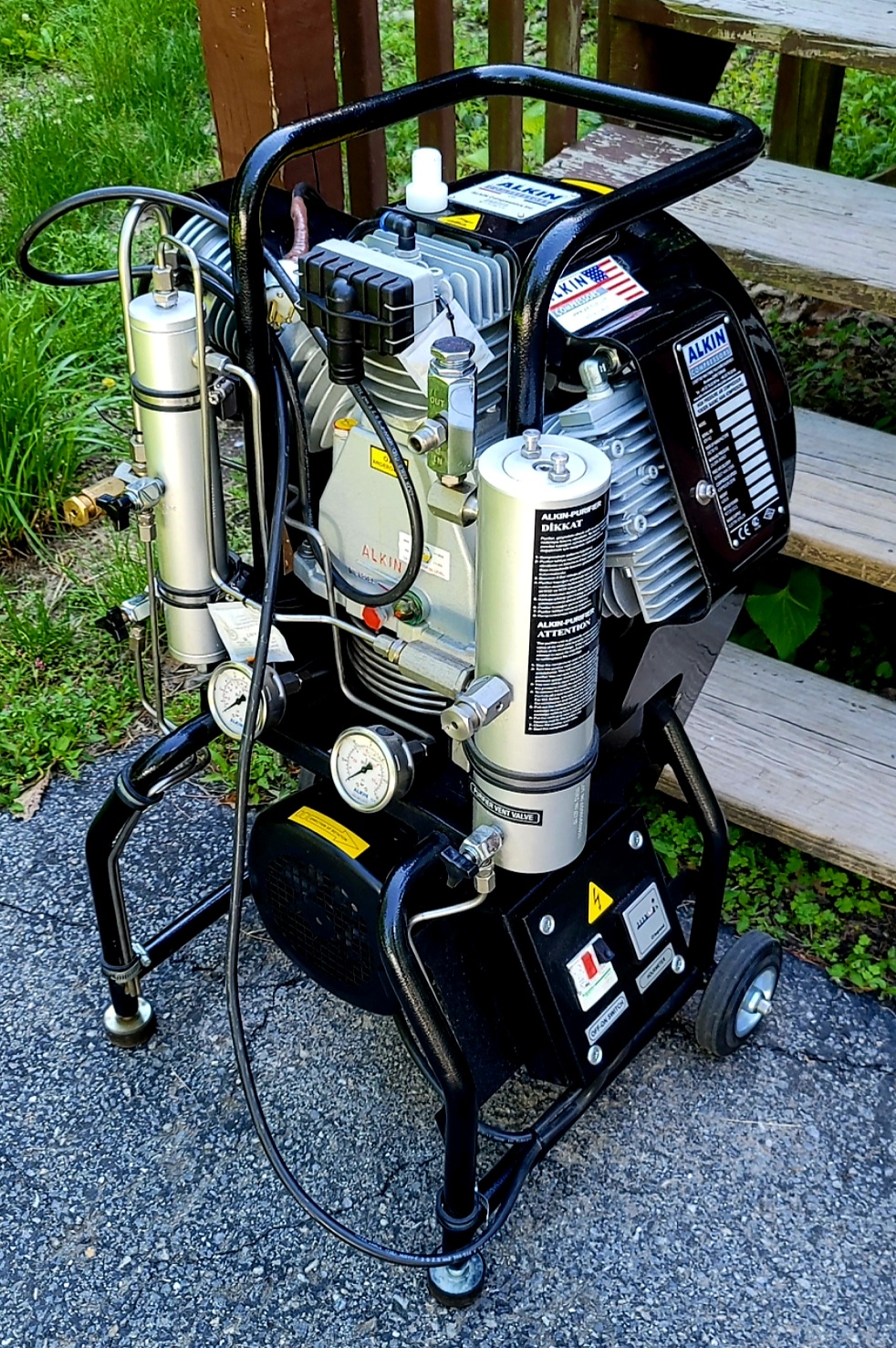

Here's my 220v manual model. Great machine. Still amazed how quickly it fills my tanks. Guppy from 0-4500 7 mins

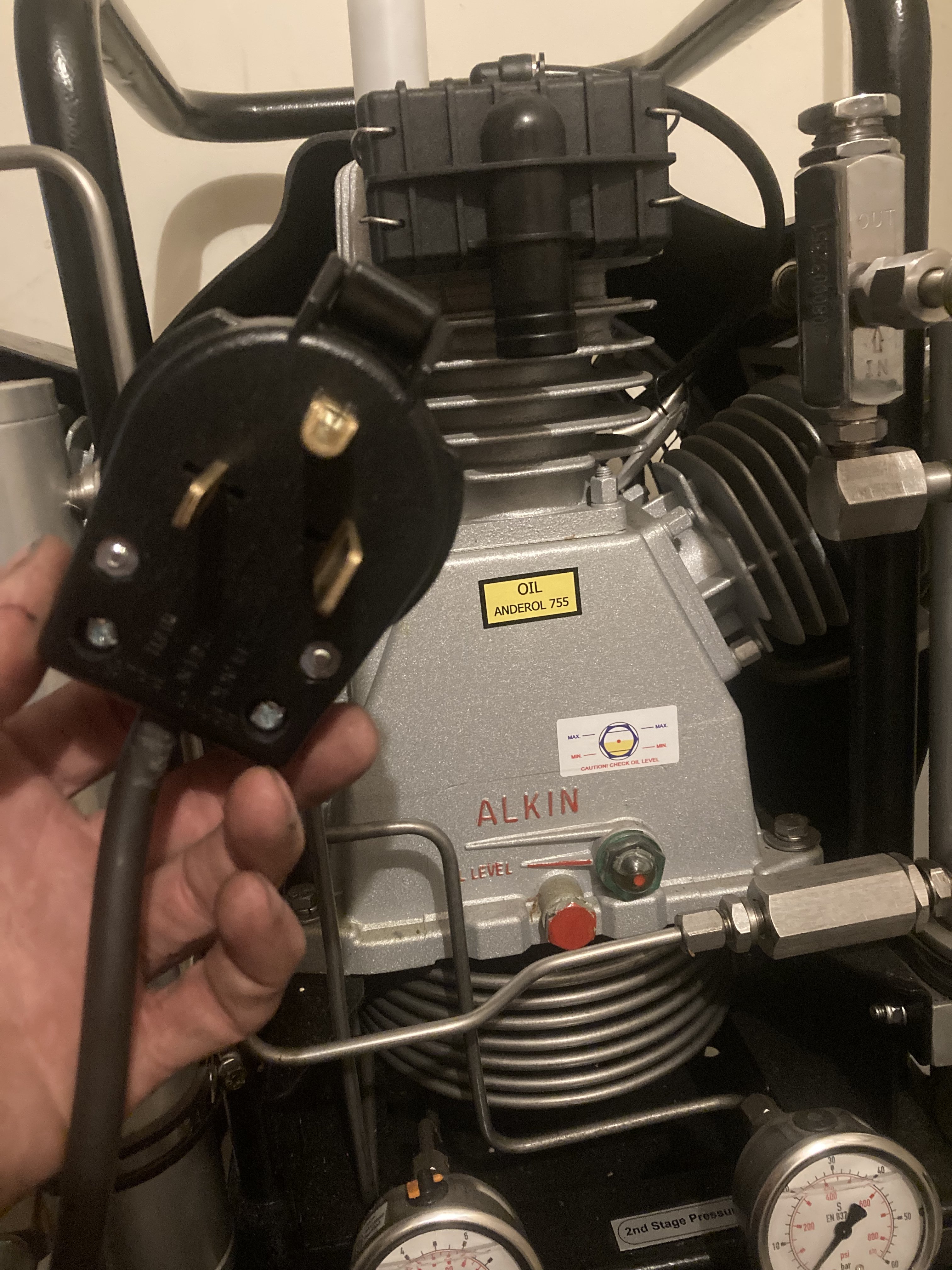

I did all my own wiring. Years ago when I built my garage I ran #8 wire from the sub panel to an empty four square box, planning for an air tool compressor one day. That never happened, so the space I had in the sub panel went towards the Alkin, and all I had to do was put it the correct wall plug. I then took a 25’ #12 cord, cut off the ends, and put on the correct plug terminals and matched that up to the compressors cord also.

I have had mine several months 6 hours on it. Mine is W31v on a 30amp 240v circuit I put in with 8/3 with ground rubber cord (SJOE) better for vibration. I can't find any info on the first oil change. I think I'll go ahead and change it out this weekend.
