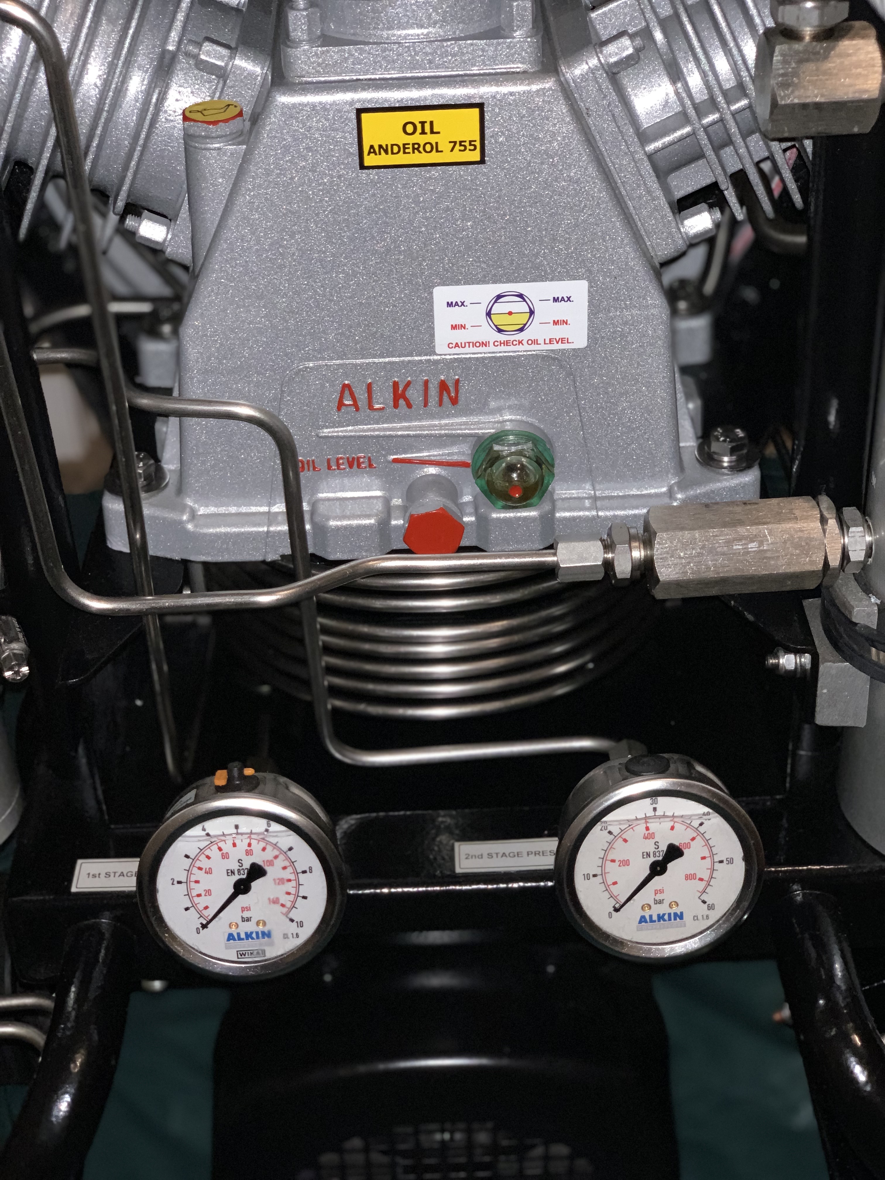

Quick question: I’d like to change my oil and the owner’s manual suggests letting the compressor run for 5 minutes to warm up the oil before changing. Does this mean to just switch on the compressor and allow it to run without closing any of the valves and allowing pressure to build up?
This configuration in the verticle model ought to make changing the oil fun. Gotta keep it out of the areas below.

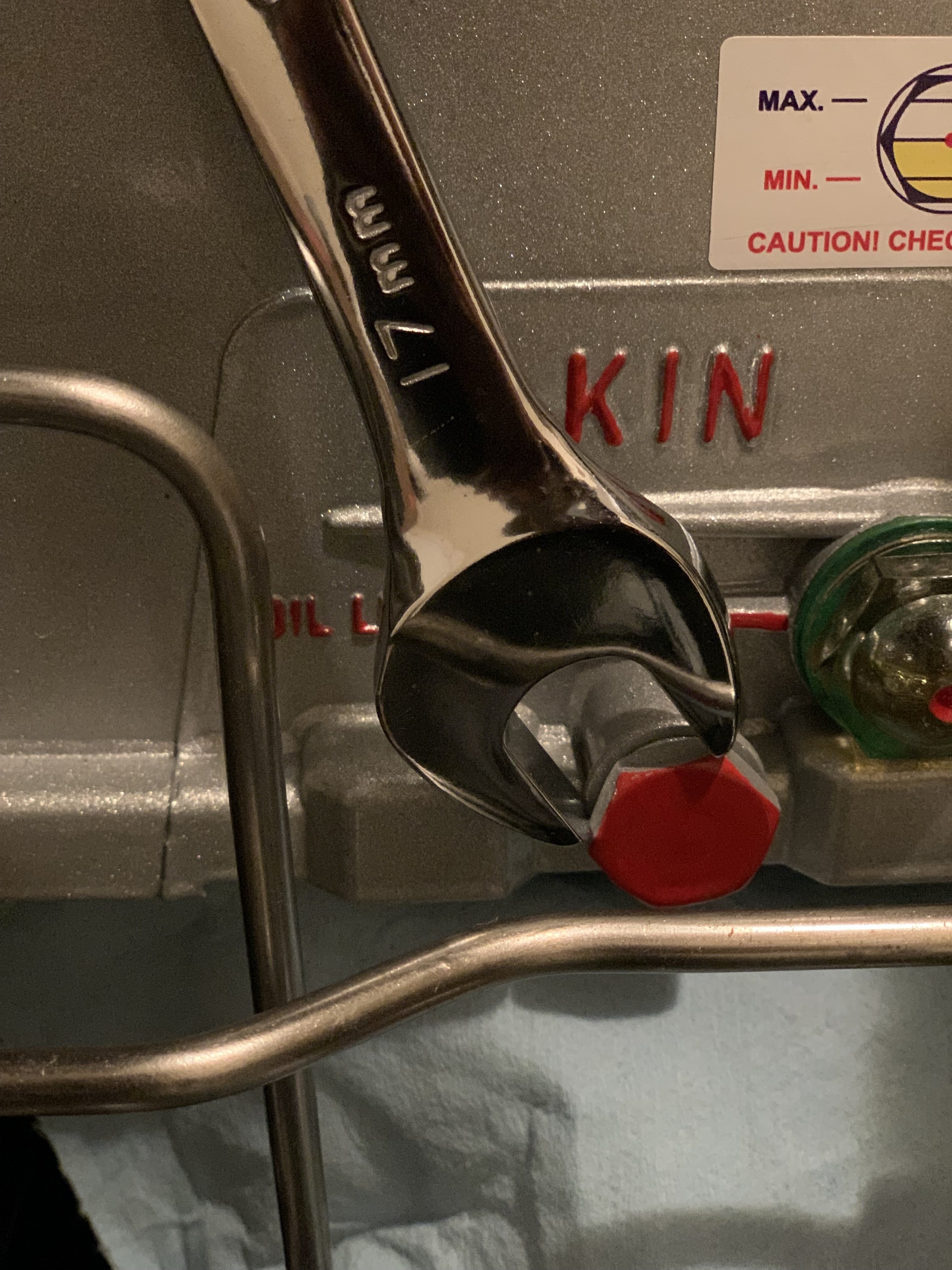

The manual says to use “a no. 17 wrench” to loosen the fill bolt and the drain plug.
What is a no. 17 wrench? I can tell you what it isn’t. It can’t mean a 17mm wrench.
I’m stumped.
Nor does it appear to be a 19mm wrench
I’m stumped.

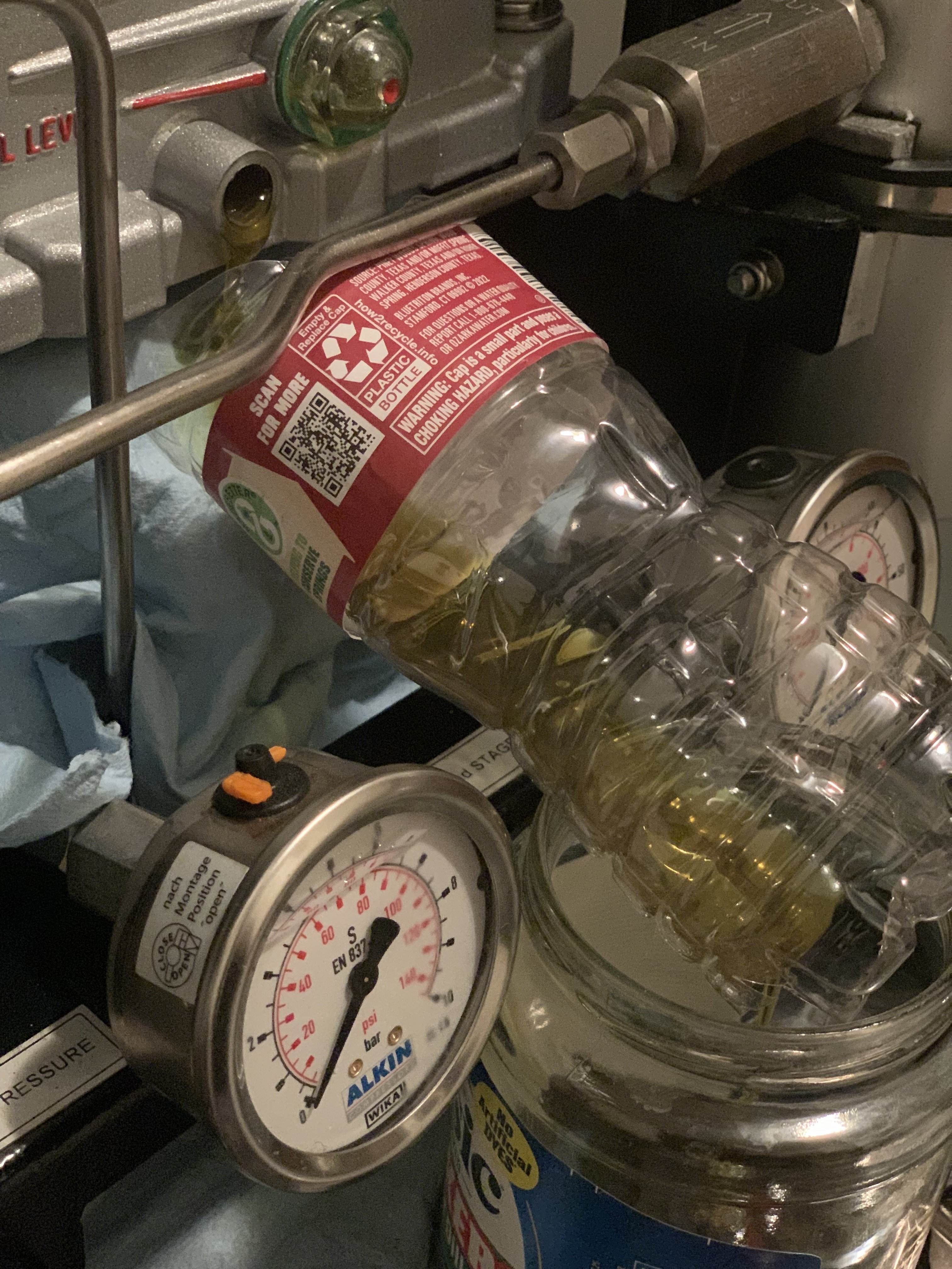

Not to be a wise guy, did you try 18 mm? I can’t recall what wrench I used, perhaps SAE? Check my last post in the other Alkin thread for a spill free oil change.
