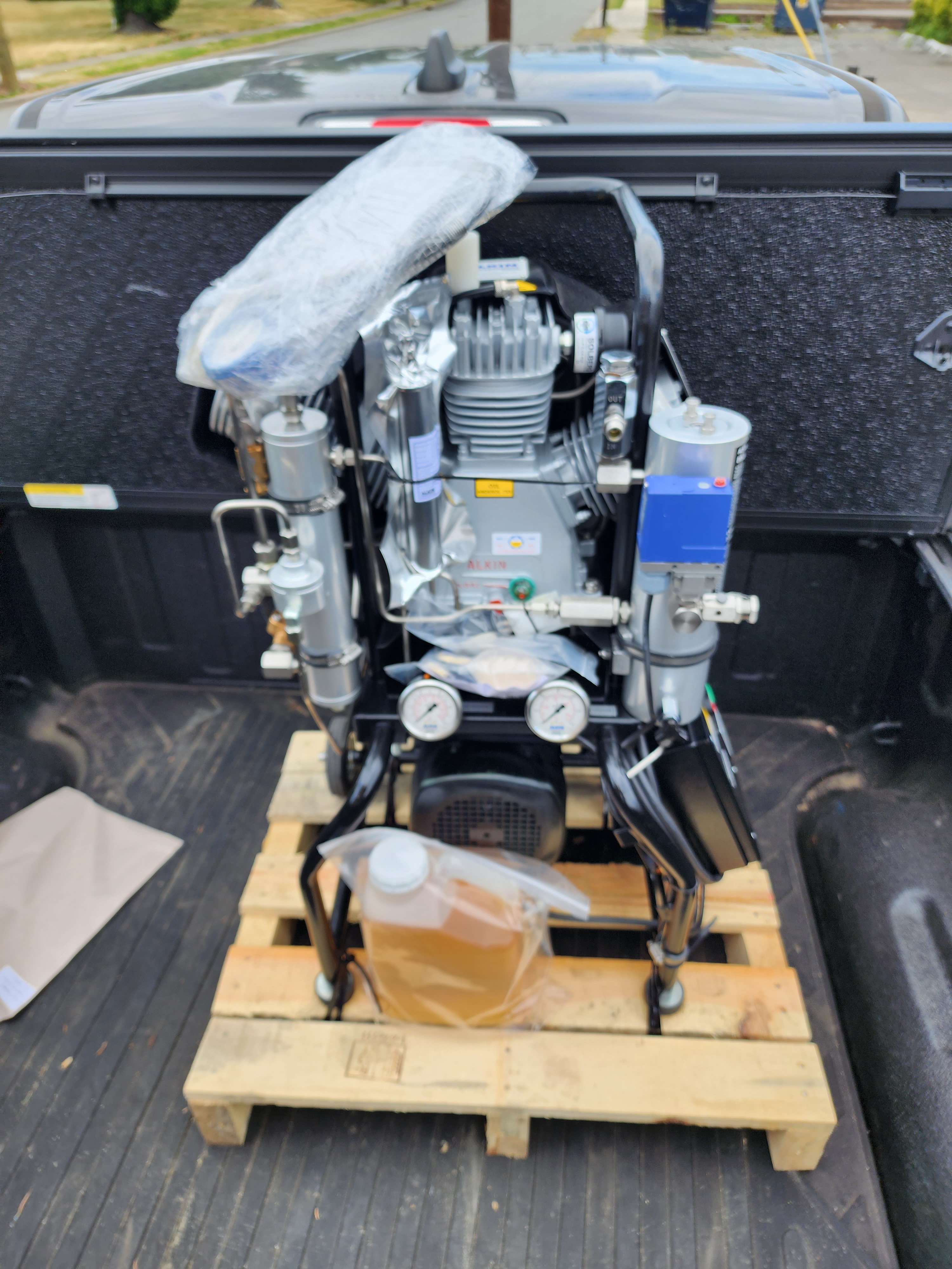

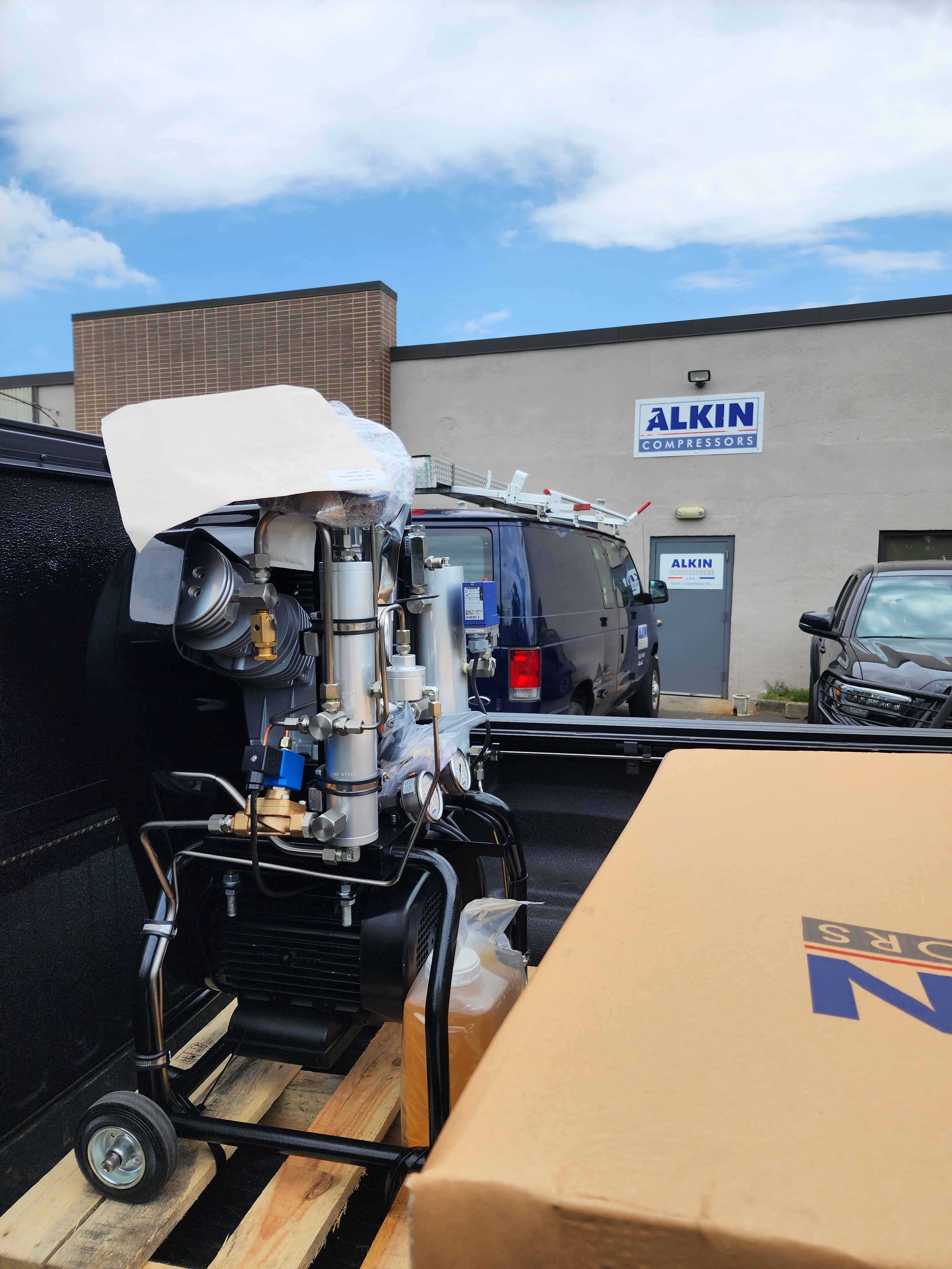

Took the plunge today and decided to get the w31 vertical. They are a little over an hour away so it was worth the trip and saved some shipping. No clue how it works as they had a worker be there so I could pick up on off hours so time to do alot of reading and watch some videos.
Congrats on your purchase. And don't worry, they are very easy to operate. However, read the manual and ask us here on the forum if you need any help. As you know, you are dealing with very high pressure. Better to be safe than sorry. Again congrats and I feel sorry for your wallet 'cuz you are going to buying a lot of pellets and slugs. :)
Oh I have the ammo and the pcps just finally had enough of the heng.
Took the plunge today and decided to get the w31 vertical. They are a little over an hour away so it was worth the trip and saved some shipping. No clue how it works as they had a worker be there so I could pick up on off hours so time to do alot of reading and watch some videos.View attachment 363502View attachment 363503
Congrats! Your gonna have some nice clean air on tap!
Congrats, that part of your life just got much easier and more secure!
