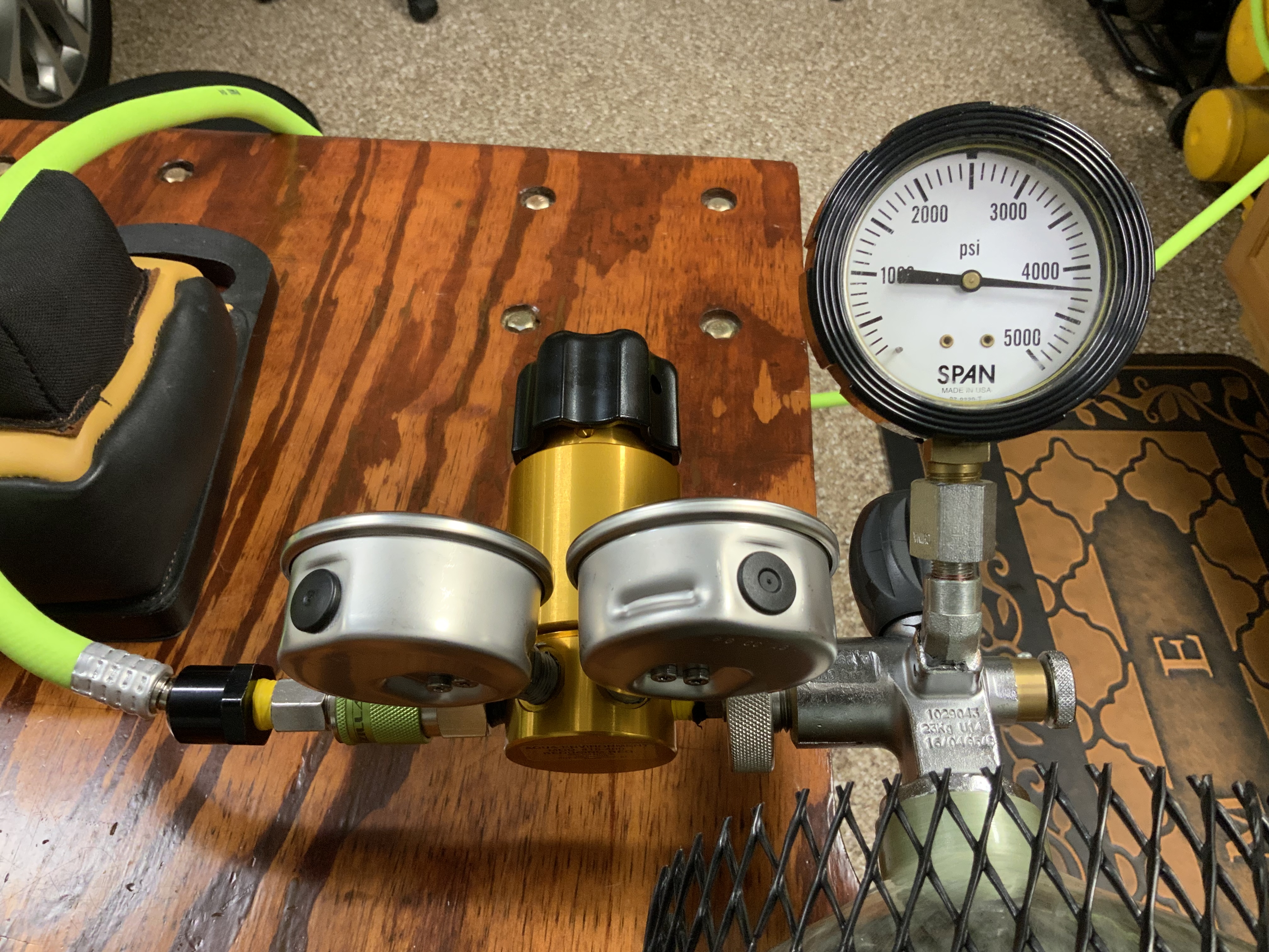

So now I have a spare SCBA tank that I could sell - or I could hobble together a few parts and have always available, clean, regulated air for workbench and portable tool needs.
Works like a champ.
The regulator is $275. All connections are female 1/4 NPT, so you can use any gauges you want, I picked a couple Wikas. To connect to your tank (my tank above is DIN) you need either DIN to 1/4 NPT male or CGA to 1/4 NPT male (if your tank valve is CGA).
I ended up getting the parts from August Industries. I shopped on-line and surprisingly they are 20 minutes from me. (Nice people and everything in stock.)
Yes, it’s a bit overkill since I also have a shop compressor; but I don’t leave it filled because it rusts the tank. It’s just nice to have always available clean, dry, regulated air available at the bench. Plus, it’ll be nice for small portable jobs with precisely regulated air that meets any tool pressure requirement.
(And it’s just damn cool - though my wife gave me the typical “you’re kidding, right?” look when I told her we don’t need those little Costco compressed air cans anymore.)
