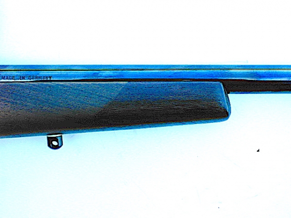

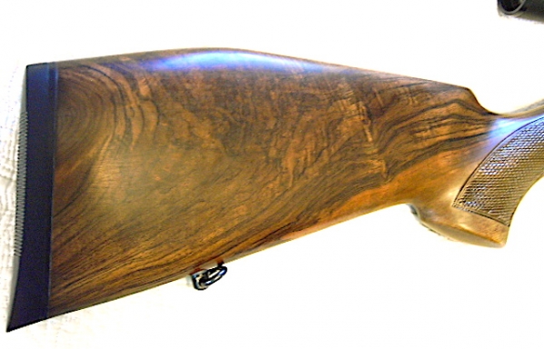

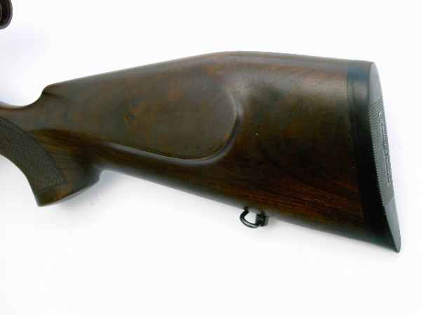

The FX Royale "Sweetheart." I actually ended up with 2 grade 2 stocks for it. I left one with a satin finish and brought the other one up to a more glossy finish.
The satin one looks a bit muted but, I think it's "just right" when you see it in person.

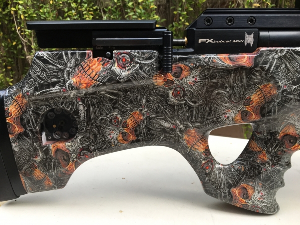

It breaks my heart to see someone cover up a nice wood stock with hydro dip.
1f628.svg
It is sad, but true, few pcp's come with decent looking wood. In fact, it's down right rare to find much "grain" showing on any airgun!

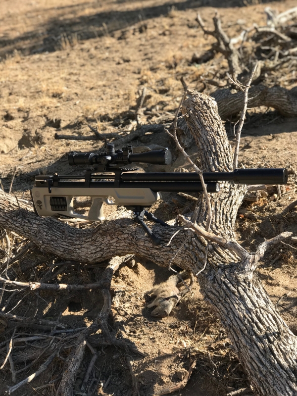

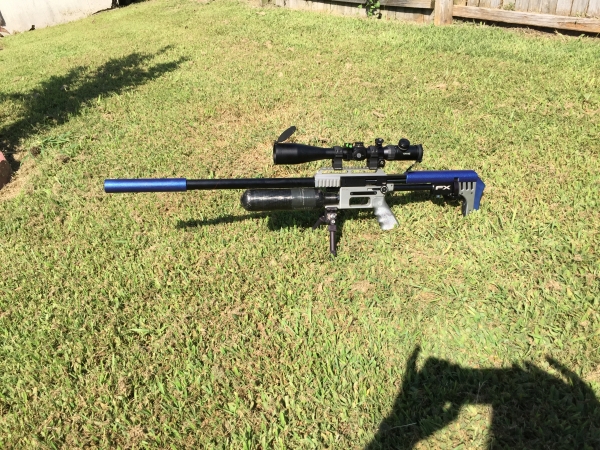

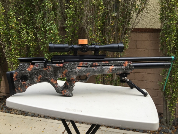

Been working on this one for a while. Here's my FX "Impact Droid" all dressed up.
Airgun = FX Impact X
Scope = SWFA 3-15x42 SS ffp
Bi-pod = Accu-Tac FC-5
Easy access fill port trigger guard + long rail & adjustable shoulder stock = Kraford & Lypt
High capacity magazine = Side-Shot Scope Cam
Grip = Magpul Industries
Custom coating = KG Industries Gun-Kote & Warlock Custom pigments
